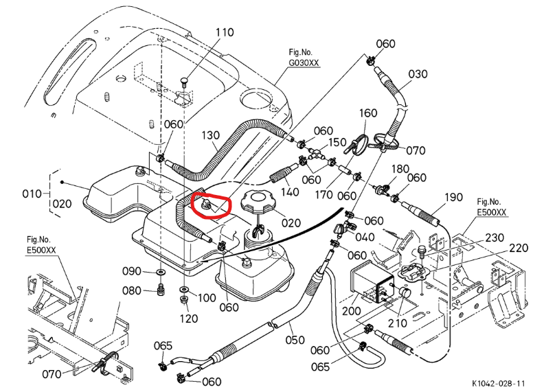

Was chasing a fuel issue on the T2380, and found a bunch of gunk in the pickup tube out of the tank and the right angle fitting at the top. Its pretty clear Im not the first person to chase this down, and the grommet that was at the top of the tank was getting a little rough.
I wanted to try and replace it, but I dont see the grommet or the fitting on the parts listing. I have circled what I am looking for in red below. Any idea if this is a part I can order?
33,057
8,479
Kubota does not sell the fitting or the grommet separately, thus there are no part numbers for those parts.

That grommet is not serviced separately by Kubota, but it is the same grommet used by Scag, Toro, Exmark mowers, and several others. Take the grommet to a mower dealer; they can hook you up.
Large mowers use the grommet in both their fuel & hydraulic oil tanks.

Thank you both for the response! That seems odd to not have it available. I guess they would just try to sell you a whole tank assembly....

Clutch, I have a T2380 as well. The fuel tank fitting is attached to the fuel pickup line (as one part). Were you able to find another fitting (withe the pickup line attached)?
I found this, but not confirmed it fits yet. Looks like the right thing.
I need to pull the bushing out and measure it to see if it's right, but there is a link to it on that same page.
eBay also has some listings that are off-brand that look like they would work. And come with a screen for the bottom of the pickup tube.

makes me wonder if if's the same grommet that fits the ZG Kommander mowers. You can get the whole pickup tube assembly with a filter on the end of it for like $20-some dollars. Is it the right length? I can't answer that question.
