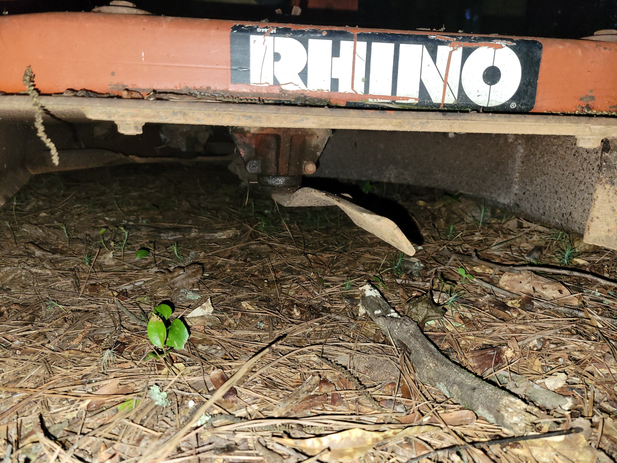

Torinodan Active member Equipment T1600, G4200, G5200, Ford 2810, 1974 Wheel Horse C100 Oct 14, 2021 199 94 28 Fayetteville GA May 14, 2023 #2 Blades are right side up correct? Not upside down? Seen it lots of times. Last edited: May 14, 2023

Torinodan Active member Equipment T1600, G4200, G5200, Ford 2810, 1974 Wheel Horse C100 Oct 14, 2021 199 94 28 Fayetteville GA May 19, 2023 #5 Like I said, seen it too many times. The blades are upside down on this finish mower I just picked up. Easy to get wrong if your in a hurry.
