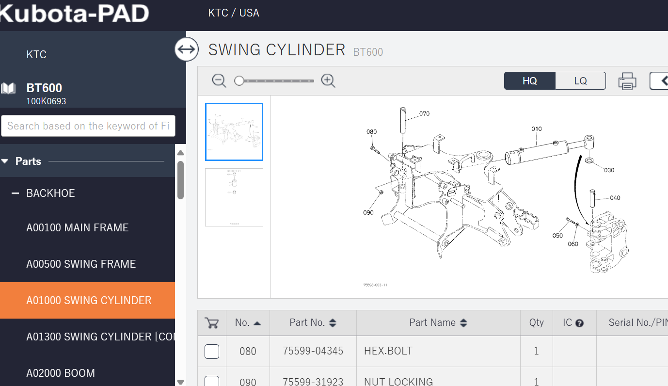

I have an old BX22 with a BT600 backhoe on it. The swing cylinder is leaking and I want to remove it to get it rebuilt. I had no problem removing the pin from the rod end. However I am having no success removing the pin on the other end of the cylinder. I have removed the only bolt I can find. I have tried driving it down using a drift and 4lb hammer. It doesn't move. I have place a bottle jack underneath and tried to push the pin up. No luck.
10,165
7,029
Looks to be just that one bolt holding the pin on that end too.
Maybe a good soak with penetrating oil, including a good dose into the hole where the bolt was?

I had a similar problem once and #3 from your list was my needed solution.
10,165
7,029
Sometimes an air hammer does wonders. Good thought by @Jinx
Give it a couple/few days with penetrating oil first.
Given the size/mass of the swing assembly, I wouldn't use heat right away.
