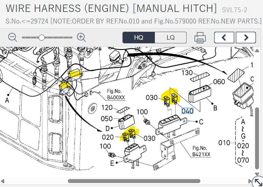

Had to replace battery on my SVL75-2 skid steer. With the new battery, it caused the alternator belt to shred. Had to replace the alternator belt. While replacing the belt, had to loosen the alternator tensioner bolt. Loosened it too much until the alternator touched the engine block causing it to spark. Once everything was tightened back up, there is no power to the controls or lights on the control panel. I'm assuming that there is a blown fuse. Can anyone tell me which fuse I should look for? Tried looking at a few fuses but got too dark to see all of them. Going back in the daylight to look again. Any advice?
