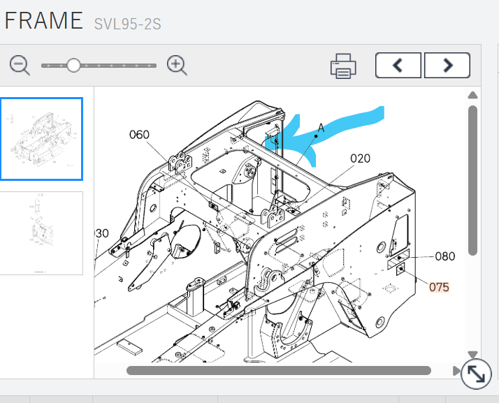

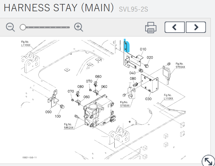

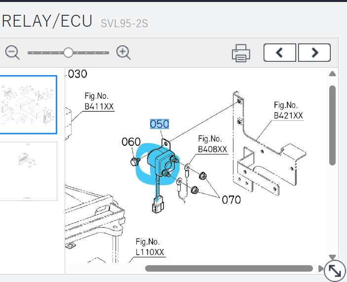

Getting an error message that states the Grid Heater is not working. Not sure if the actual heater has failed or the relay that controls the heater is bad.
Wondering if somebody could tell me where the relay is physically located in the SVL 95?
Thanks in advance,
Bob
33,916
9,137
The WSM would be your friend in this case, it will point to all the components and what proper voltages / signals should be present, and how to test them without doing damage to the ecu or any other parts.
Back40Ranch
KX 71-3, SVL 95-2s
Oct 3, 2025
Edwards, CO
you are awesome - thanks so much. I have the shop manual but couldn't find anything in the index on grid heater, intake heater etc.
