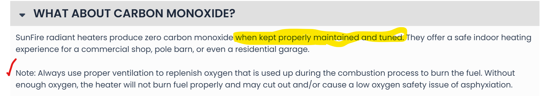

You MUST have a fresh air supply or you will take all the air out of the garage in short order.
And also back up the space with a carbon monoxide detector.
According to the website, they have near zero carbon monoxide output.
