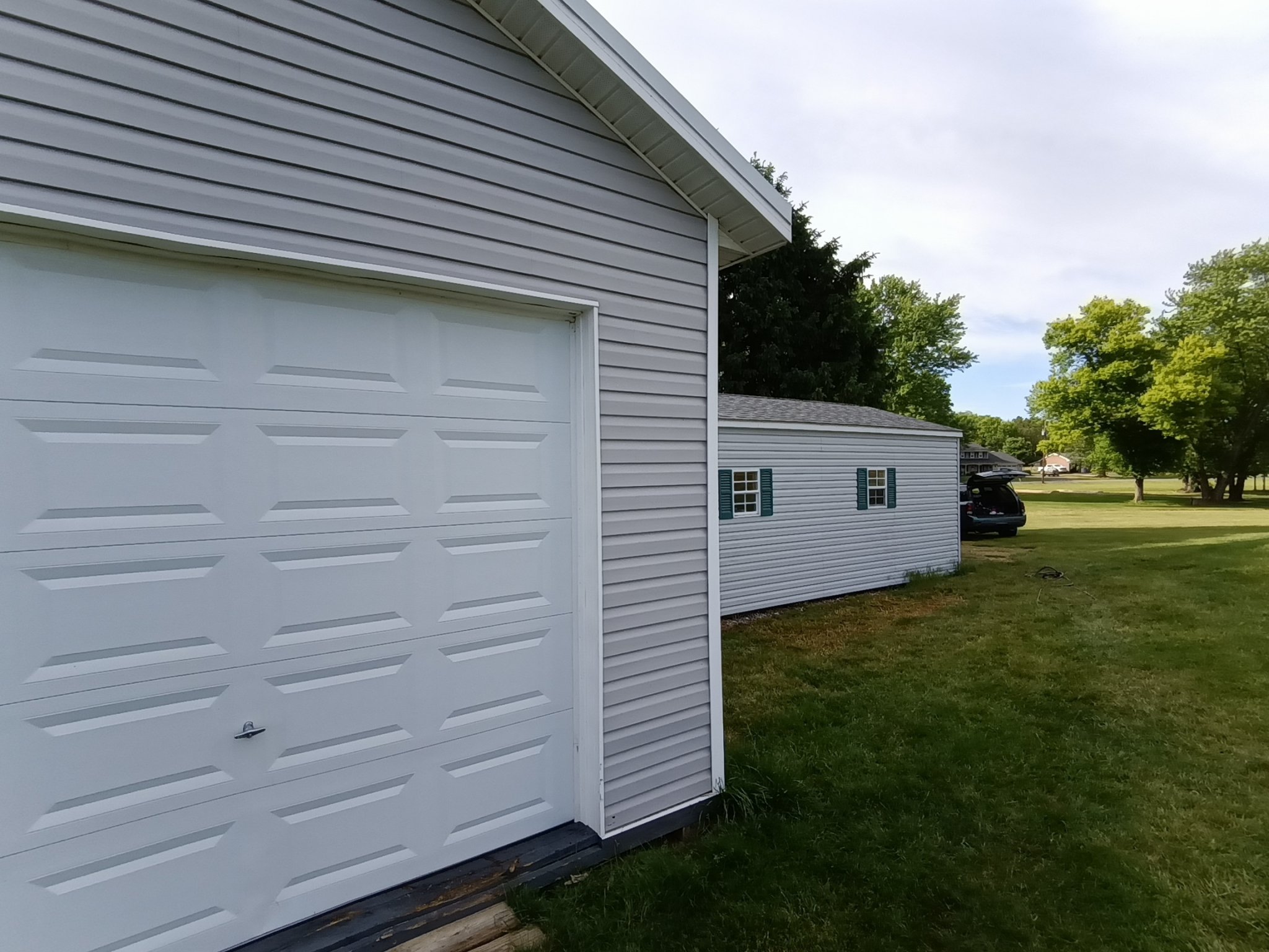

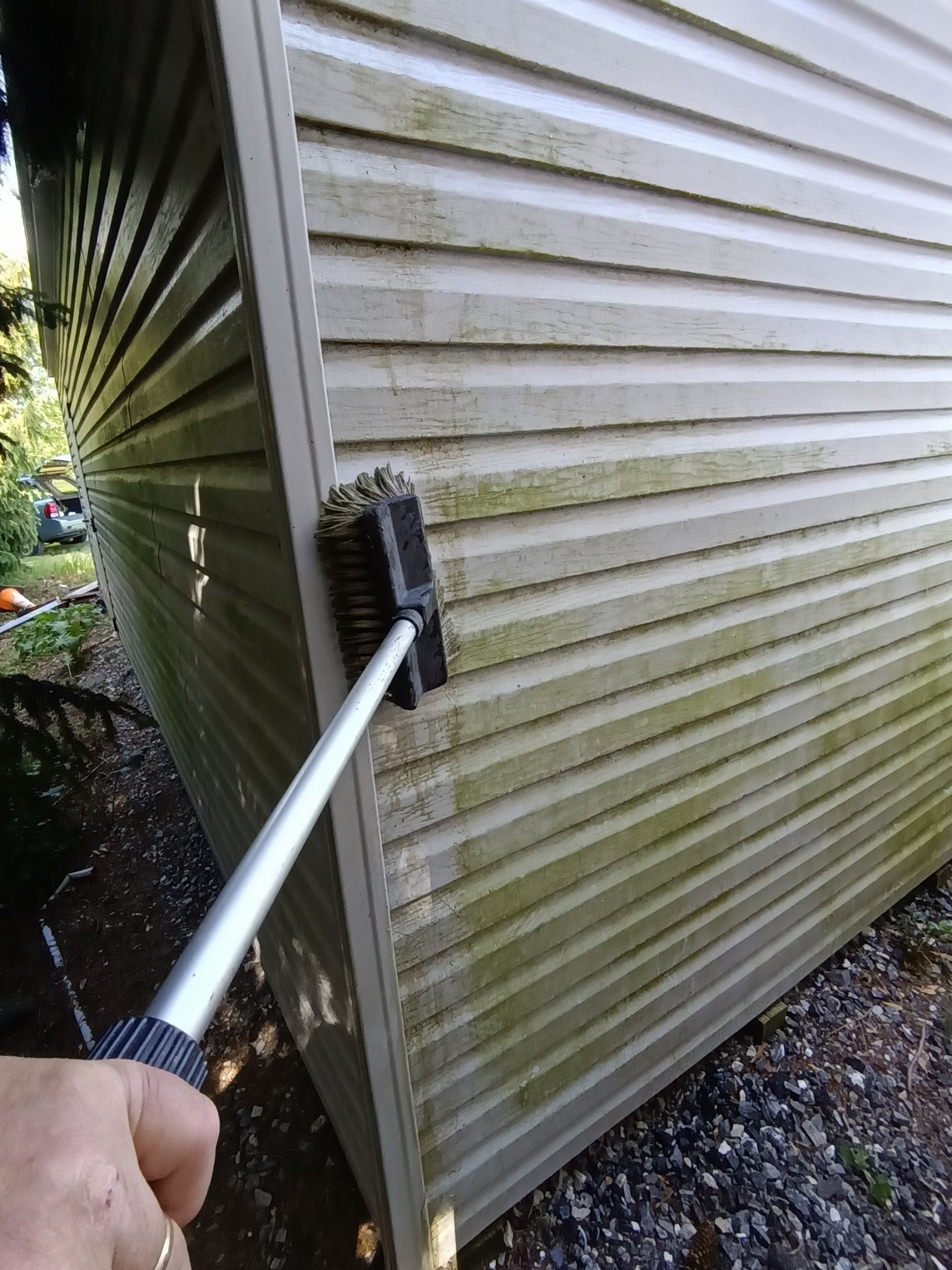

We have two sheds that needed cleaned for at least two years. Lots of more important things kept pushing them farther down the list. I ended up with a couple gallons of ZEP Deck and Fence Concentrate that nobody wanted, and figured I'd try it out. There were mix instructions that I almost followed, but used 10 ounces of concentrate to a gallon of water in a garden sprayer.
There were two different types of unpleasantness on the sheds. One was that green algae-looking stuff and the other was like black mold. The process was to wet the surfaces in segments I could work on without having them dry. First sprayed them liberally, then after a minute or two brush with the soft scrub brush on a pole. Rinse and move on.
Years ago I used a detergent called Soilax, but haven't seen that for years. Recently I've been using Purple Power and it works well, but it doesn't clean aluminum trim like the ZEP did.

Even though the Honda-powered washer could probably blow holes in the vinyl, it doesn't work as well as elbow grease. I've used the power washer as recently as last week on the concrete walks, brick walls and the bridge. It does really well on them and does OK with the green deposits on siding, but not so much the black stuff on the aluminum.

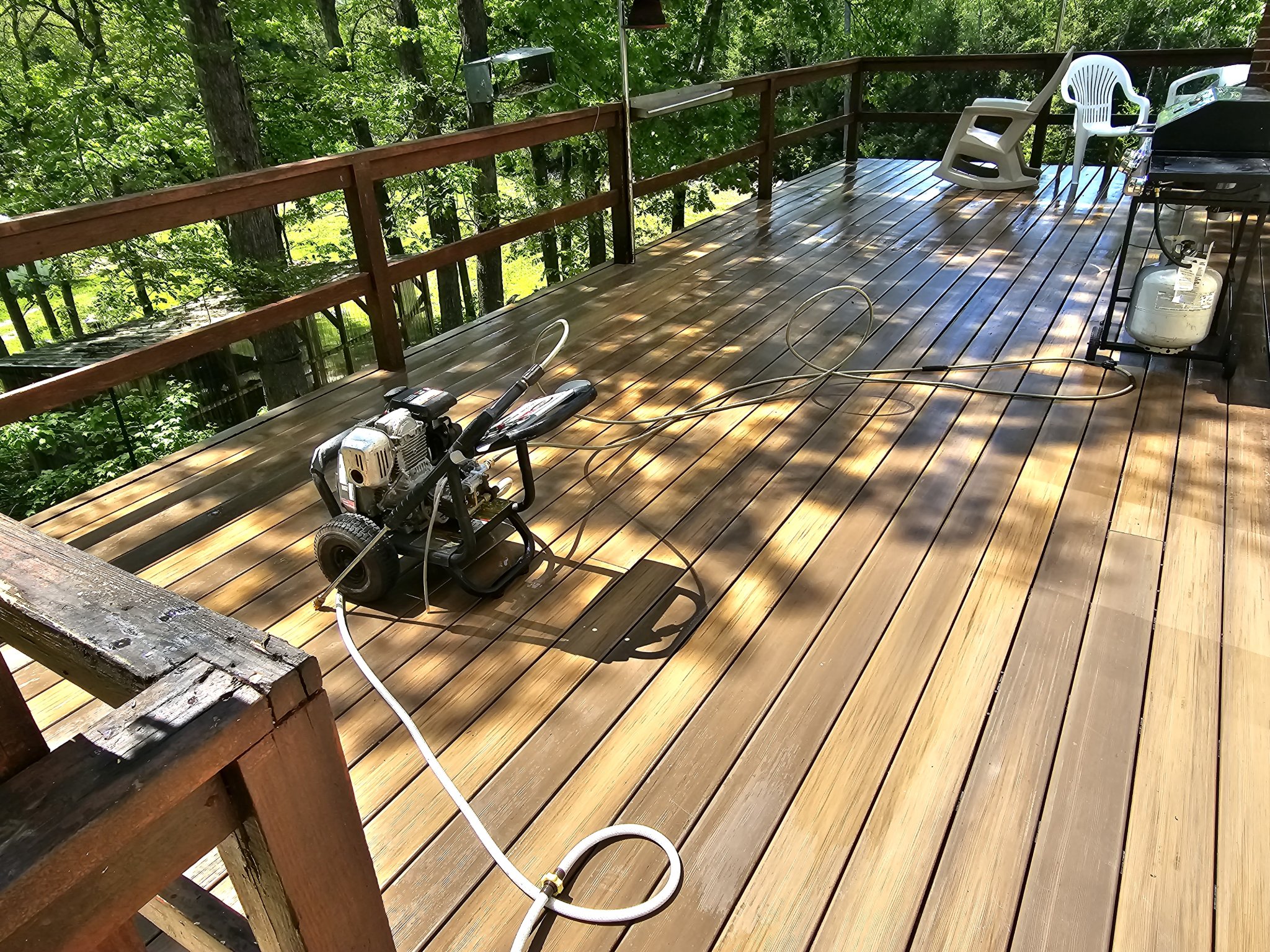

Then today I used the presser washer on the cement block north wall of my shop. Green moss up about a foot from the asphalt on that side and some vegetation growing up between the cement and asphalt. Dandelion in a few spots. The presser washer cut theses right off and took all that moss off the cement.
My end deck on the house that the bears like is plastic wood. Took the presser washer and went after that also. Owning property there is always something that needs to be done. Hanging flat feeder is one i made and has quite a few .22 holes for squrriels. The long stainless one was a rain gutter i had made but took down last year.
