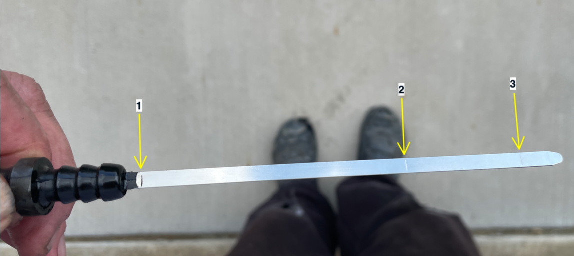

I have a 1997 L2350F. The user manual says that the oil level should be at the top mark on the dipstick. My dipstick has 3 marks, one at the very top, one in the middle, and one lower down (attaching a jpg). Is mark #1 or Mark #2 the correct "full" mark?
TIA

Mark 2 is the correct full level. Oil should never be above mark 2 or below mark 3.
If you fill it to mark 1 you will have some big problems!

Mark #2 is full
Mark #3 is low
Mark #1 you'll fine out why they put the FU in FUN!

Agree, not a stupid question at all if you don't know the answer. Better than not asking and being stupid and filling it to mark 1 ;)
