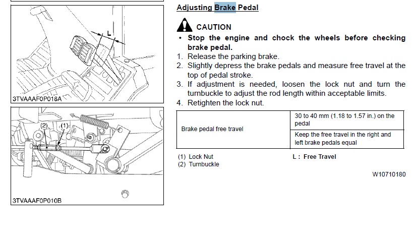

See adjusting procedure from WSM
Note there is one lock nut and then the turnbuckle which does the actual adjusting.
Dave
Thanks to both GreensvilleJay and Dave_eng. I didn't see the posted diagram until just now. I did finally find a diagram online. Both confirmed that the brake rod assembly includes the turnbuckle and only one lock nut. This helps a lot. Now I can focus on loosening the turnbuckle itself. Thank you both for the prompt response. Very helpful.
