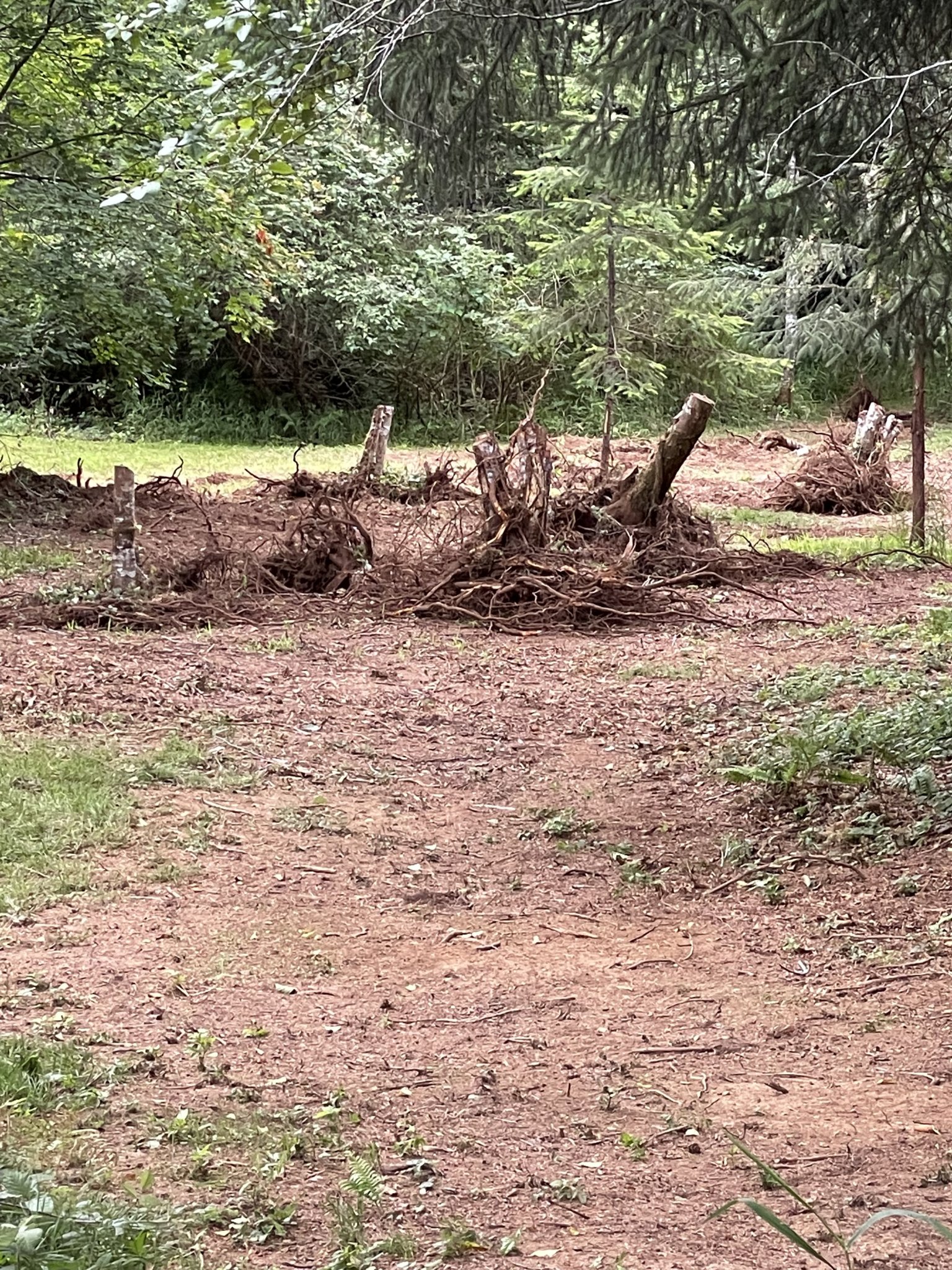

I have an L3301, and purchased the Titan Attachments one for about $325 shipped. Has paid for itself several times in the 2 yrs of owning it.
A bit of experimenting with technique is needed to prevent tearing up bucket or tractor. On large stumps, I dig several feet around to break the roots. The ripper teeth do this very well. Having stump a couple feet tall above ground helps when you get to point of being able to push/rock it. Once I get the 1/2-3/4" of play, it's all down hill....just keep searching out the roots by looking at the moving dirt, then attack with the teeth. Different species of trees have different root types (shallow, deep, thin, thick, etc.). I just take it slow and enjoy the challenge.
Some recent tropies....
