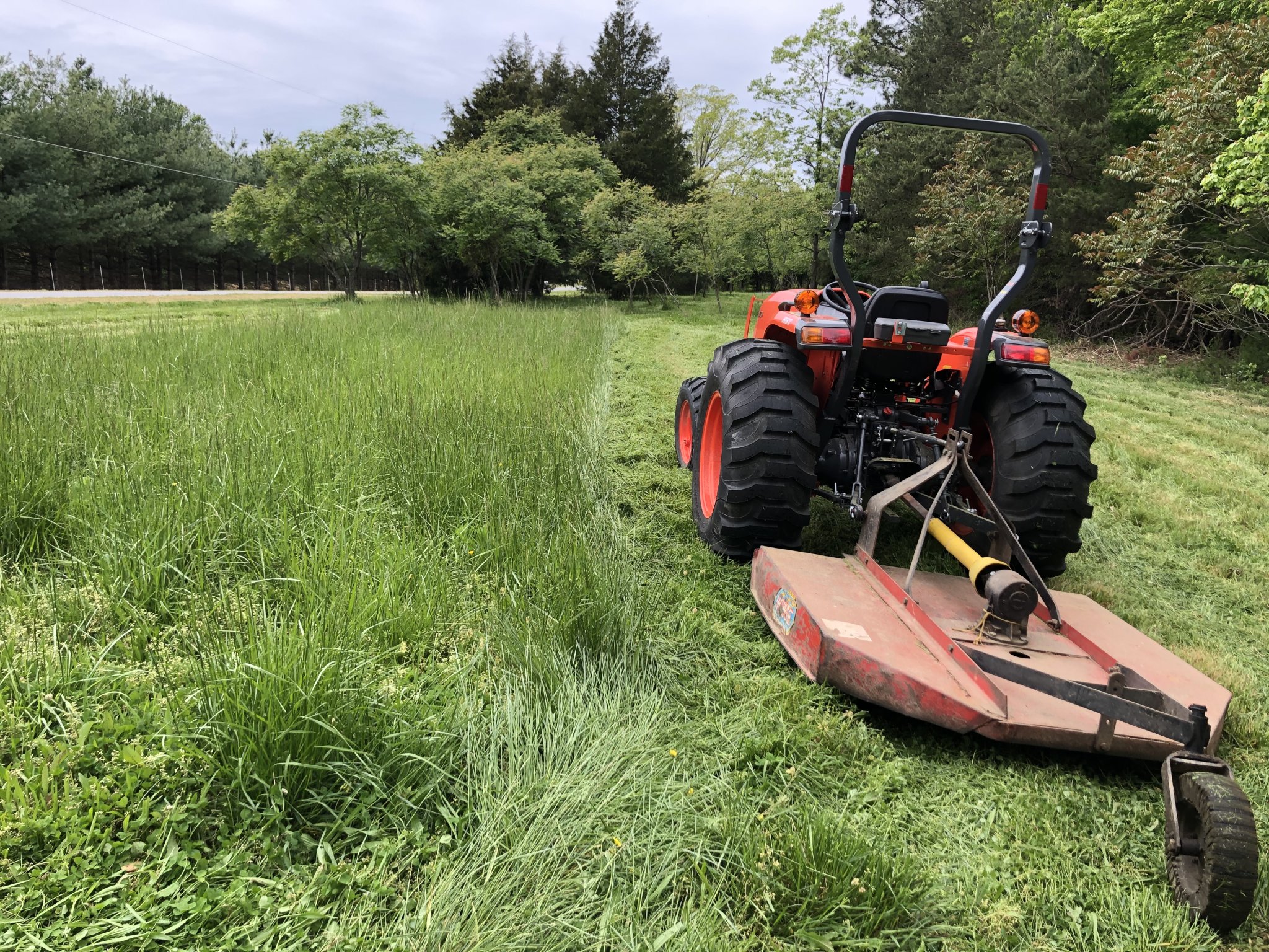

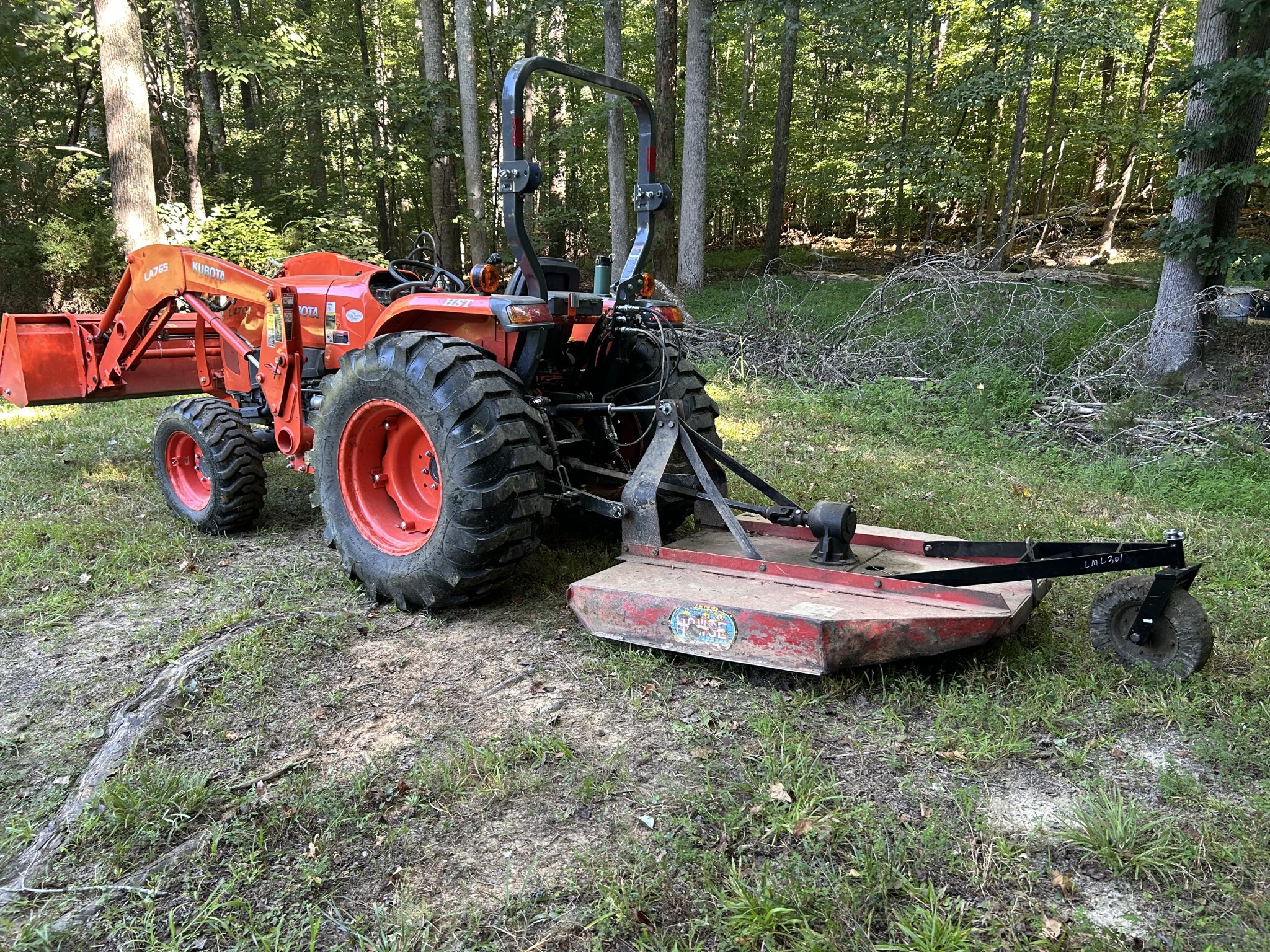

This is what it looked like the first time I needed it after I was granted permission to touch it. April 2020. Dad was in inpatient rehab needing a knee replacement. Before taking it out, asked him if it needed anything or was it ready to go. He said it should be good to go so I hooked up and started mowing. If you look at the picture closely you might notice a few things. If you zoom in on the socket for the tail wheel spindle, it’s kind of egg shaped and there’s enough free play between the socket and shaft you can stick your little finger in there if your not concerned about getting it pinched off. Not much way to adequately grease that, but it still works so no worries. The toplink isn’t connected to the mower. The pin rattled out somewhere. Still haven’t found it but I had spares so no big deal. The big deal is the extreme vibration. PTO guard…I’m a fan of PTO guards. All my other implements have them and they’ll be replaced if damaged. This thing, if the PTO is on, you’re in mortal danger well before making it to the PTO shaft.
I stop, take this picture, figure Dad has nothing better to do on a Saturday when PT gives him a break, and call him to see if he knows what’s up with this bush hog that was allegedly ready to go. Tell him swagging the true RPM’s a bit, at 350 or so it’s a little concerning. More like 450, I’m starting to think maybe it has one broken blade. At 540 it just comes to pieces. If I was on the 9N I’d be concerned it would rattle it over on its side in a flat field. He said he didn’t know. He hadn’t run it in probably 10 years or more. Asked if I was running at 540 in heavy grass. Told him I was. He said there’s no history on it being run at 540 in heavy grass. Every other tractor it had ever been on, as soon as it hit grass, it slowed to well under 540. Asked when gear box oil last checked: never. Blades checked: never. Neighbor was the only one who ever ran it and that was maybe an hour and a half a year. About all he knew was neighbor never complained about anything other than needing 2 or 3 shear bolts every time he used it.
Great… Back to the shop. Blades were dull. Not factory profile but won’t slice paper dull; dull like someone had been mowing rip rap with it. One blade was swinging free like it should. The other was bound up tight to the stump jumper by the 30 yards or so of baling wire wrapped up in the stump jumper. Removed wire with significant effort with pliers and wire cutters. Returned blades to a reasonable approximation of factory profile with angle grinder. Found what appeared to be the word “Howes” on the left side. Unable to find any other identifying marks. A few minutes on the computer indicated it’s either a Howse 500C light duty cutter or an extremely similar model that preceded the 500C. Downloaded the owner manual. Checked oil in gearbox. There wasn’t any. Filled with 85/140 gear oil per the manual. Checked shear bolt specs: 1/2” x 3 1/2” Grade 5. A bit odd IME, but maybe why neighbor kept blowing shear pins while mowing rip rap or stumps or maybe just the sawgrass clumps in the creek bottom.
Back to work. All was well until I checked the oil after running it for a few hours on the front fields (my ZTR has not missed them) and sewer line. No oil in the box. Plenty on top of the deck around the blade bolt access hole and under the deck. Pulled the fill plug, tapped for a zerk, and filled with corn head grease. Much better.

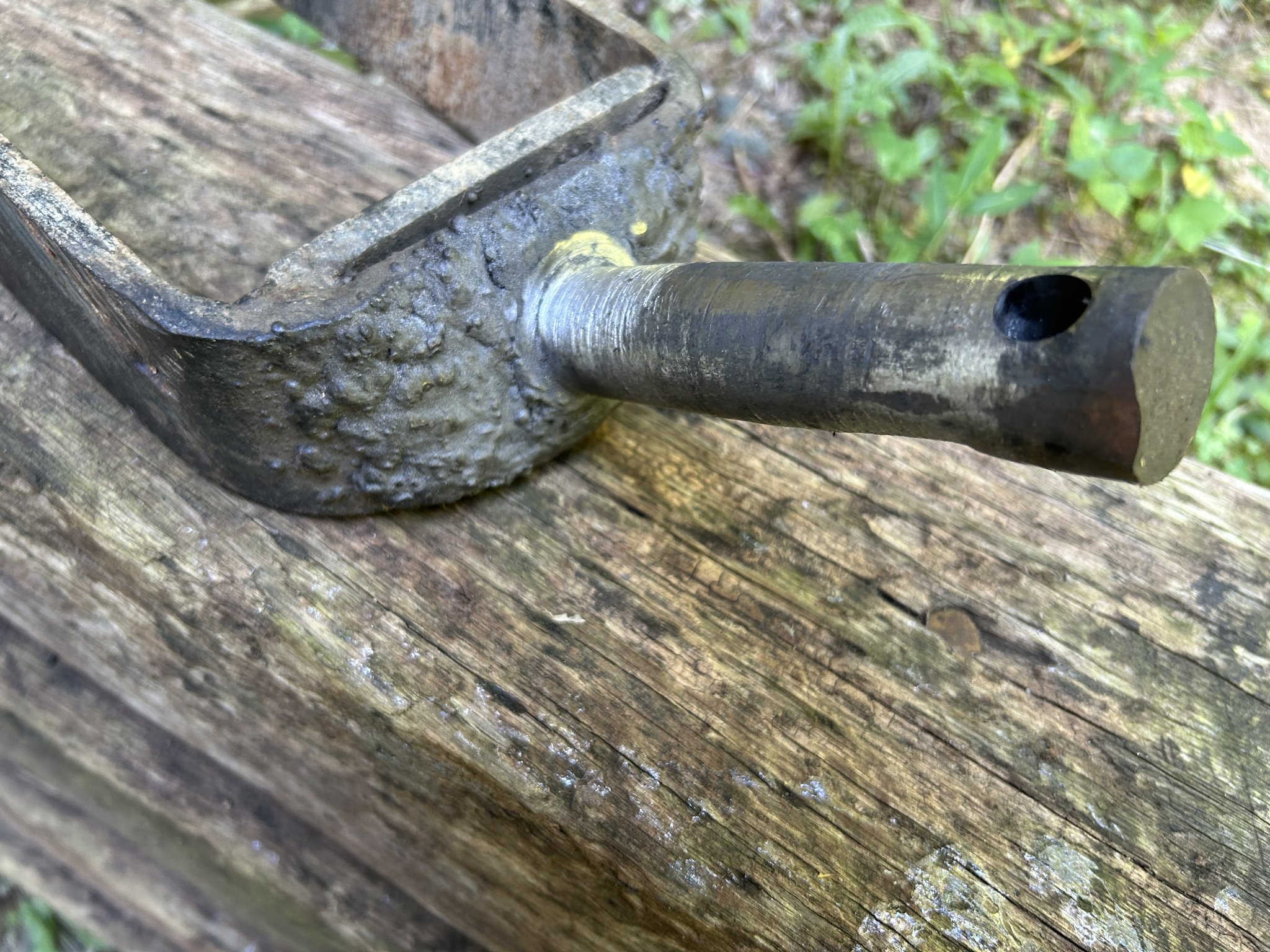

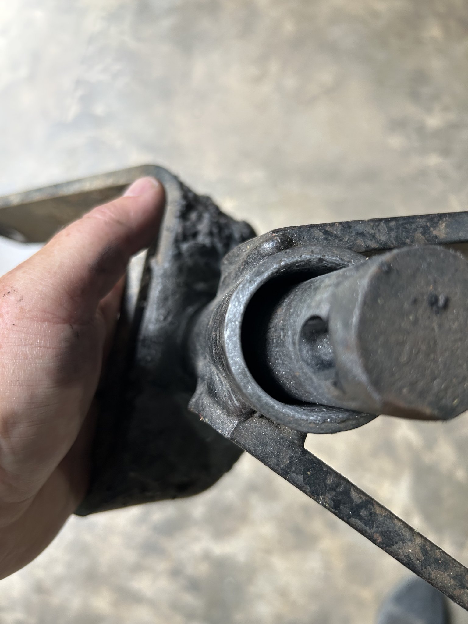

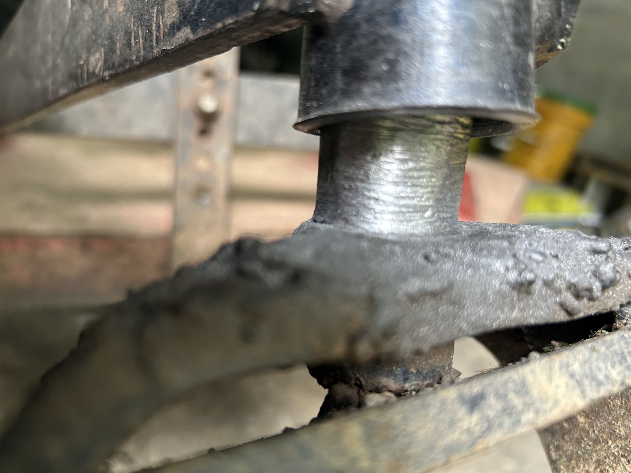

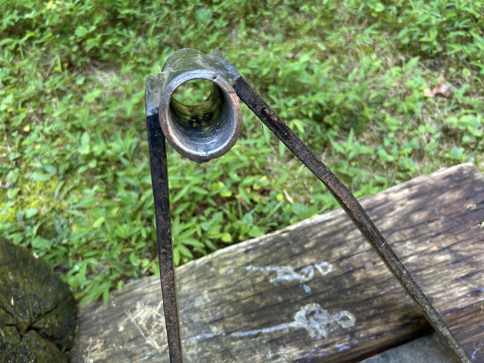

Ran fine with no issues until last time I used it. Tail wheel fork rotates only about 50% of the time when turning. If it isn’t swiveling, it’s dragging the wheel sideways, plowing a little gouge in the grass. Not cool. I could blame myself for not greasing it, but with the huge gap, don’t how you really could grease it. As shown in the photo in prior post, the excessive gap isn’t new.
Socket is way out of round, very thin, cracked on one end, trumpeted on both ends; just wore slap out. If I was a skilled welder and fabricator like some here, I could probably chuck up something from the scrap pile into the lathe, make a new socket and post, cut out the old ones, and weld in new ones. The fact that I don’t have a lathe or skill to use one kind of held me back on that option.
No, I don’t know who welded that or when. I’d make light of it, but I kind of suck at welding, too. At least it held.

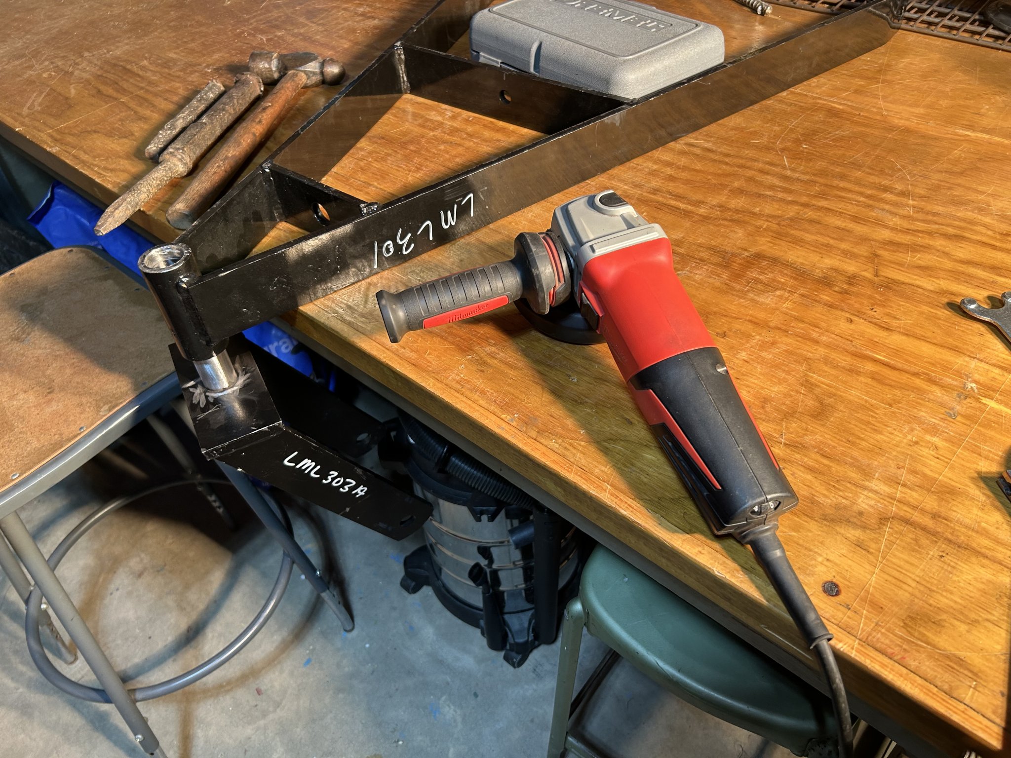

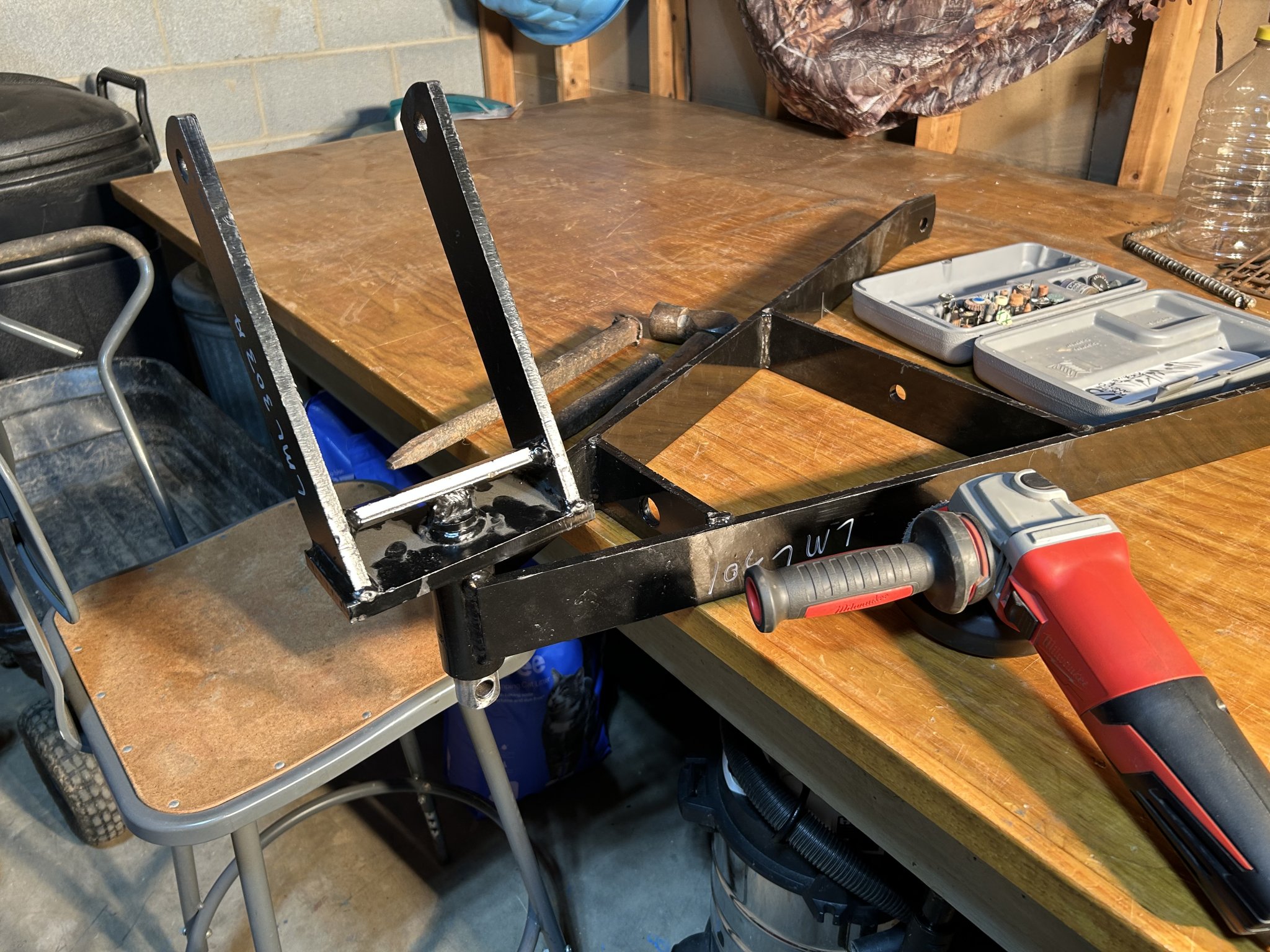

So, after checking prices on new rotary cutters and flails to verify they cost a lot, ordered parts. Had them in hand in 3 days. Kudos to Howes for still supporting an old a bottom of the product line implement.
Only issue, I ordered a tail wheel bracket with a 1.25” socket and a tail wheel fork with a 1.25” shaft. Sure enough, the socket was 1.25” and so was the shaft. Unfortunately, that’s an interference fit, not appropriate for something that’s supposed to swivel freely.
While I’m not a skilled fabricator, I’m not completely helpless, so started by removing the paint on the shaft with a wire wheel on a small angle grinder and removed paint from the socket with a wire brush on a Dremel. Also removed a slight wire edge from the socket with a rock on the Dremel. Closer, but no love yet. That’s as far as it would go in and it was seriously stuck. Gravity should be causing it to fall out, but a large punch and hammer were required.
Swapped the wire brush for a flap wheel. Slowly and carefully took a little off the shaft until it went in without hammering and swiveled 360 degrees without catching and sweeping everything off the bench.
Other than that mild irritation, it all bolted right up. BTW, I’m still mildly giddy every time I use the Milwaukee high torque on something like this. The bolts holding the fork to the deck haven’t moved in decades. No penetrating oil, no hesitation, no damage to anything. Just takes them off like unzipping a jacket. Absolute pleasure to use.
Tested it out this morning. Working perfectly again. And now that it isn’t so sloppy, I can actually grease it.
