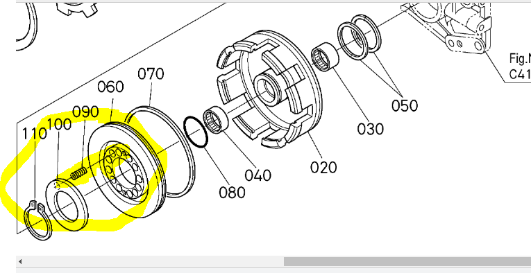

Well your not really going to like what I found:
Matches everything you got going on in a nutshell.
If you need more info Just let me know.

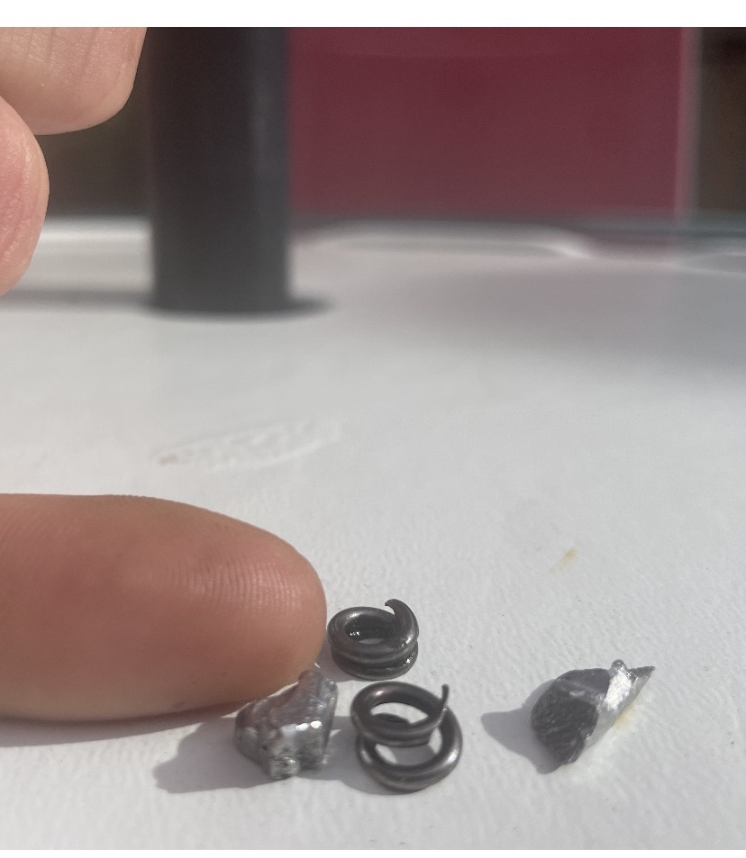

Thanks for the information! Man that’s a bummer to hear but I’m glad you found that. So here’s another question, I removed the filter and found what looked like broken spring and something else? Could this have came from that?

This is a WILD educated guess, but those parts looks like a GST clutch spring and a piece of the GST clutch.

If you have a photo of the full blow up of that diagram I could use to see what all is involved that would be greatly appreciated. I’d like to see how to get to that clutch pack.
31,467
7,279
Check you PM's top right.
The blow up of the parts would just make it more confusing. ;)
