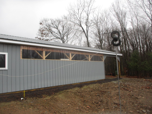

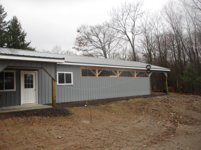

Pole barn / Steel building .....Let's talk magnets & over-the-air TV antennas.
WNY hunting camp, off-grid, no internet.
(but excellent cell service, tower is less than mile away, if that has anything to offer for this thread.)
We want to get rid of our little rinky-dink antenna and thinking of putting the new larger antenna on the roof to get it up as high as possible, ( we're kind'a in the trees ) but want it movable to fine tune the reception.
Amazon has some 70lb and even 100 lb capacity magnets.
We are thinking of making some type of base for the antenna and sticking it on the roof with magnets to be able to move it.
What'a you guys think...? Would it get blown off....?

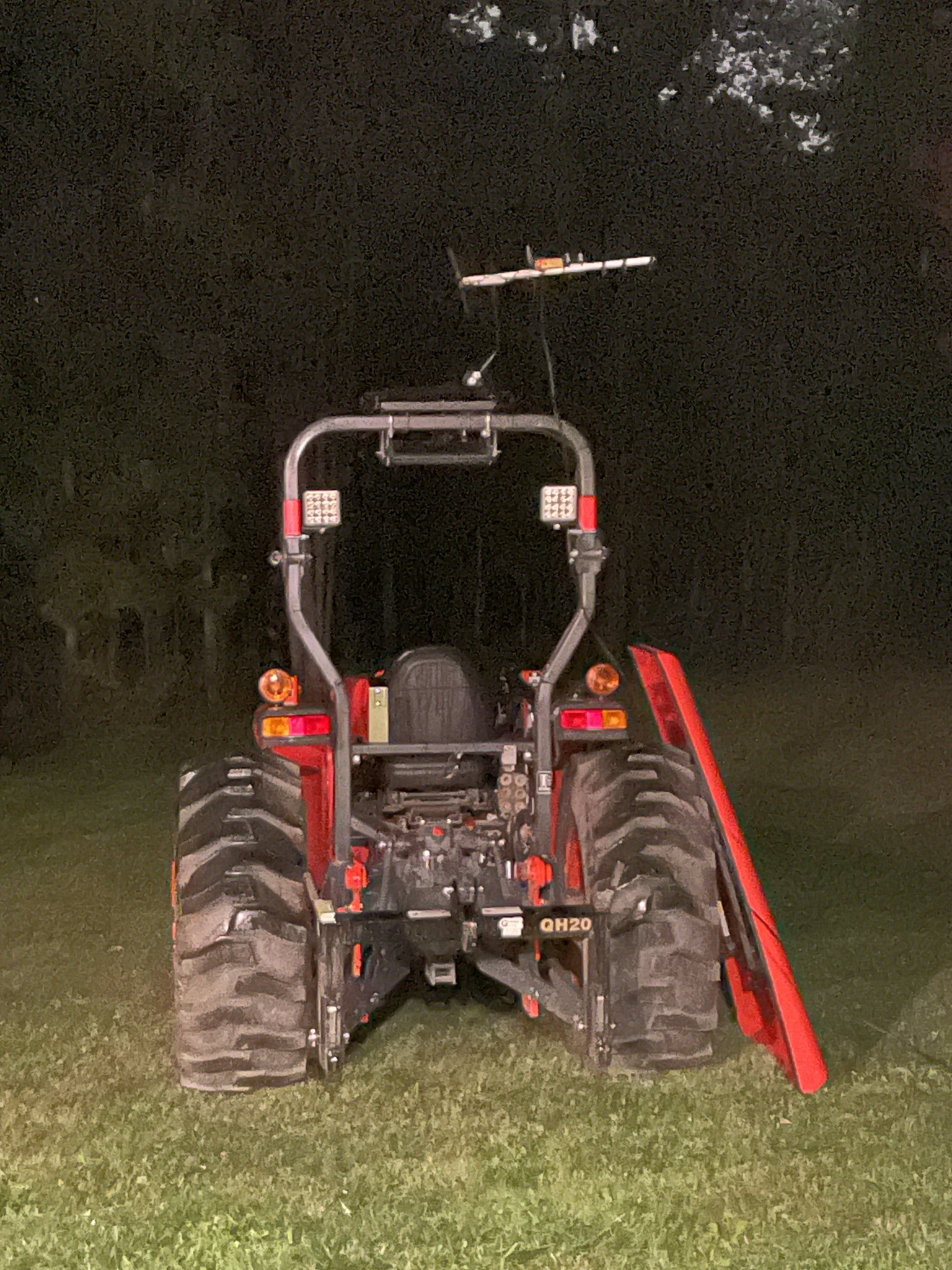

I think the tower idea mentioned above is the way to go (although I still use a temporary mobile telecommunications platform at my steel building 😂…it works but I think it attacks rain/snow).
