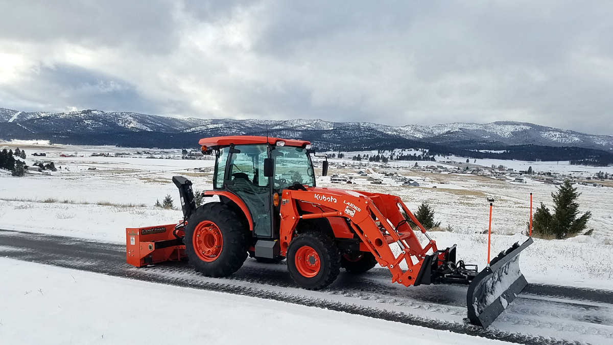

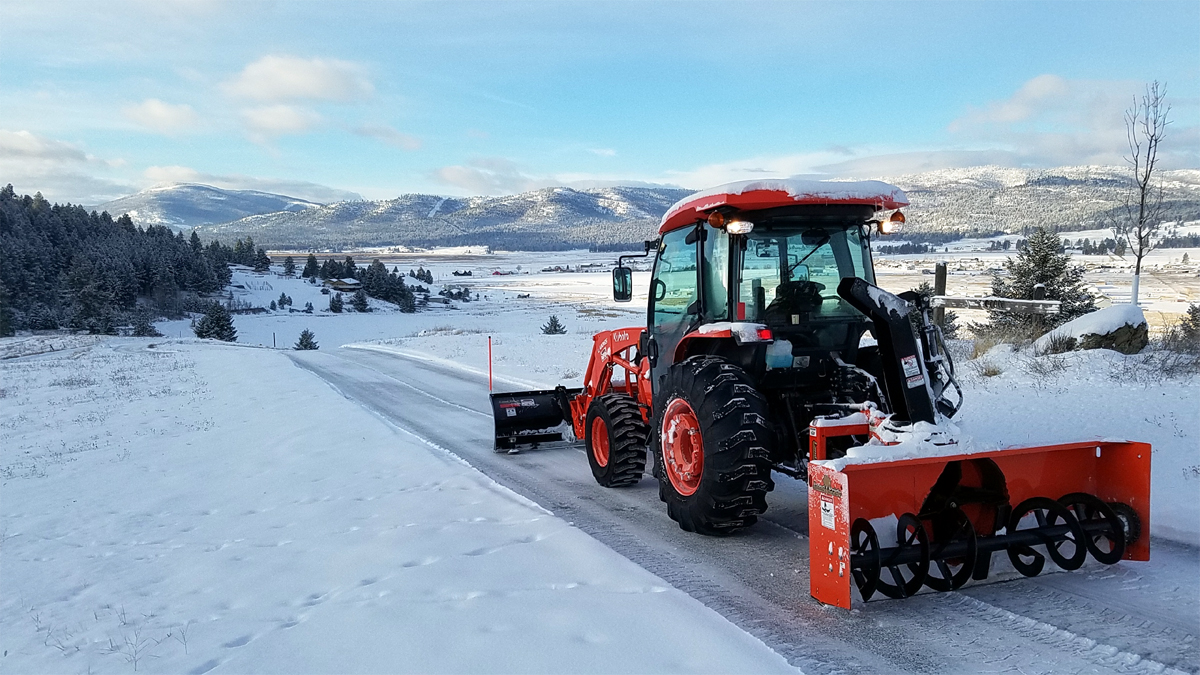

I have the STB1596 version and as @Bee-Positive said, the blade tilt is controlled via the bucket tilt function, and ideally the blade angle is controlled by the 3rd function. I would never want to be adjusting the angle manually, on any implement, but certainly not on a snow blade. I'm constantly making adjustments to the angle while pushing snow, and much less often the tilt.
I have hydraulic chute rotation and deflector angle on the snow blower which is another feature that I wouldn't want to be without.
