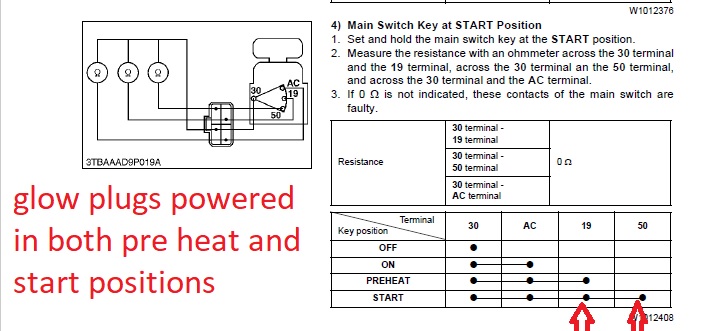

Perhaps the key switch is shot, someone messed with the wiring or rodent damage.
The glow plugs are powered in both pre heat and start key positions.
You can remove the key switch and use a multi meter to check its 3 positions as shown in the above table.
