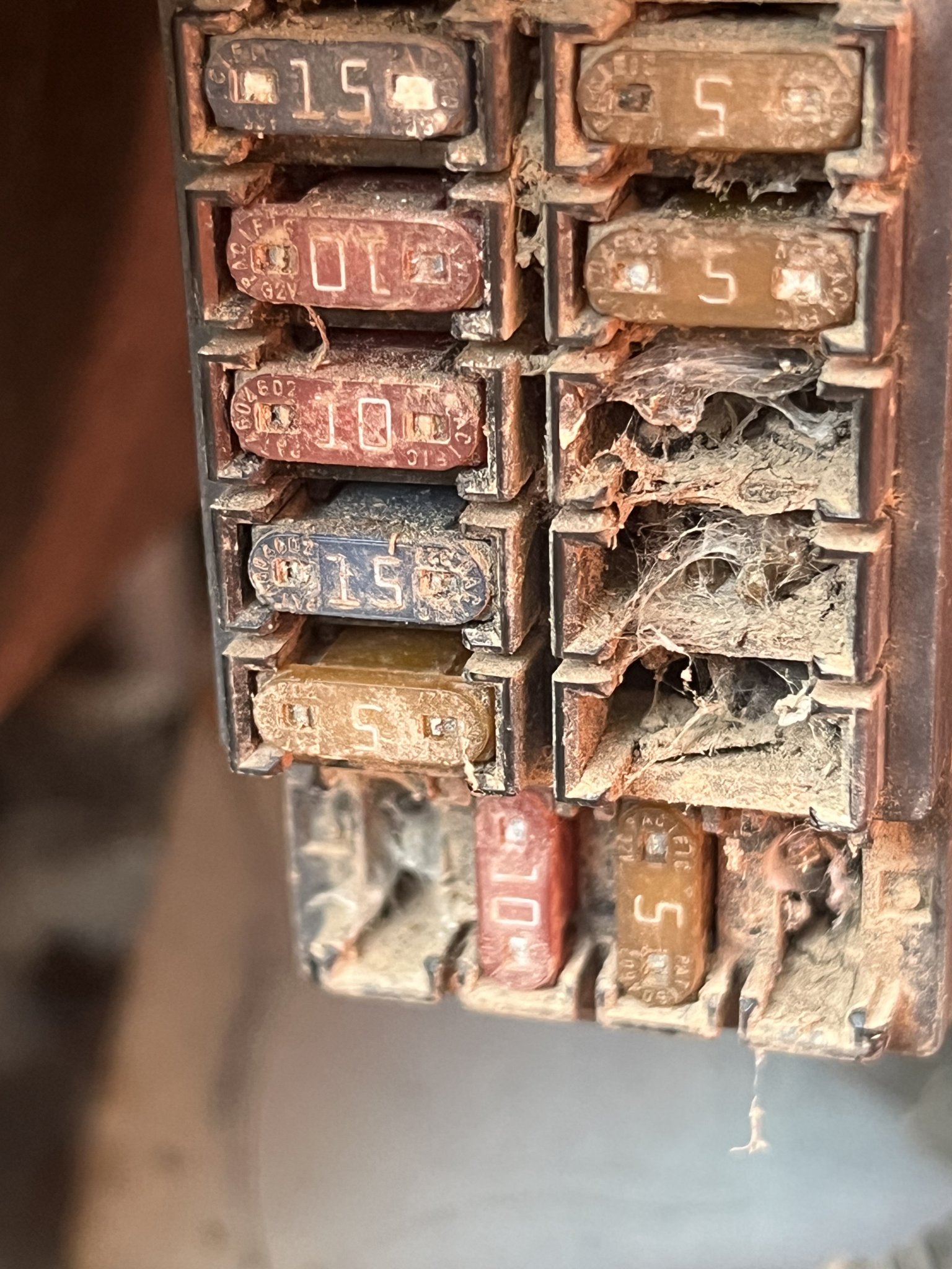

Wolfman wins!! Found a 5 amp fuse (no idea which one that wasn’t continuous. Traded it out for another one and it started right up.
You my hero. and really this whole site is. Thanks to everyone for helping!!
Please look at the list of things I tried before really checking all the fuses!! Aargh!!

While you're at it , do some serious 'house keeping' on the tractor . That fuse panel shows a lot of neglect and 'electrical gremlins' LOVE to hide in 'grungy' spots like that.
A clean tractor will be a happy tractor.
