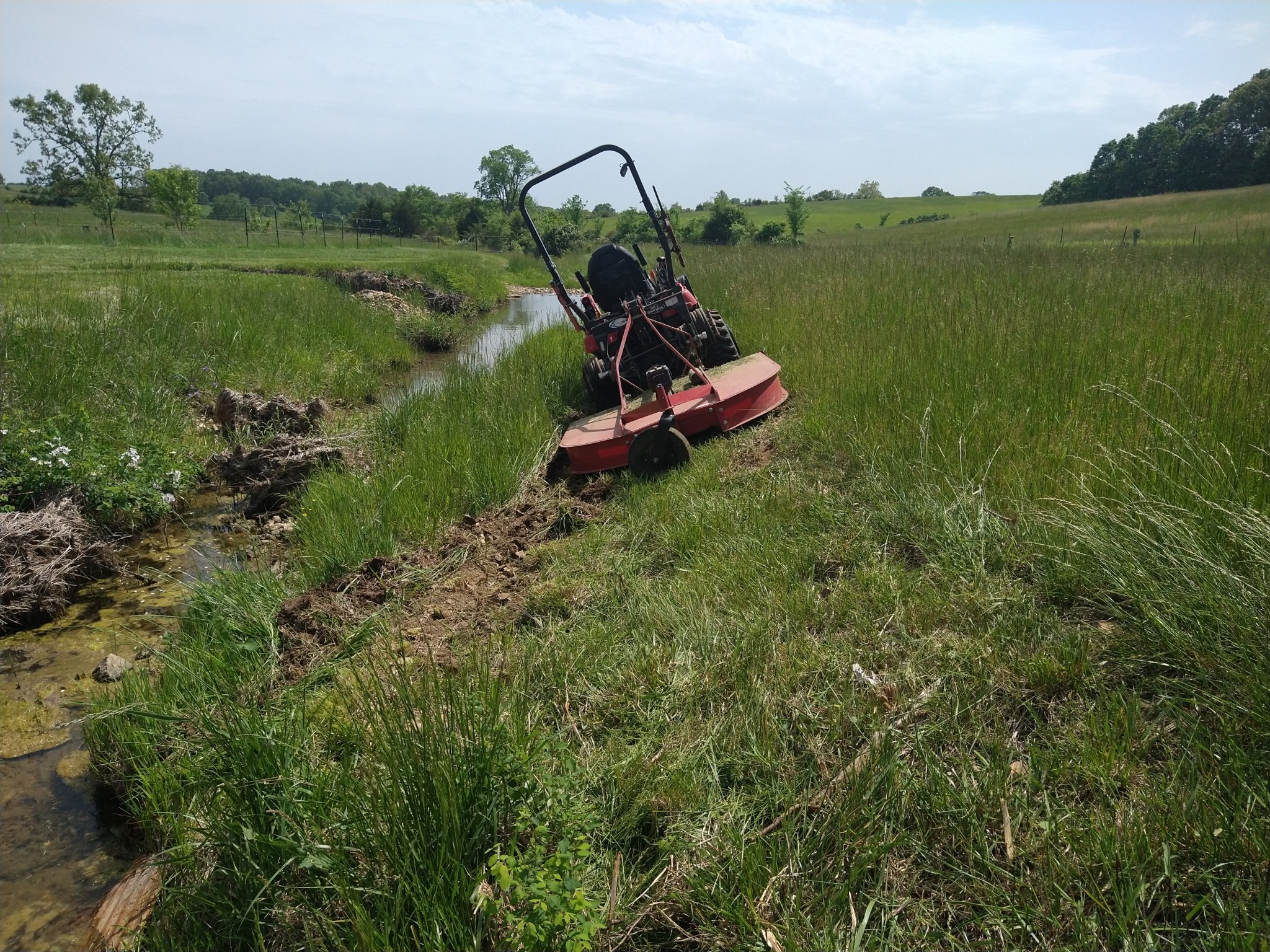

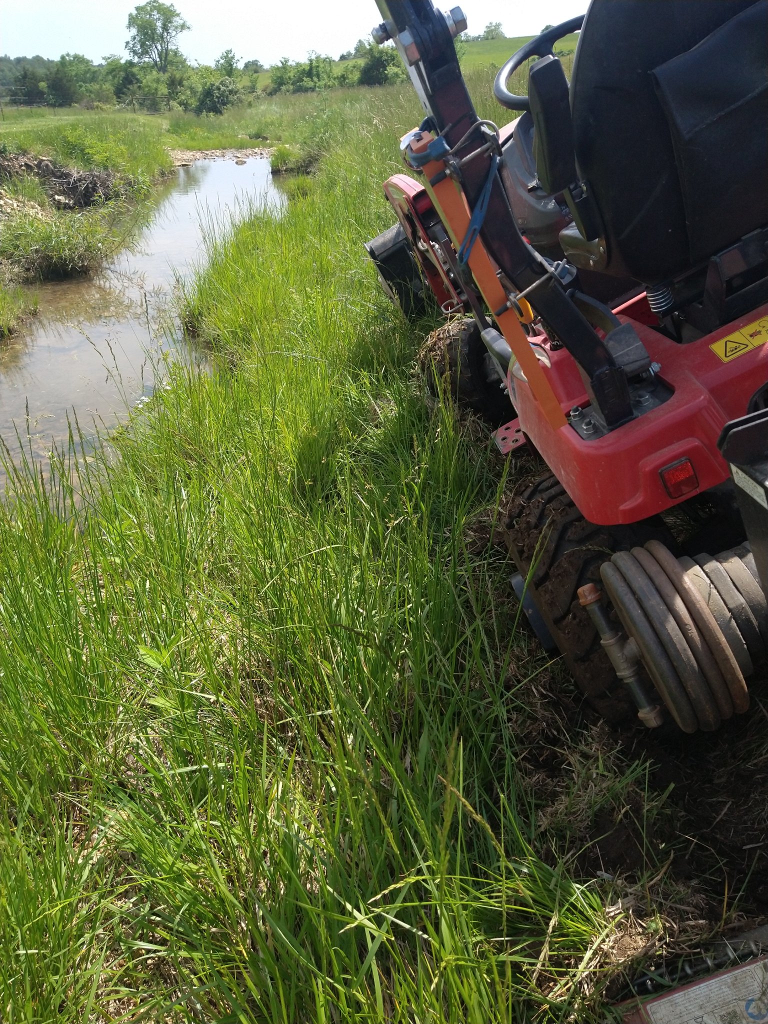

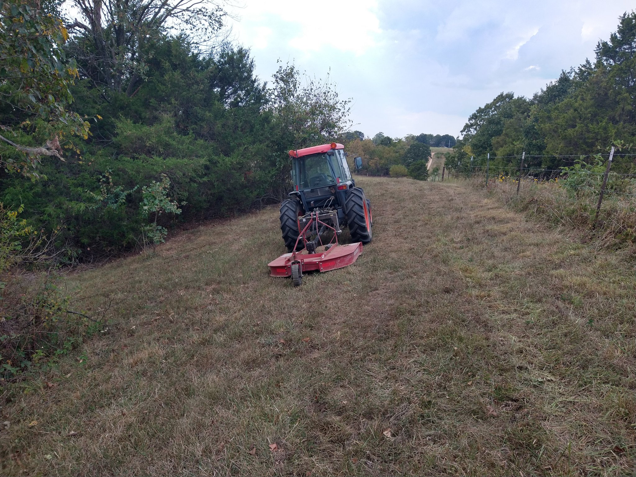

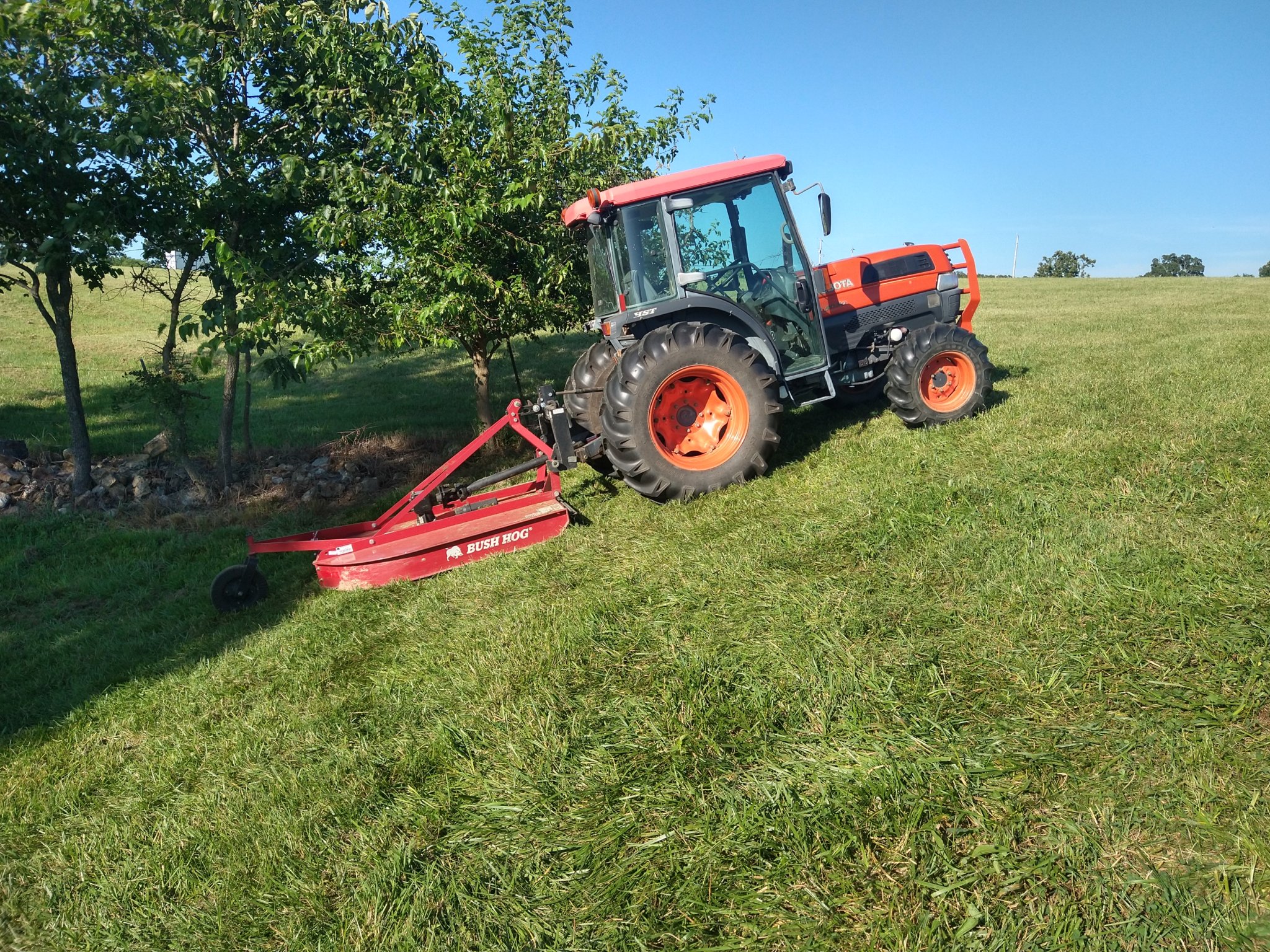

I mow this sideways too ... No filled tires.
Camera is not quite level on this next one, it's at more of an angle ... The little tree on the left, is the same one just beside the tractor, same area just look the opposite way (this is looking West)...

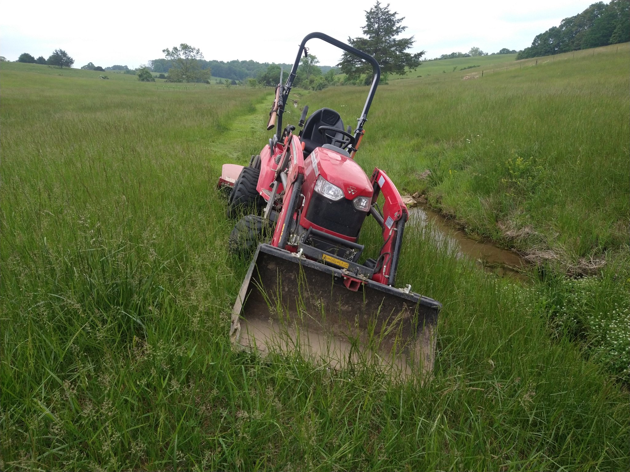

I drove up this one in 2 wheel drive, didn't spin a tire. (Looking East)

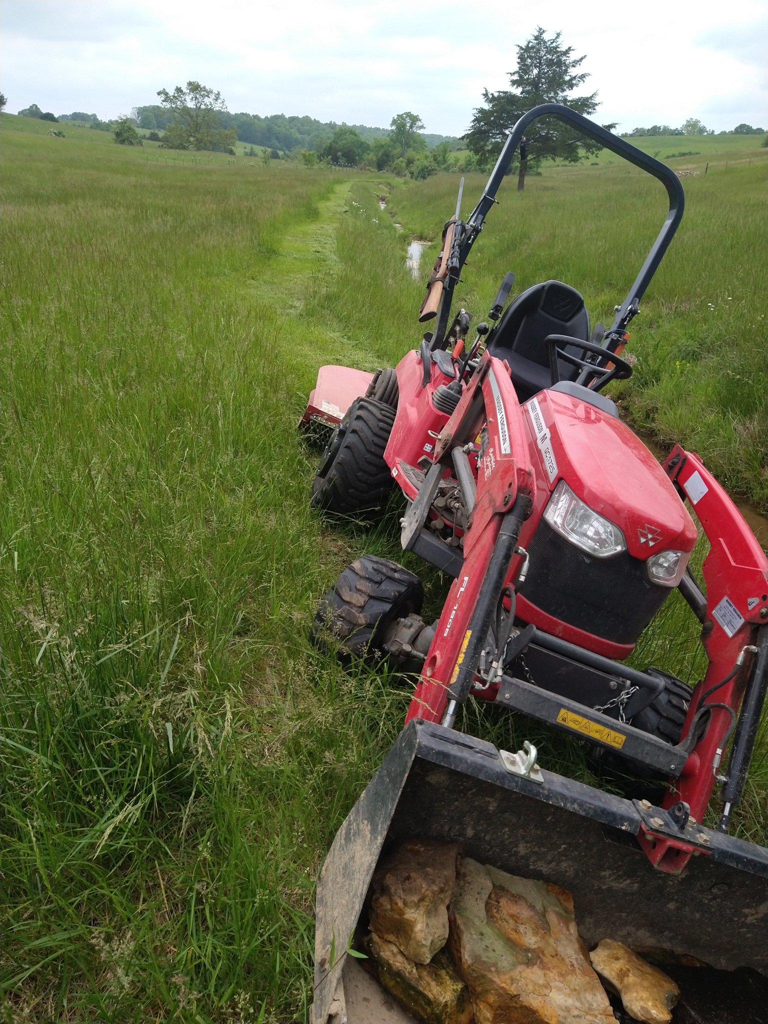

Here I forgot to add rocks to the bucket for front ballast, and even in 4X4 I couldn't steer the front up the bank, I stopped and gingerly got off the top side, holding into the ROPS, it was steady ... I gave it a half hearted nudge, it wouldn't budge, I finally placed my hands above the rifle and push as hard as I could ... Couldn't get it to begin to tip ...
I went down into the creek and got some rocks, and then drove it right up out of there!

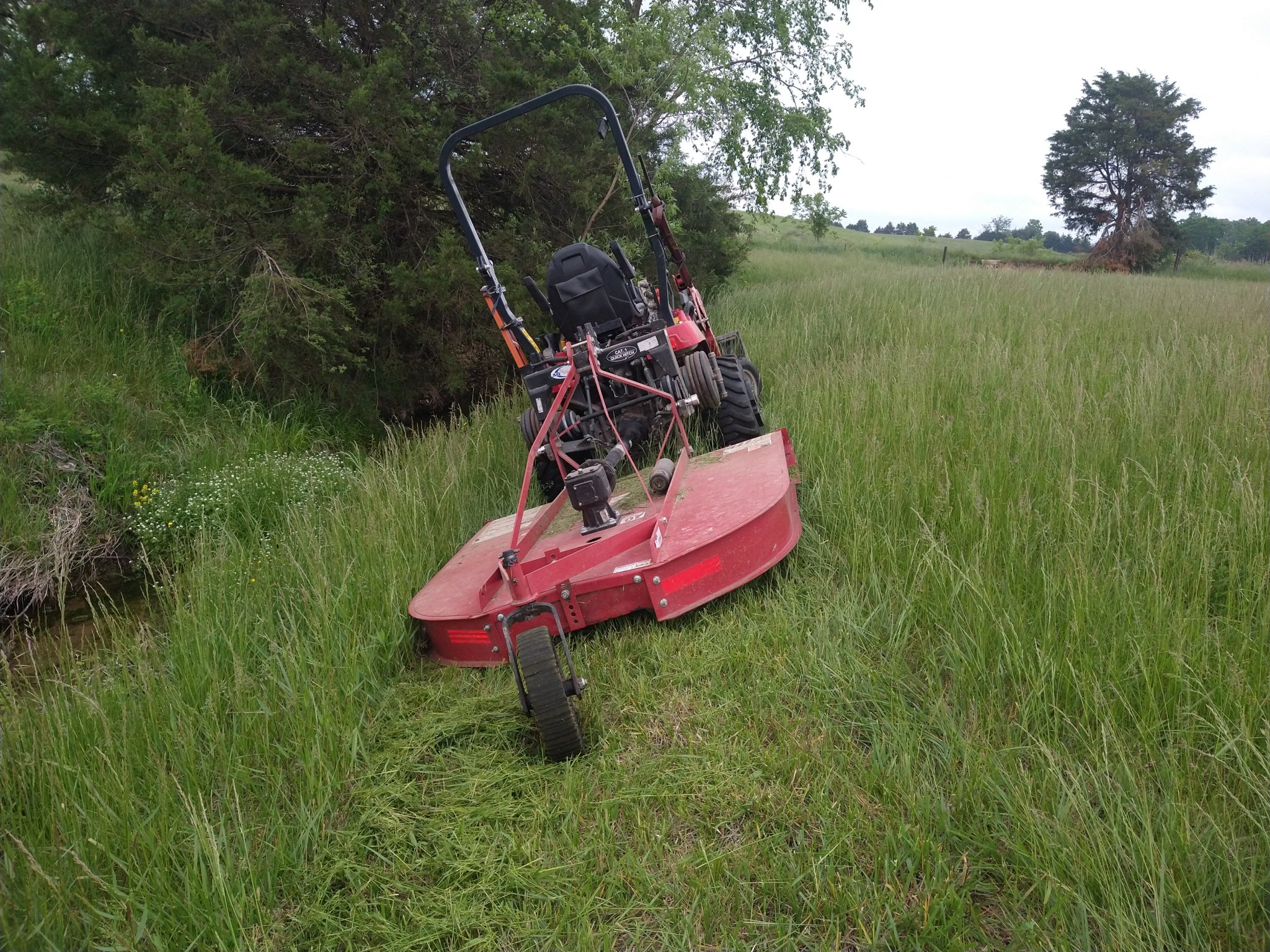

The next day ... I got into the soft dirt on the other side ... Needed my pickup truck to get it out, but still rock steady!
Now my Little Baby Fergie does have filled rear tires, plus 70 Lb steel wheel weights on each side, plus another 275 Lbs of steel weight lifting plates on the BH mount, plus the second day I still had the bucket full of rocks, so lots of weight down low ...
