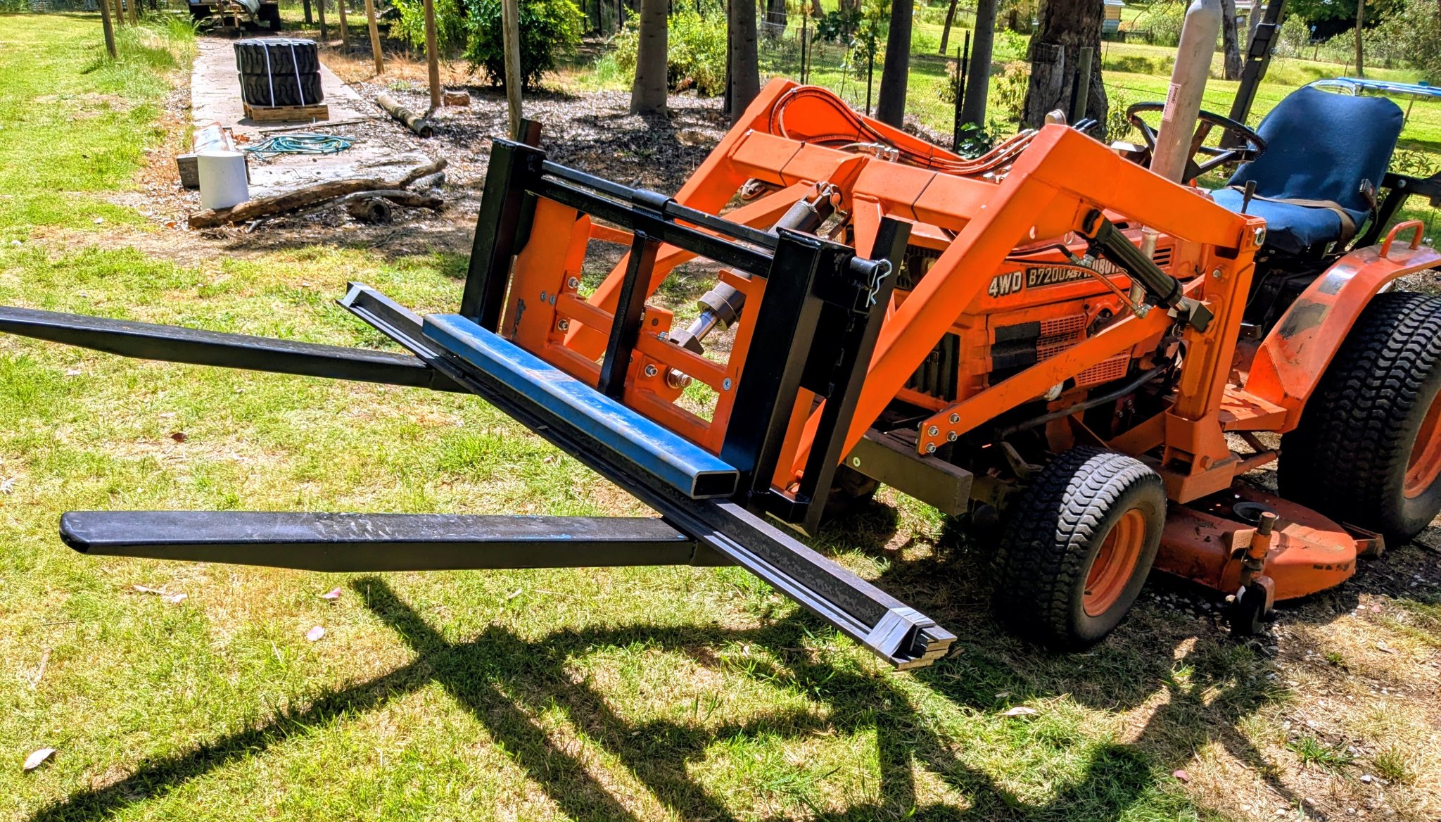

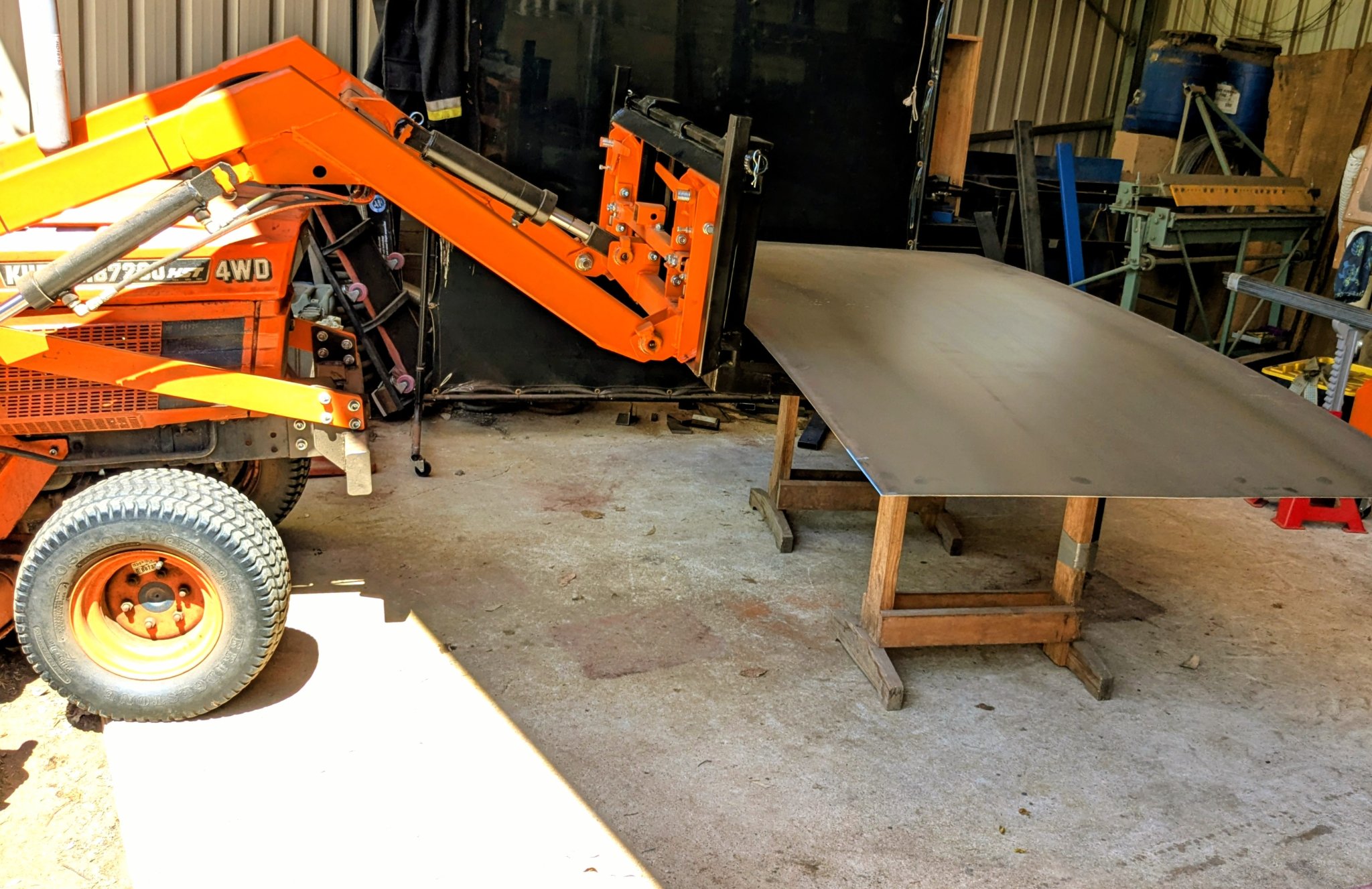

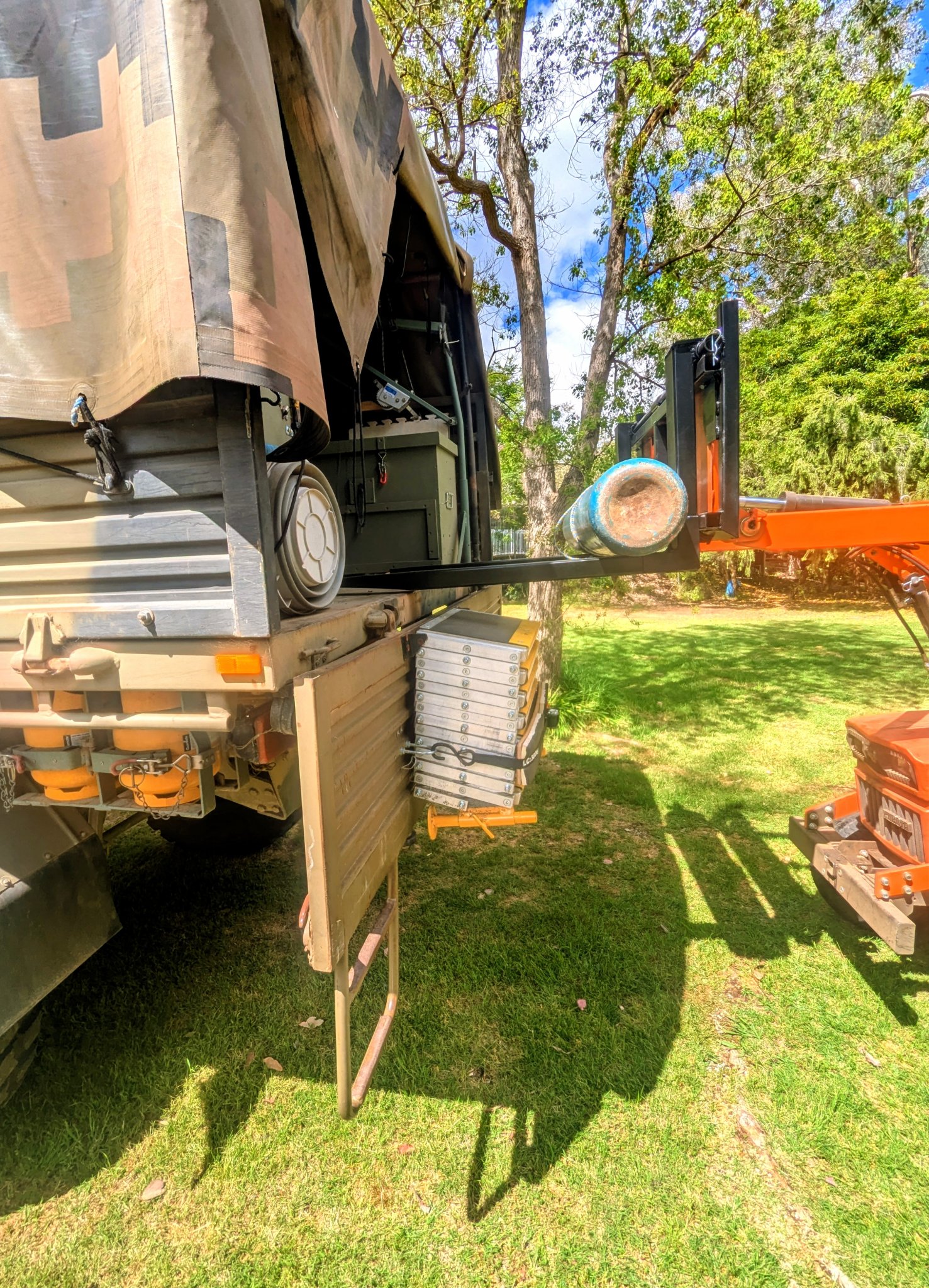

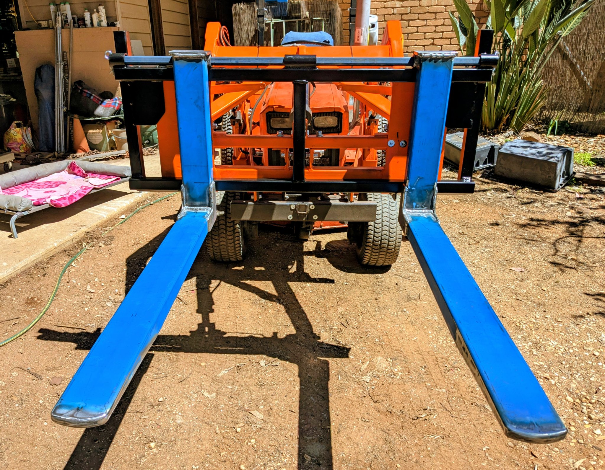

Since making the FEL and SSQA mount I've been planning to make a set of SSQA pallet forks, but no rush....until I was going to need them to unload a pallet of a truck at home this afternoon. So a couple of days ago I got started on the frame, and picked up the steel for the forks yesterday afternoon.

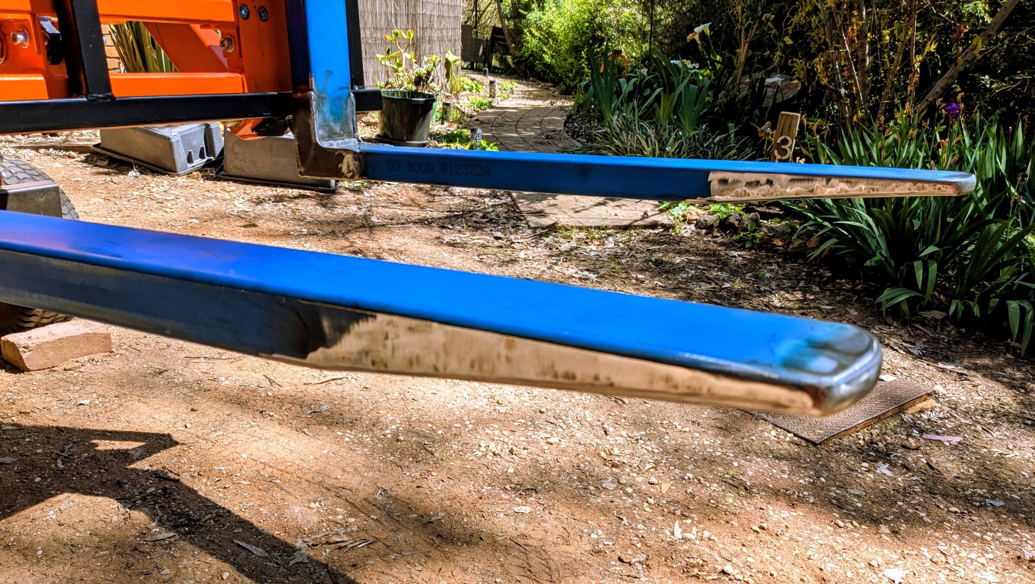

Now all that's missing is a coat of paint.

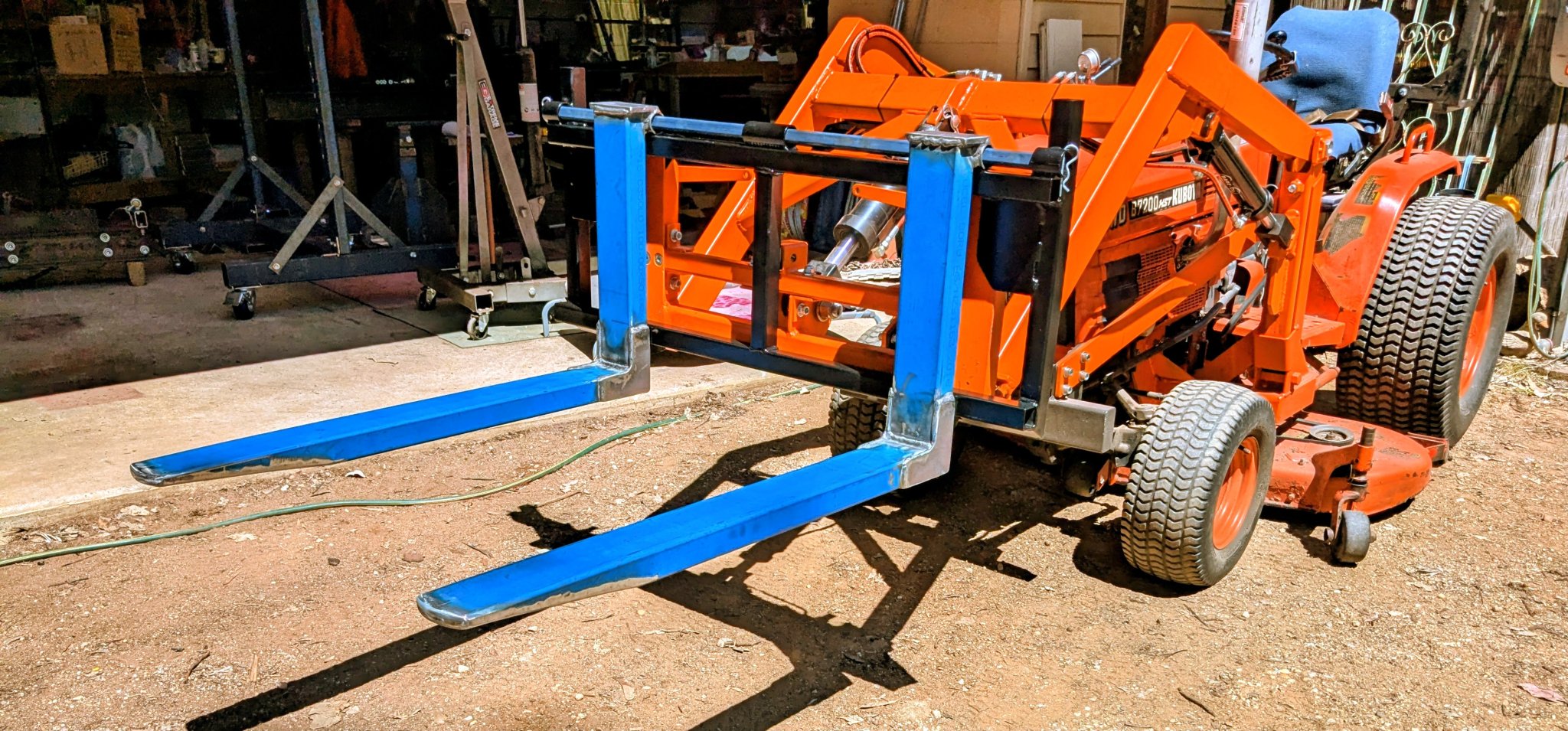

The forks are 100 x 50 x 4 RHS, most of the frame is 40 x 40 x 4 RHS with some 50 x 5 flat, and the forks and frame combined weigh about 41 of (90 lb).

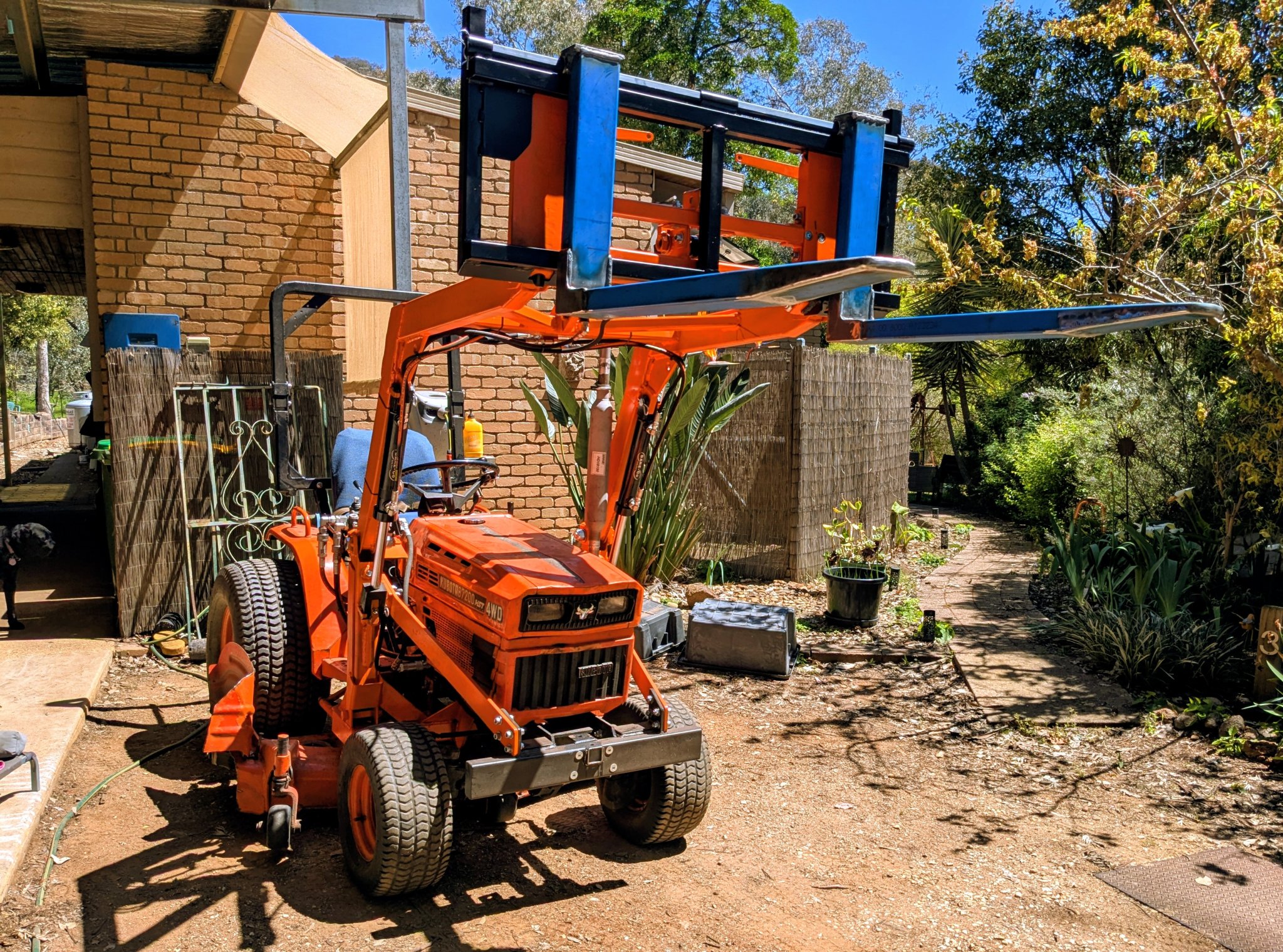

I tested them on a pallet of concrete pavers weighing about 270 kg. Still no ballast, but lifted a foot off the ground ok, and survived with me bouncing up and down on the far end of the pallet.
The forks still need a coat of paint, and I need to add a frame to stop the load from landing on the tractor.
Edit: Thanks @torch for sharing your design. You might recognise some off it here.

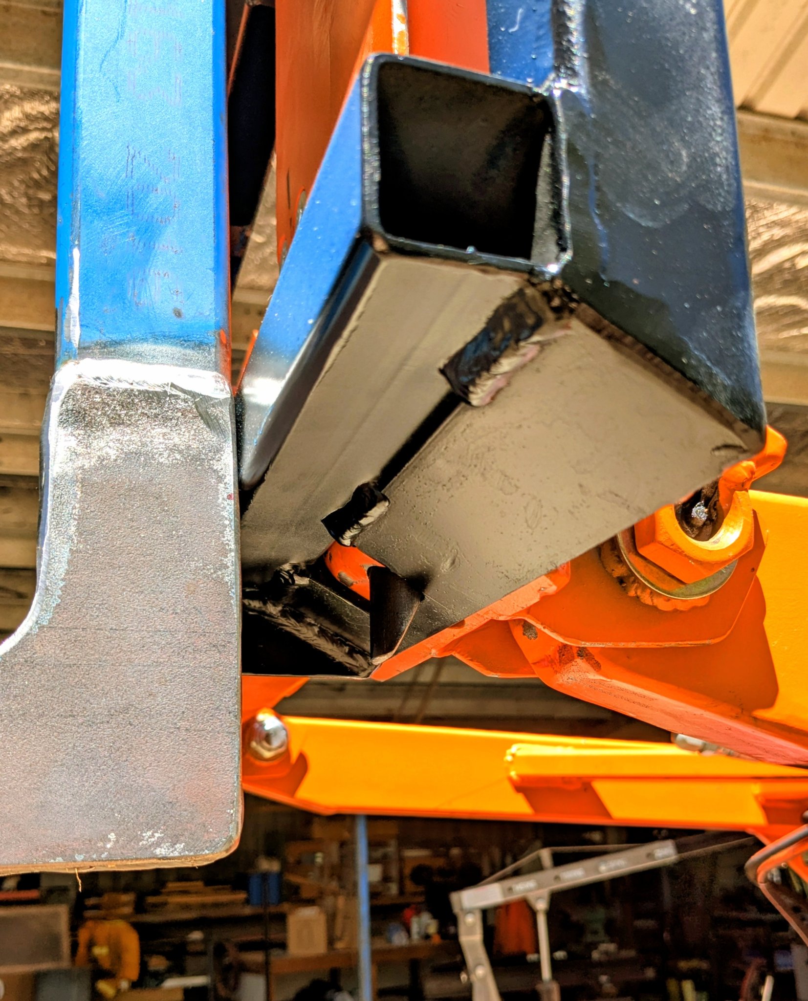

With the top mount of the forks being round, you really need a round solid rod to distribute the load out better.
But, you probably will never be able to get enough weight on the forks to cause you any issues.
I think you're probably right that round bar would be better, but I don't think I'll ever bend the piece of square tube that's in there. And I didn't have a piece of round bar long enough.

Yes, some of it looks very familiar! <lol> The design has served me well over the years and I'm glad to see it is of use to someone else. I would echo Wolfman's comments and replace the top bar with round though. Even heavy-wall pipe would bear against the round retainers better than square corners.
