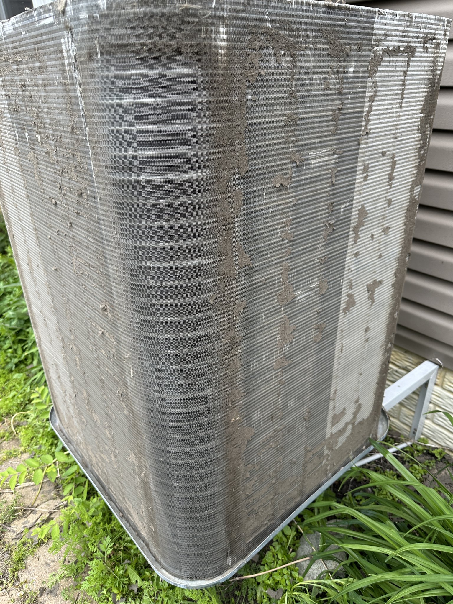

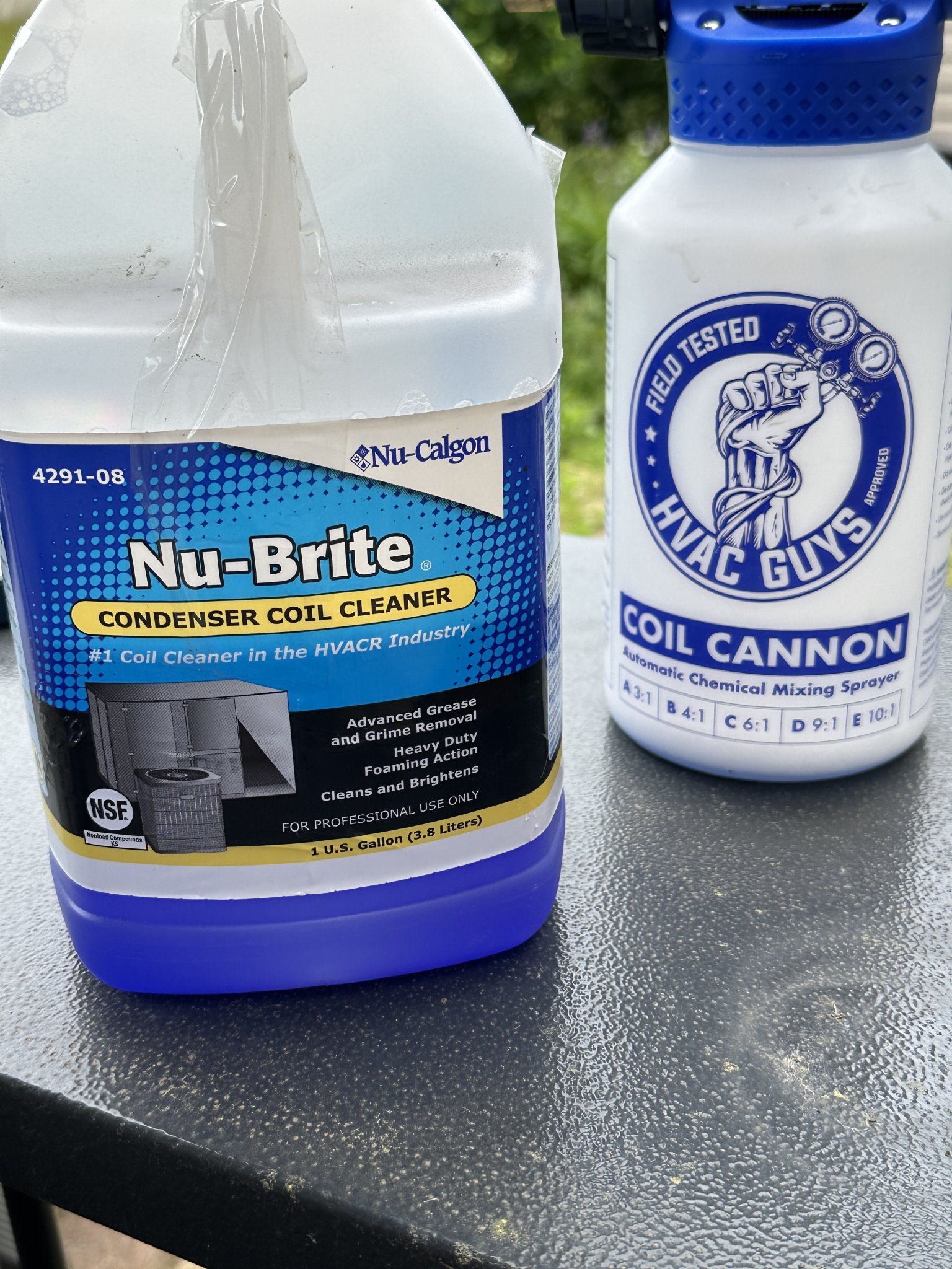

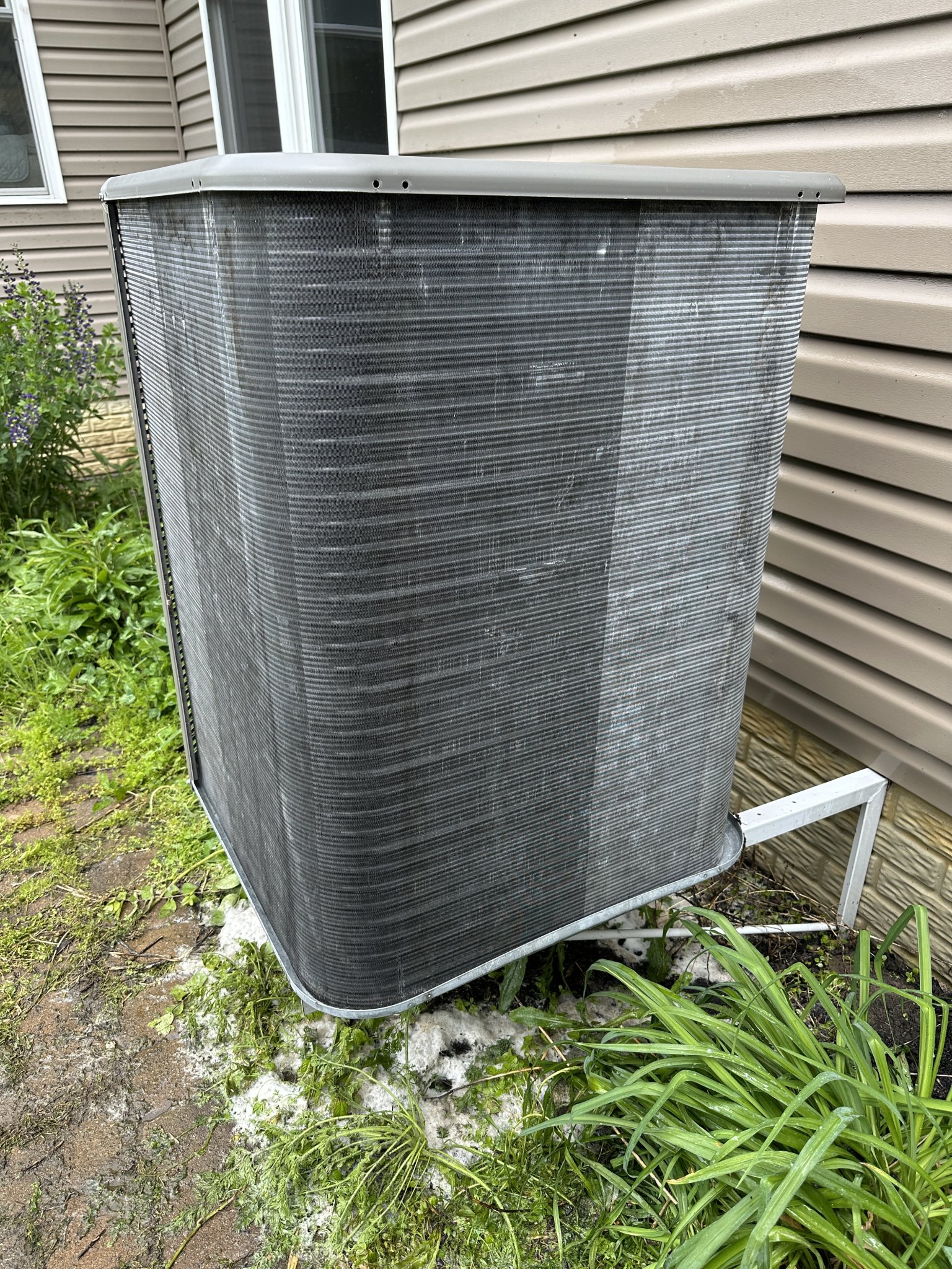

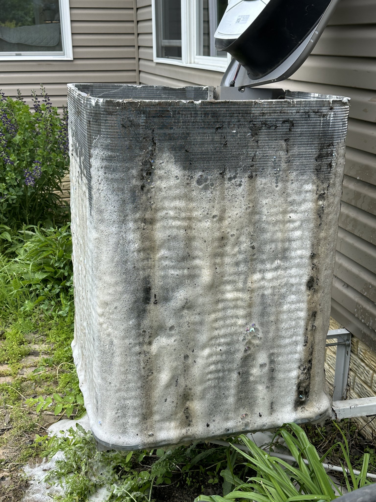

Never done it but decided to clean the AC coils this year. Glad I did. Around 45 minutes of work and it is ready to go. 8 years of dirt in case you are wondering

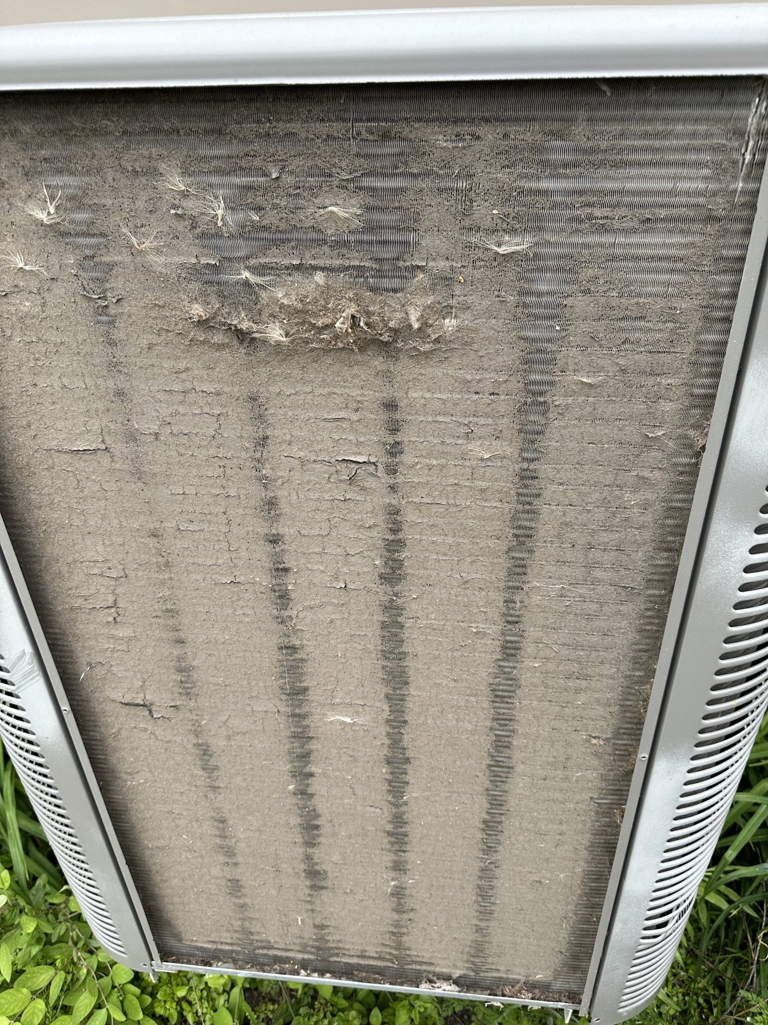

She was a dirty girl. Sprayed it out from the inside with compressed air to break that stuff up so the cleaner could work.
