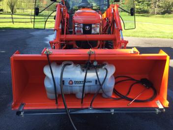

I just reconfigured my sprayer for a new tractor. I got a 25g sprayer tank from Tractor Supply that came with the pump and wand. Fabricated a 6' boom out of angle iron (light gauge) and drilled holes for 4 nozzles. The boom is bolted onto the loader, and tank is bungee corded in.
What I really like about my current setup, is that I rewired the power to include a wireless on/off switch that works great. Since my battery is up front it saved me from having to run heavy wire back to the seat to a manual switch and back up to the sprayer. Fimco (a sprayer or motor manufacturer) makes a wireless 20 amp switch purpose made for sprayers.
