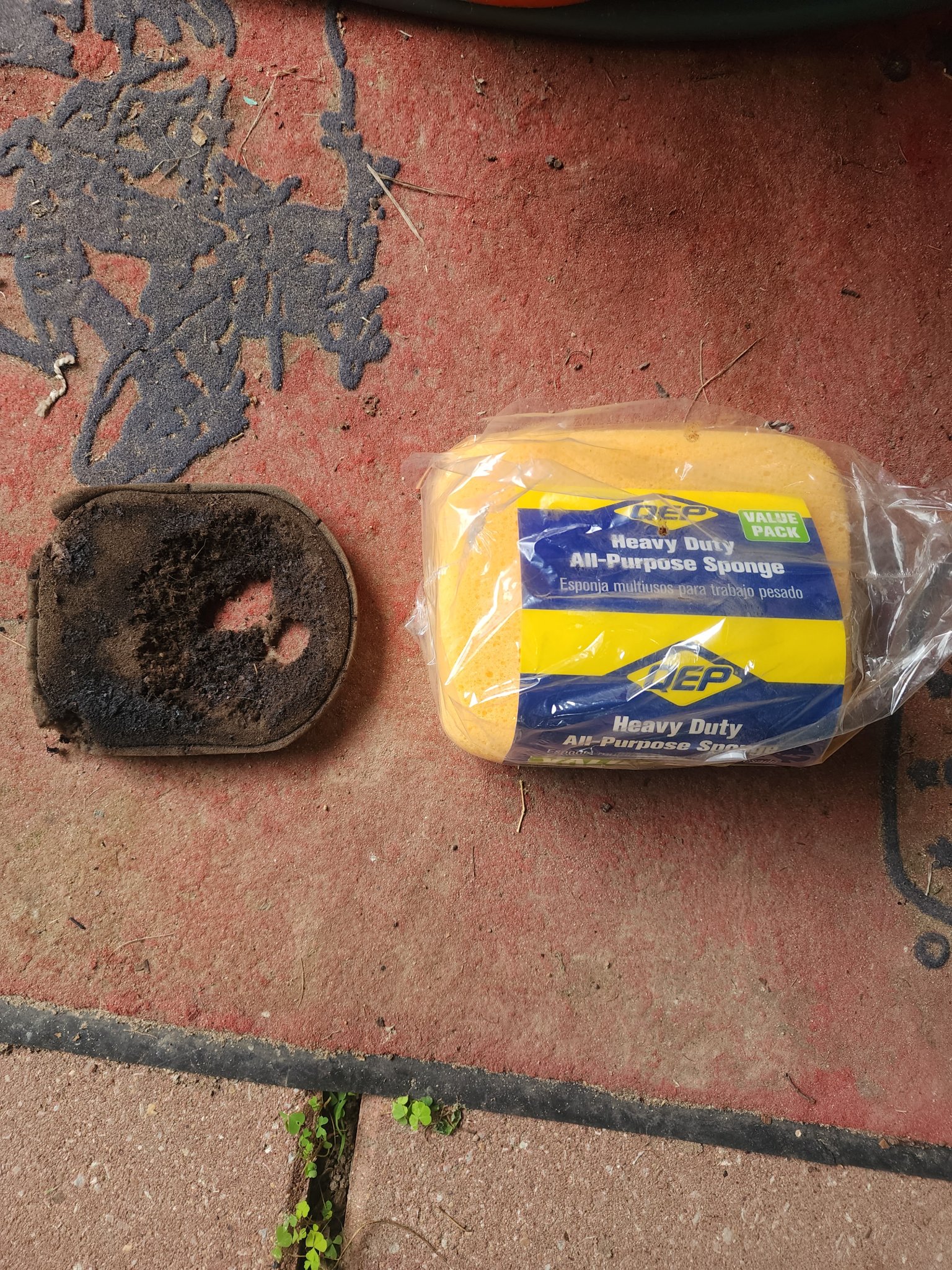

So, mice got into my log splitter's air cleaner this past winter and destroyed the foam air filter element. It is a flat 6"x 4" foam air filter element that you oil.
Can I use a standard cleaning sponge saturated with oil as a temporary fix?
My local small engine repair/ parts store doesn't stock a new one and he suggested Amazon.
Amazon can have one too me next week but I planned on using the log splitter today and this weekend.
I am either on to a big savings idea or a flop and a damaged engine.
I am going to cut a cleaning sponge to size and oil it and see if it degrades or melts before putting in in the machine.
Thanks for any advice.

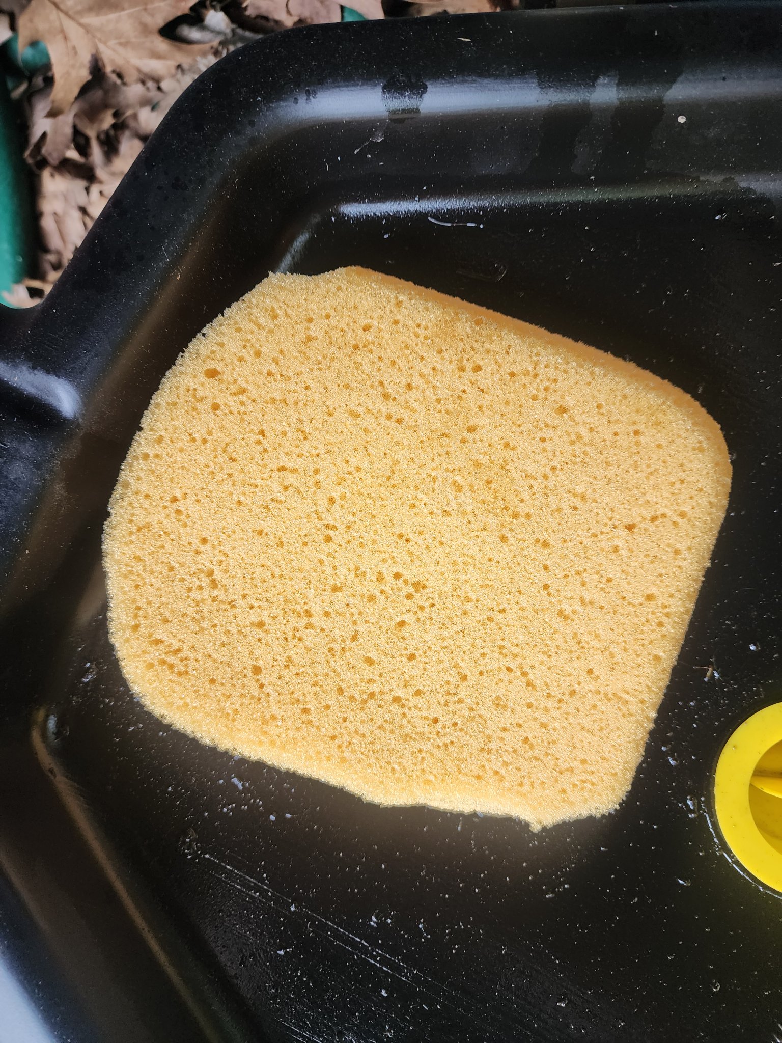

Original filter and cheap cleaning sponge...
Cut cleaning sponge to size in 3 dimensions, and soaked and then strained in 30w.

Waiting to see if the sponge has a reaction to the oil....

Well the sponge didn't show any negative issues with oil saturation.
I found mouse poop and urine stains in the airbox and carb, as well as some acorn shells. Ugh!!!
I pulled and cleaned up the airbox and the carb, as mice had crawled into both. It didn't appear that they got past the choke butterfly gate though. I drained the gas tank since I had the fuel line off of the carb. I put an ounce of SeaFoam into the cylinder when I checked the plug, gave it a few pulls w/o plug installed, and let it sit. Also a couple oz SeaFoam into the empty gas tank. Filled the tank. Put it all back together and installed the sponge and it fired up after several pulls.
I let it run for about 30 minutes checking the hydraulics, and the sponge every few minutes. It was working fine.
But, I pulled the sponge make shift air element out after all because I am now concerned with the engine heat melting it. Although I saw that it wasn't melting, I don't trust it.
