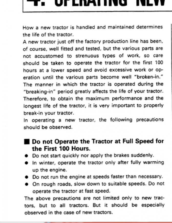

Well I was wrong on the 1500RPM's for 50hrs, that will teach me to reply on cold meds!:eek:
It just says not to run the tractor at full speed for the first 100hrs.
Well 3000RPM is cranking that baby right up there at top speed IMHO!
The rated is only 2600 RPM and 540 PTO is 2475.:rolleyes:
But hey you bought it you can treat it anyway you want! I was just stating IMHO why it was smelling or running hot.

Running at close to 3000rpm is enough to make a hot smell on a new machine. In two years I have never had my L3800 that high. :eek:
Manual says not to operate at full throttle for the first 50 hours. Use enough rpm for the job, extra rpm just burns more fuel and makes that hot smell. :cool:
