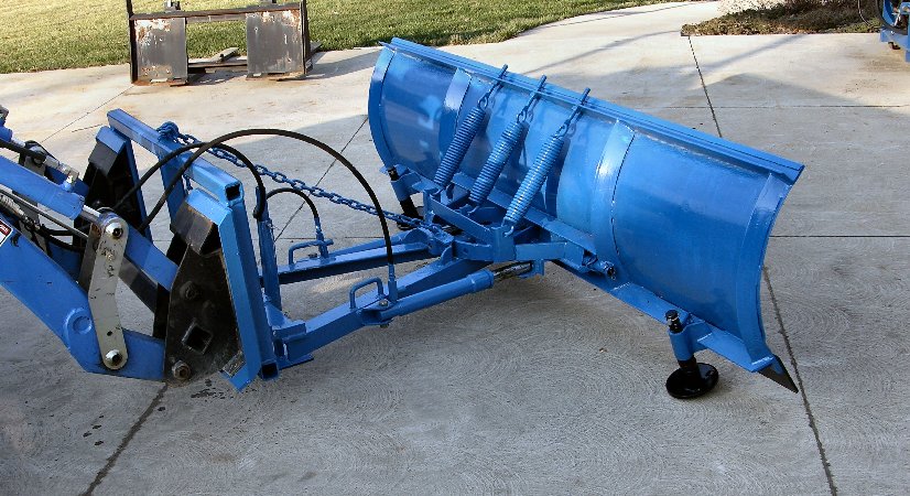

Now, if you really want to get exotic, have 2 sets of snow plow mounts welded to the inside of your bucket, and hook your plow to the bucket. That way, you can raise the plow to almost any height that your bucket will go to. You will also need a lift chain from the center of the snow plow frame to the top of your bucket that will allow your plow to float as you push the snow and keep the bucket from contacting the ground. Here is a good video that will give you the idea.....
And here is another suggestion using a skid steer type of connection..

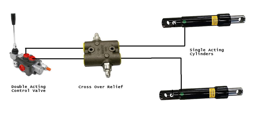

Here is the standard plumbing for a plow with two single acting cylinders. The cross over relief allows the plow to breakaway and pivot when (not if) you hit a solid object like a curb while plowing. That protects the tractor, plow, and operator from impact damage. The relief is typically mounted on the plow frame and connected to the cylinders with two short hoses.
