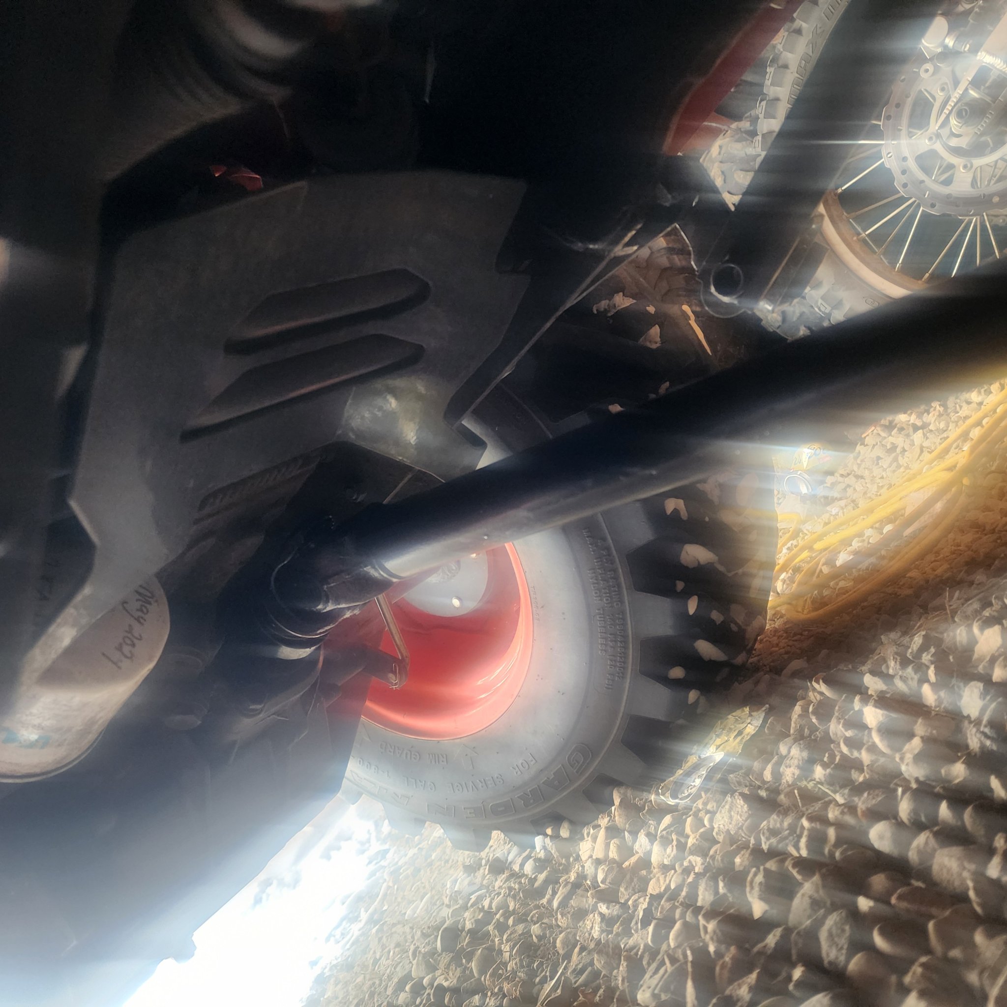

So I ordered the wrong PTO drive shaft for my BX2750B snowblower thats mounted on a BX2751. Its about 15" too short. Before I order the wrong one again would someone have an idea the part # for the proper one. One thing that stands out is where it says "SERIAL NO. 2410735 AND UP" Im wondering if that has to do with some big change or some other adapter im missing. That picture Ive got of tape measure is from the mid pto shaft to the drive on this front mount snowblower.

Trying to figure out how you're 15" too short as you're saying. The fixed length shaft is measured cap-to-cap but then you'd have to add in the length of the spring yoke on one side plus the length of the slip yoke on the other side. I do think you're about 4" too short, not 15".
To confirm, measure the shaft you received from end to end and see how that matches up with your tape measure picture. I'm willing to bet the ~37" shaft is what you need. BTW, I had a typo in my original reply. I said 38-3/8 when it should have been 37-3/8". There's an 1/8" difference between the two shaft lengths when looking at the various BX2751/BX2752 options.

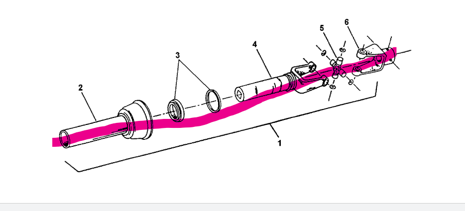

The 70001-02186 shaft in your diagram is 37-1/4" from cap to cap.

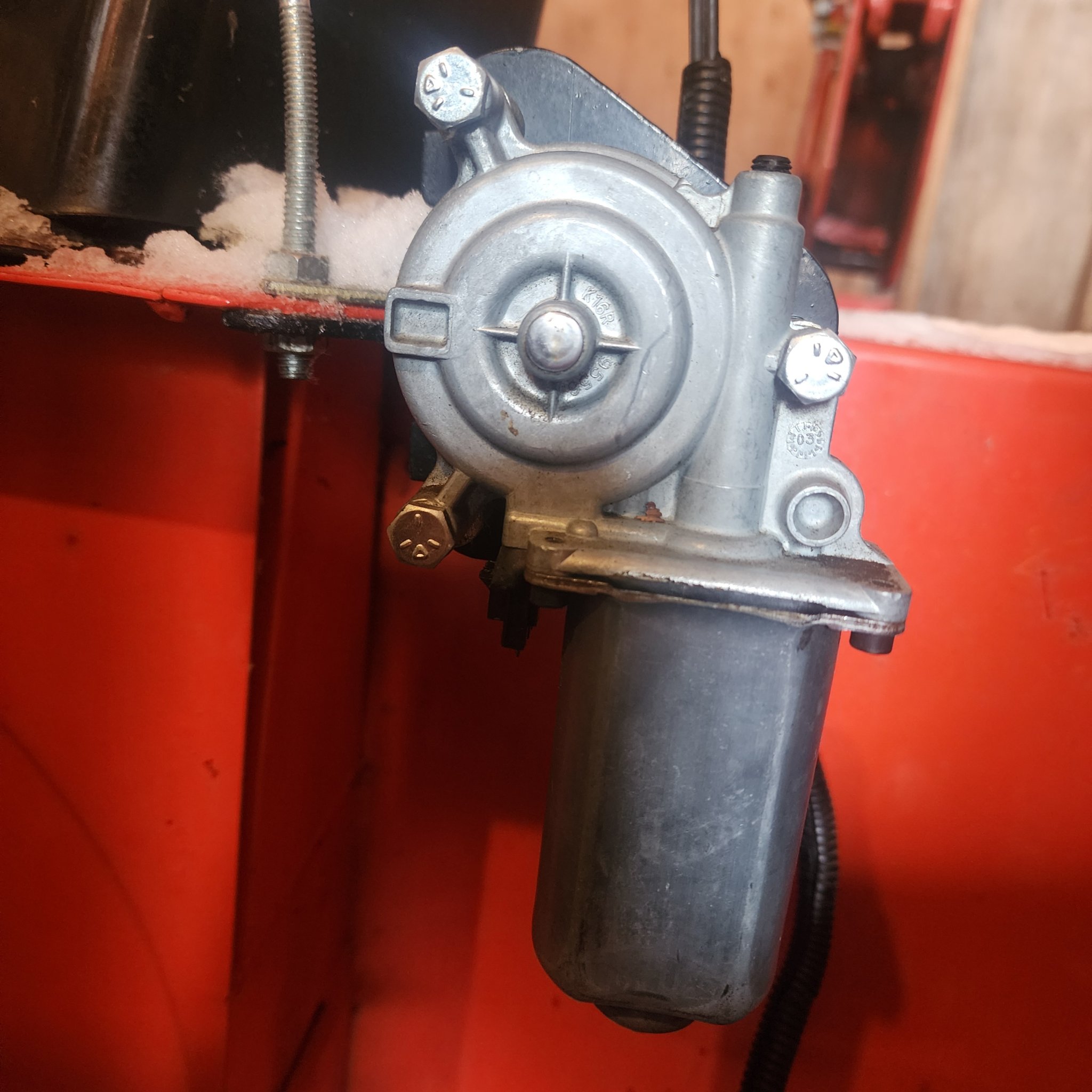

Of course, but with the shaft clipped onto the pto its nowhere near the spline on the snowblower. I'll likely just take it to the machine shop and have them extend it to the proper length. Itll cost another couple hundred dollars and turn it into a $700 pto shaft. But atleast itll drive this snowblower i bought a week ago. Then onto the electric tilt and swivel that Im getting power to and arent operating. I guess I shoulda had him hook it onto his tractor and see everything working bfor i bought it. Its in nice shape, everything turns smoothly by hand, not a total wreck. Just need a pto shaft, and here I am a week later $4000 in and theres still alotta snow in the driveway.

Looks like you're about 8 inches short. I see 6 inches between the end of the slip yoke and the end of the splined shaft plus you'll want about 2 inches of spline engagement.
What's the total length of the splined shaft? I know those can vary quite a bit.
