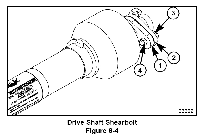

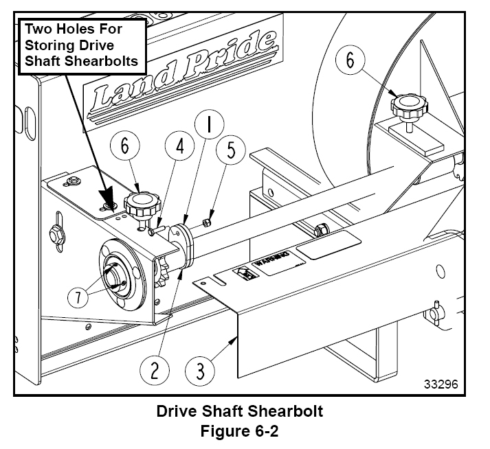

There are typically two shear pins. One on the PTO shaft i.e. between the pto output shaft of the tractor and the blower gearbox, and one on the output shaft from the gearbox that drives the chain gear. You shouldn't be able to turn the auger much at all before you get significant resistance, unless a shear pin has broken. If you're turning the auger and pto shaft is turning then you probably sheared the pin on the pto shaft.

Not sure what model you have but here's the location of the two shear pins on my SB1574. #4 in both drawings. The shear pin is right after the coupler that slides over the input to the gearbox on the blower. Sorry for the initial error.

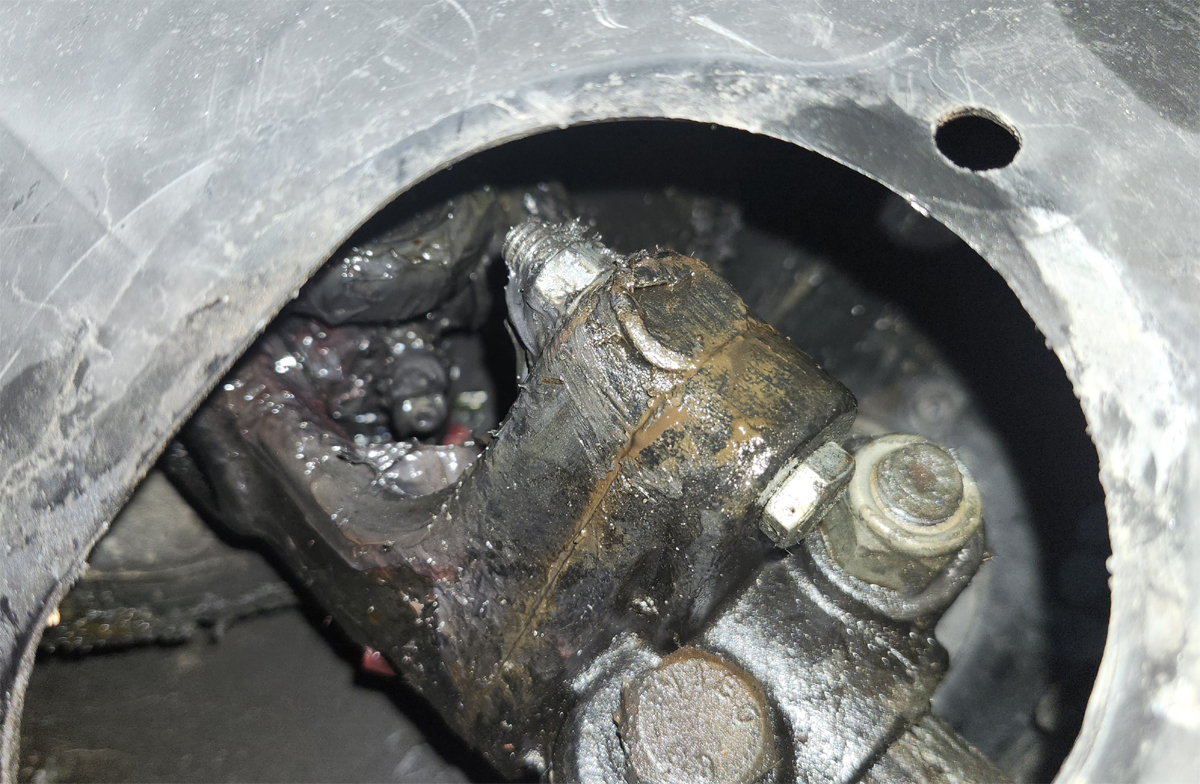

Here's a photo of the shear bolt and the u-joint at the gearbox of the blower, but looking more closely, if this bolt has failed then the PTO shaft shouldn't rotate. I bought the blower used four years ago and have never had to replace a shear pin, just greased the u-joints and lubricated the chain. I need to replace the gearbox oil once winter is over.

If both shear bolts are ok, then it might imply a damaged PTO on the tractor. I sure hope not, but check these two shear bolts first. It's always possible that someone stuffed a grade 8 bolt in where a shear bolt should be used.
So when you fire up the tractor and engage the PTO the blower auger's don't rotate, but with the tractor off you can easily rotate both augers and the PTO shaft by hand? If that's the case it might be worse than just a broken shear pin.

You're probably right. Hopefully it's the shear pin at the PTO shaft u-joint closest to the gearbox. You can pop open the "windows" on the plastic housing and get to the shear bolt. See photo above.
