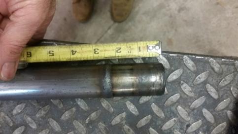

Last evening I took the safety covers off my old driveshaft and found a few things interesting. My old driveshaft has a rectangular slip joint but only about 2 1/2 inches of the female section are rectangular. driveshaft.jpg
The old driveshaft slides just over 3 1/2 inches together giving me complete engagement. I have always wanted 8 inches of engagement however not sure it matters in this case.
The second item is both the fixed shaft I just picked up and the old female shaft have the same tube making it easy and cheaper to have the driveshaft lengthened at the driveshaft shop.

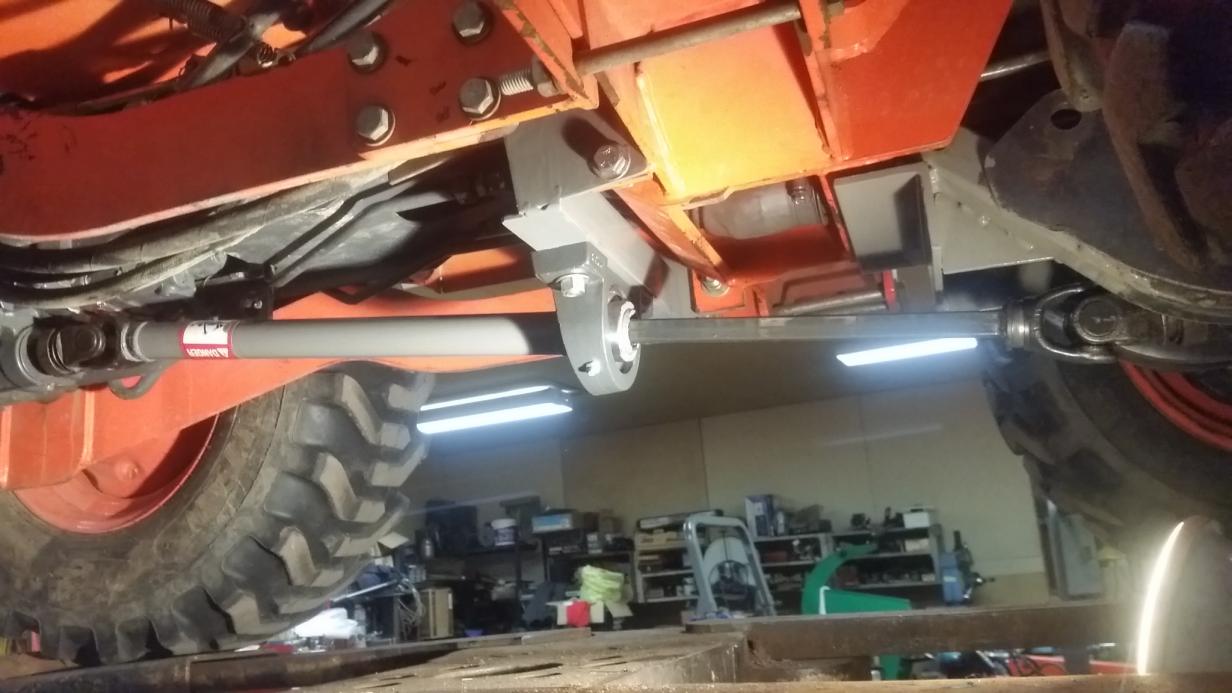

Finally hooked up the snowblower without lengthening the original drive shaft. There was a fair amount of vibration in the length of the mid driveshaft but since the cover was reinstalled I will have to remove the cover and test it again. If there is still vibration I will look into installing a center support bearing or bringing the driveshaft and having it lengthened.

Adding a center bearing was cheap and easy. I used a 1 1/2" self centering pillow block bearing purchased locally. The bearing slid snugly over the end of the driveshaft and had 2 set screws. The support is bolted to existing holes in the loader frame.
