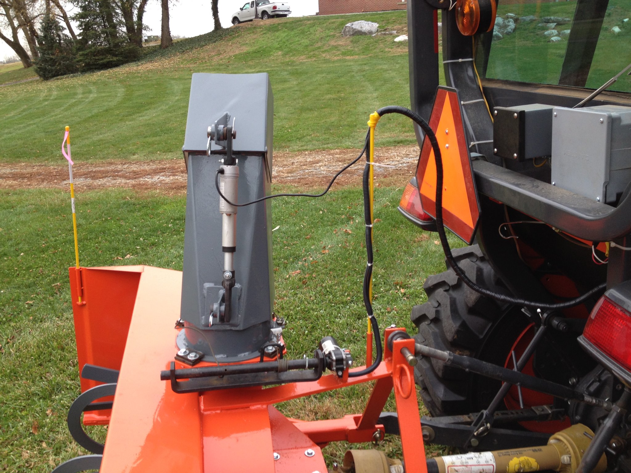

You'll find several different ways to do it. Here's my method for the L3200 / Pronovost setup I had. A small motor to rotate the chute via a slightly modified crank and a linear actuator to raise and lower the discharge. One DPDT switch for each on a cord that dangled in the cab.
Action shot:

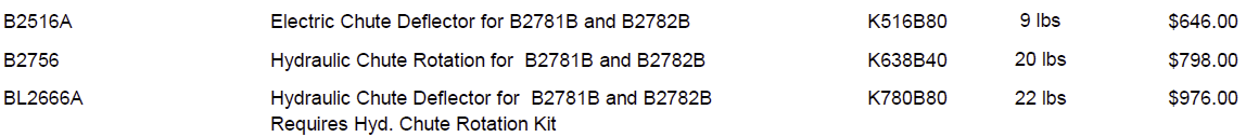

This is wholegoods pricing from 2021- today's pricing will be different. Wholegoods is purchased through Kubota sales, not the parts desk.
