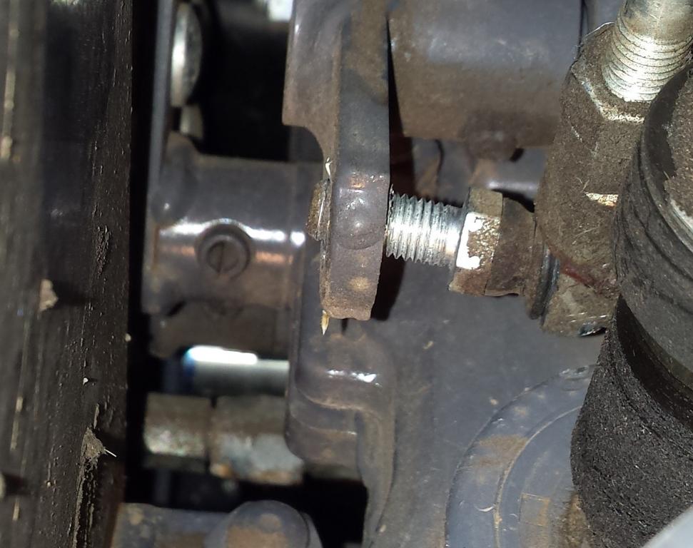

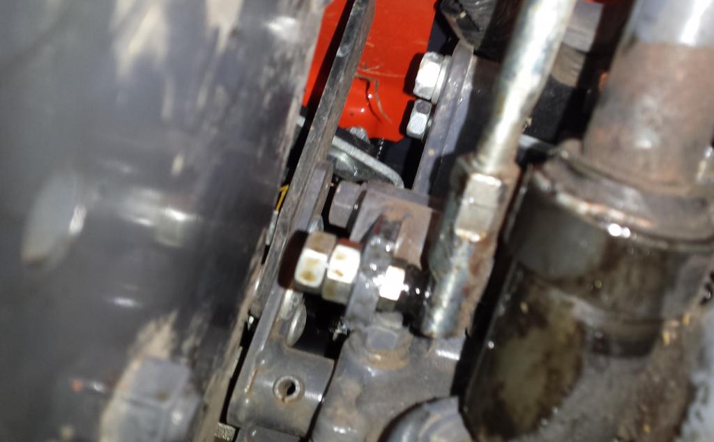

Found another thread about a nut falling off of pedal linkage and discovered that is what I have. Now trying to find out nut size to get.

Post up some pics in the area of the lost nut so others that may run into this will know where to look.

Here some pics from the other thread. I did it without taking off the filter, just took awhile
Cool thank you for the pics rotaryjohn! That will definitely help someone..
