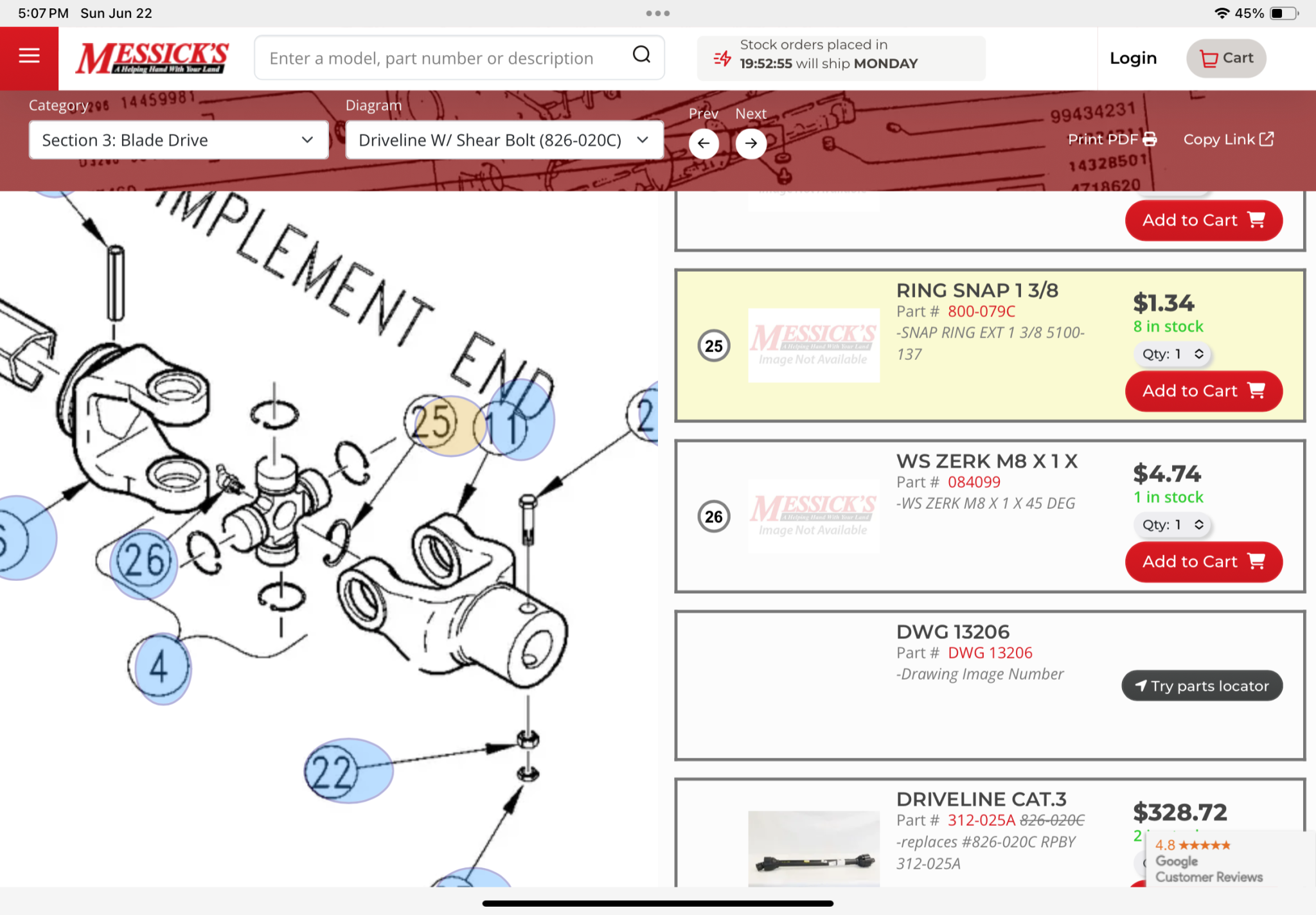

I looked at parts lists of your mower and am confused to say the least.
The gearbox shows a groove for the cir-clip!
The driveline for the shaft with only a shear pin (shown below) shows the cir-clip required.
The same driveline with the slip clutch and a shear pin does not show the cir-clip
But you should be able to push yours back and see if there is one there, if you can move it at all.

Yeah. Can’t move it at all. And I did note in the manual that it shows no clip. Assuming the safety chain is the fail safe in that scenario.
