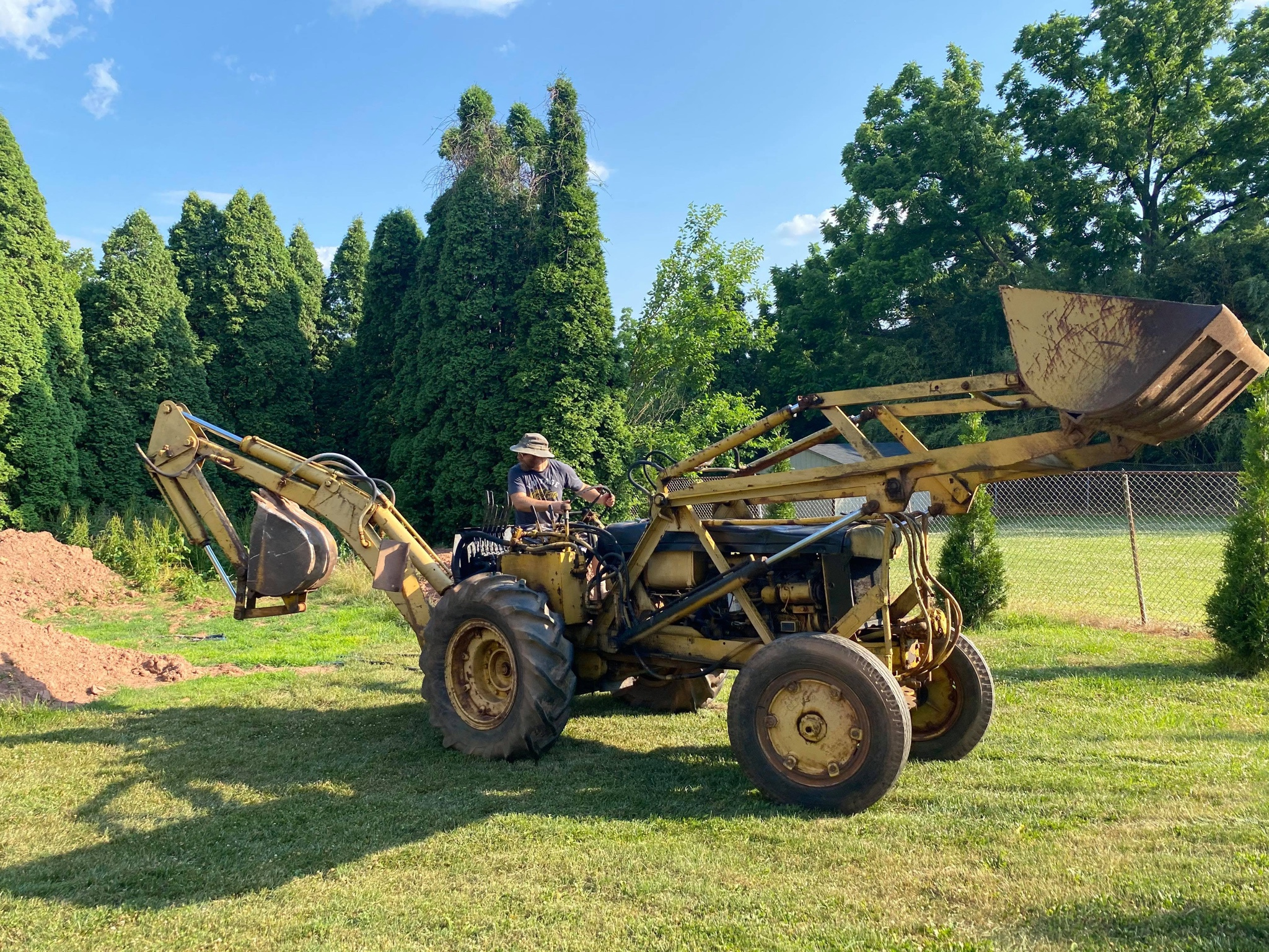

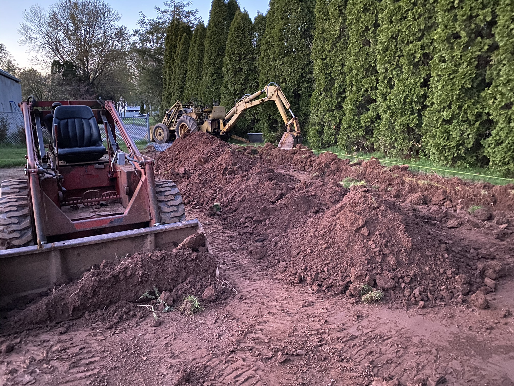

I needed a tractor with loader with power steering and a better lift. But I am cheap, so i spent along time looking. I needed to lift dirt and load it into the dump truck when building my shop.
I got lucky and didn't even know it. A bobcat 610 came up and I bought it. I have tractors, with loaders. But the bobcat was unlike anything i'd driven. I could turn on a dime. Insanely maneuverable and virtually unstuckable.
That being said, I still need a tractor with loader, 3pt arms, grading blade, cab, tiller, plow.
It's not a tractor or a skid, it's a tractor AND a skid. They have 2 different functions. I'll drive my tractor to the store, to the field, i'll do tilling and farm work. A skid is more suitable for construction work, pivoting around the bucket or pallet forks. Sure there are other attachments, but those are the main.
Some things i'd rather do on my bobcat, some are more suitable for tractor.
Get both.
