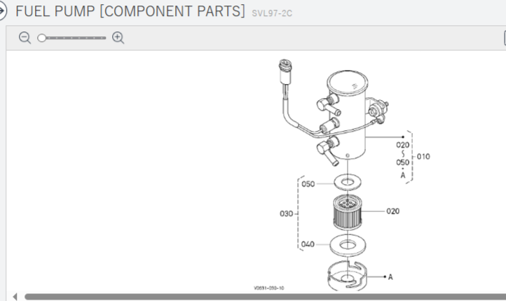

They are saying that the fuel was bad and stopped up the filter in the water separator, disallowing fuel to go beyond there. But if there is a filter in the filler pump, my theory is, it would have to have no fuel in it then.
When a water separator filter becomes plugged, the fuel stops flowing, it does not just disappear.
The mechanic did not take off the filler pump "lid" or inspect it, unless he returned the previous dirt back on it aftwards. He says there is no filter. Others say there is. Kubota has said both.
Unless someone has changed the electric fuel lift pump, there is a filter in the pump.
How/where has Kubota said both?
Every Kubota SVL95-2 and SVL97-2 was manufactured with a filtered electric fuel pump.

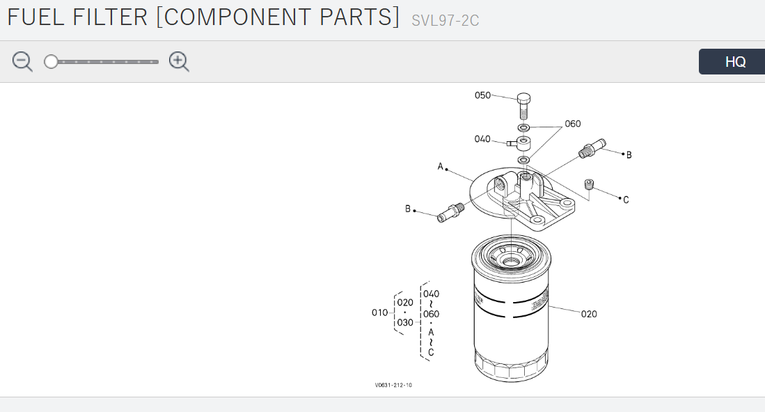

Ok you have thrown me a little with terminology / verbiage. This is no way meant as an insult or bash on you. Very possibly because some mechanic / dealer is telling you these words. Filler pump to me would mean the fuel station or holding tanks filler pump and filter. I think you actually mean the units electric fuel pump( first picture). It looks like that model has 3 filters: Electric fuel pump (commonly called the lift pump), cartridge filter. One separator cartridge filter, normally used for large debris and water (if water was involved it should have sent a warning to the operator). And a spin on filter for final filtration. If they are saying the filter was clogged, and bypassed debris and contamination did they show you the filters? I most certainly would like to see that proof of contamination. I also would have thought they would have done a fuel quality test or at least kept a sample of the contamination to show the owner of the unit, that's what I would have done.
I can understan the confusion with the terminology. I am using the mechanics words. They gave me (the separator filter, after some problem locating it), said it absolutely did not have a filter in the electric fuel pump (glad to know the correct terminology, thanks), and could not locate the remaining filter. No testing of fuel, and flushed the unit with their fuel. thanks for the response, this has been a difficult situation to deal with. I wasn't really at a point in my life where I wanted to to stop and learn AND actually try to understand how a diesel engine works. Any insight is greatly appreciated.

After much debate with the Kubota dealer, it was deemed covered under their warranty. It took a long time and I had to keep going back and forth with the mechanic, but they finally agreed that it was the injector pump that failed and not due to bad fuel. The mechanic wasn't aware of the filter in the pump that draws the fuel, it was clean, so that helped prove the point. What was really the savior was that I finally got to management with the problem. The manager turned things around did his homework, and looked beyond what the sales team and mechanics were willing to consider as the problem. There were some internal changes made to their dealerships after it was over. My advice....do your homework,, read the fine print, hold your ground, be nice, and very patient. And ask these guys for help. Thanks everyone!
