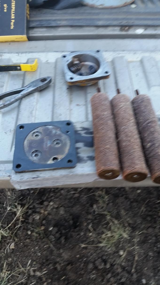

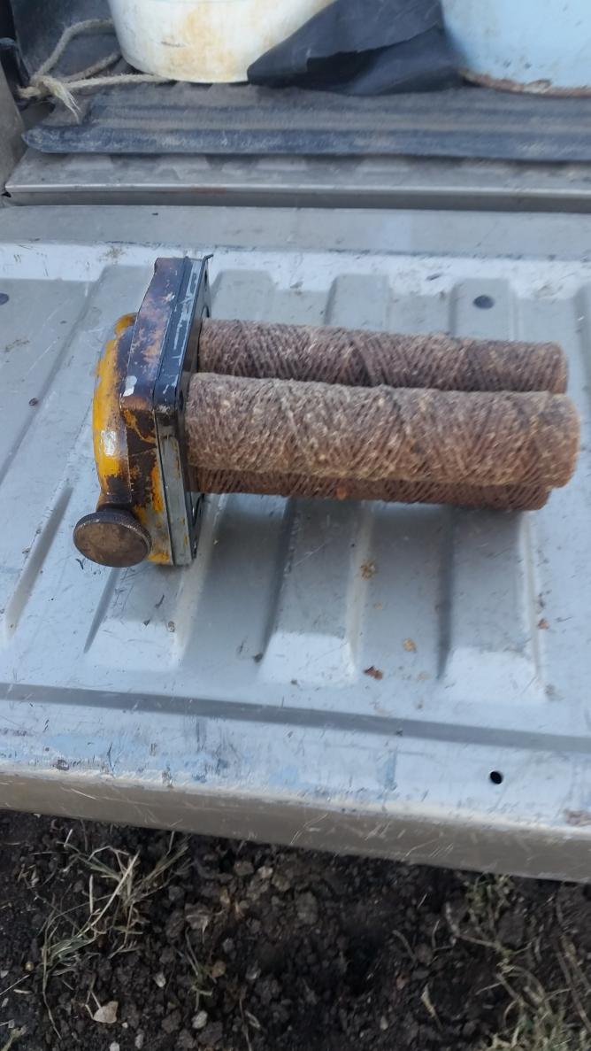

Was thinking I need to get this thing fired up before winter to make sure the steering clutches are not beginning to get bound up. Installed new fuel filter elements (3 reqd) and new fuel. The old fuel smelled like varnish, but it still ran on it!!
Kind of interesting. It's a 1951- D2 5U, ser. # 8791 and I found a Caterpillar original fuel filter kit.

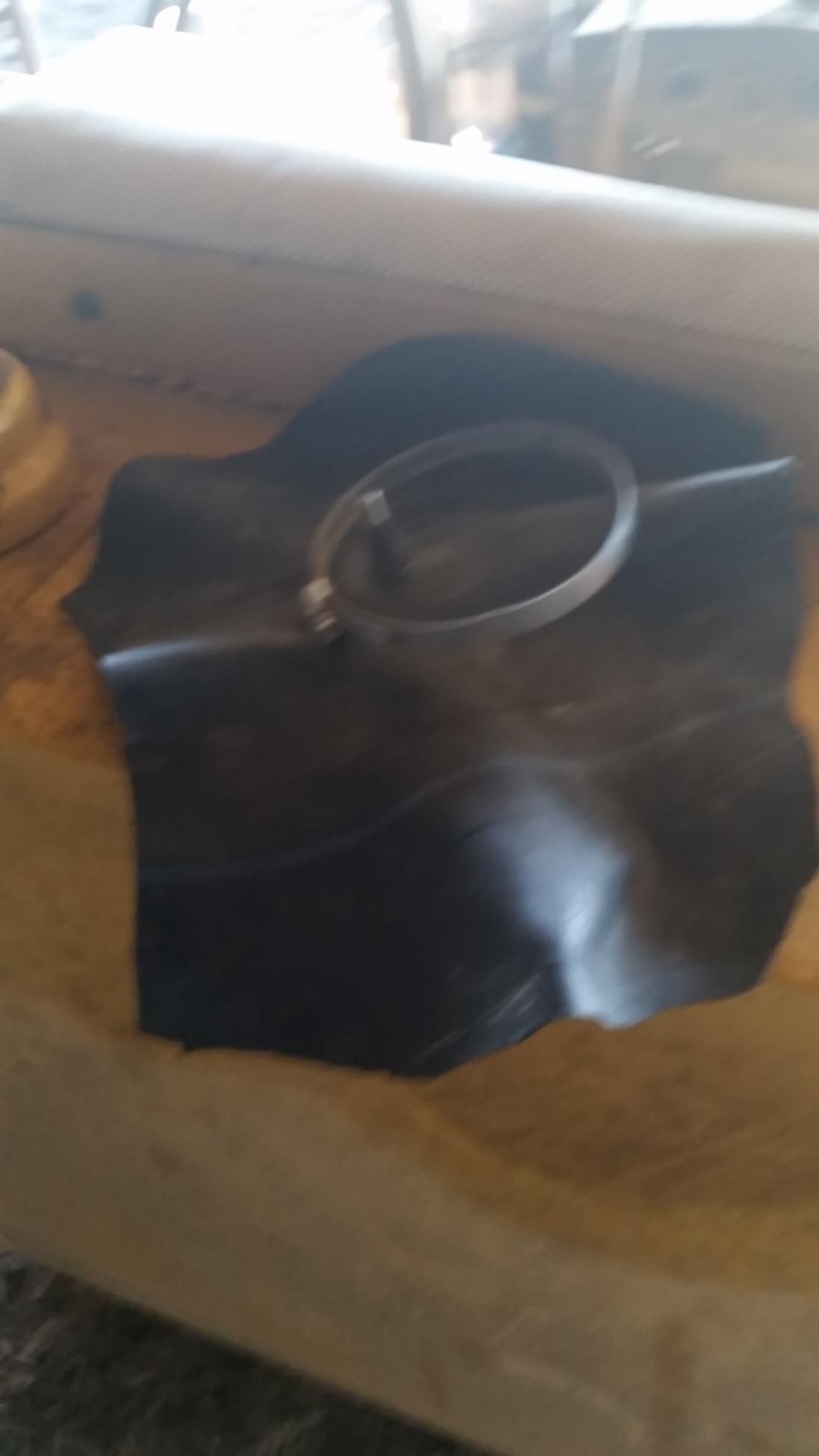

Here's how you prime your fuel system of all the air without using any battery power.
The fuel cap is about 4" in dia. and unscrews and the threaded part sticks up above the surface about 1/2".
So I get an old automotive inner-tube and cut a circle about 12" in dia and the valve stem is in the center of the circle. Put the valve stem in the center of the fill hole and put a screw clamp over the tube and around the 1/2" part extended up.
On this machine I open up the bleed valve on the filter tower and apply about 5-10 PSI to the valve stem. When fuel comes out the bleed valve I shut it and loosen the nuts at the injector delivery valves. Apply air again, and soon fuel comes out at the valves. Tighten the nuts.
Fire it off!
Pictures are a little dark, but you can get the idea.

Those filters ARE like a spool of yarn. 7 3/4" long, 1 3/4" dia. with a 3/8" hole in the center. NAPA wants $60 each, and not in stock. OReilly wasn't too interested in trying to cross any numbers.
Went online, found that original filter kit with the 3 filters and 2 gaskets for $30 plus $10 s/h. Had them in 3 days from Calif.!
