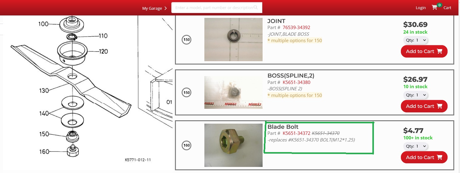

M12x1.25 dealer only item. An inexpensive part too....
