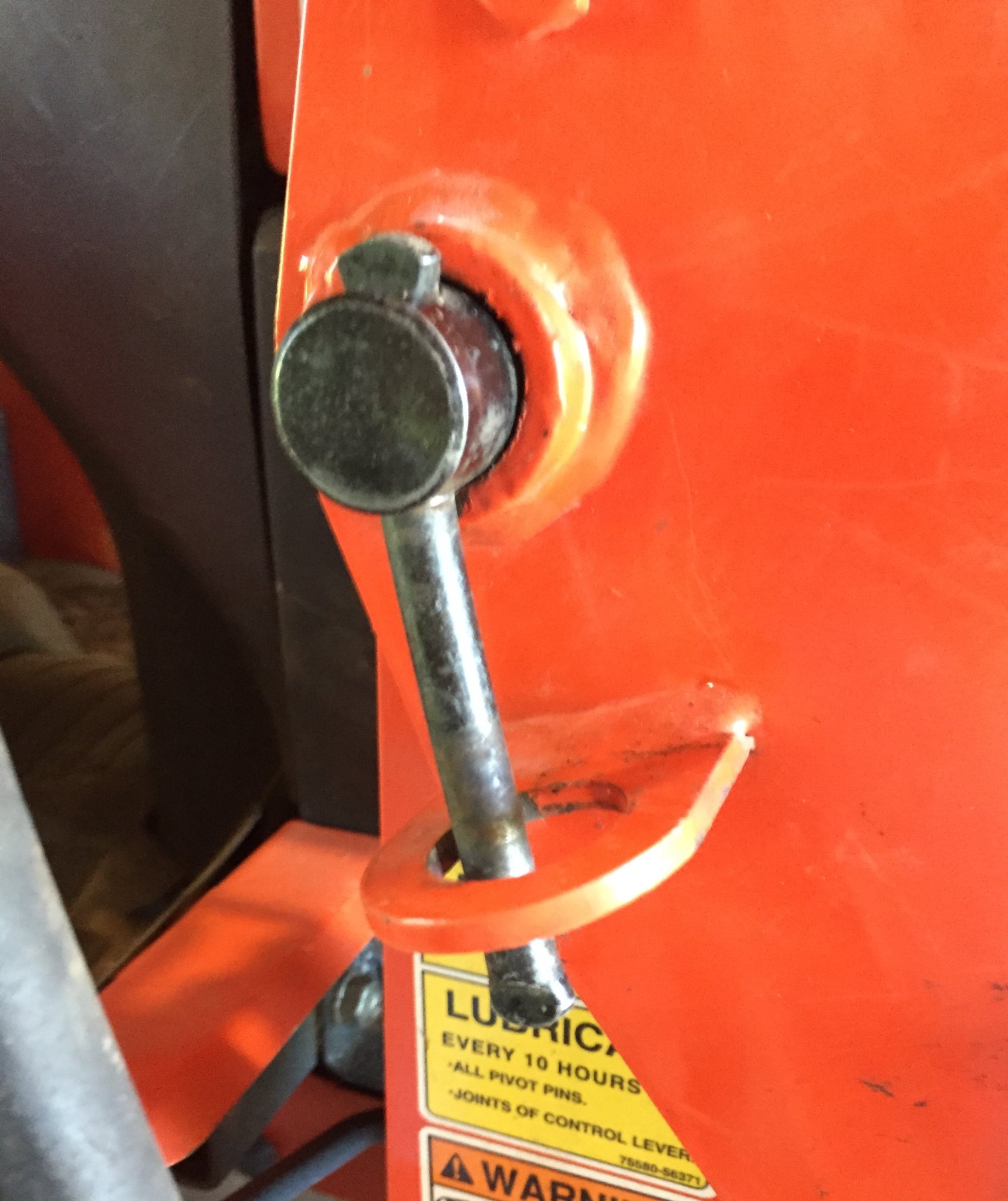

Had a serious pucker moment on Monday, so I decided to add to this post. The other day I was moving some concrete slabs with forks on the FEL. As I was stacking them, I had the forks at max height (fortunately empty), when I heard a creaking sound and it wasn't a good creaking. Discovered that one of my FEL frame mounting pins had fallen off. Couldn't lower the FEL, because they wanted to twist across the hood, so pulled up to a tree and rested them (at full height) against the tree to support them in proper alignment. I lucked out, the renegade pin was not under the pile of slabs, so I found it and reinstalled it.

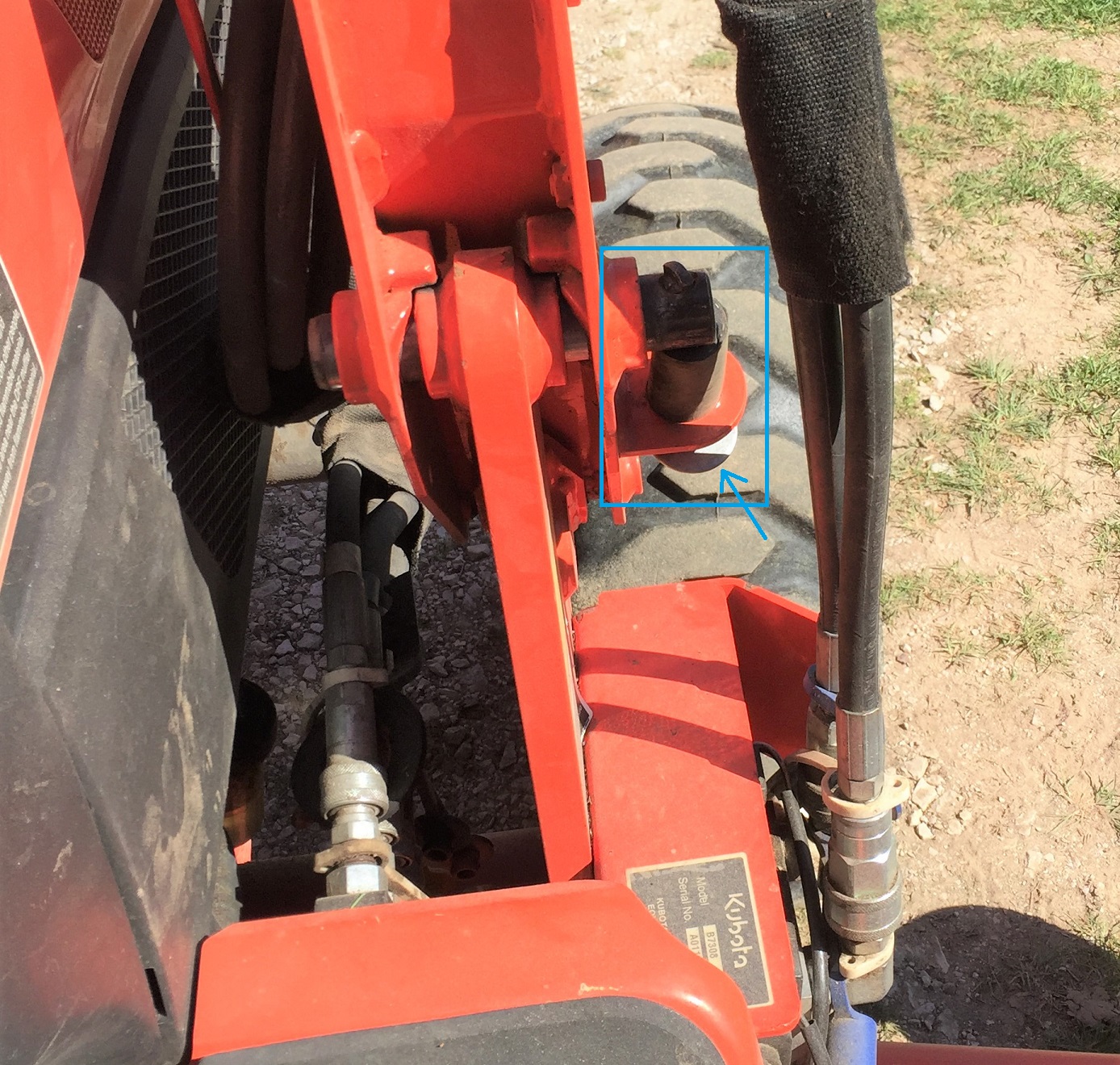

After my slab cleanup and hopped onto OTT to look for a solution - never want that to happen to me again. Found the original post (below) and decided to tweak it a bit for my B3350. Photos show original pin, then mods. The hole for the retaining bar on the B3350 is much larger than the retaining bar - so there's too much play there.

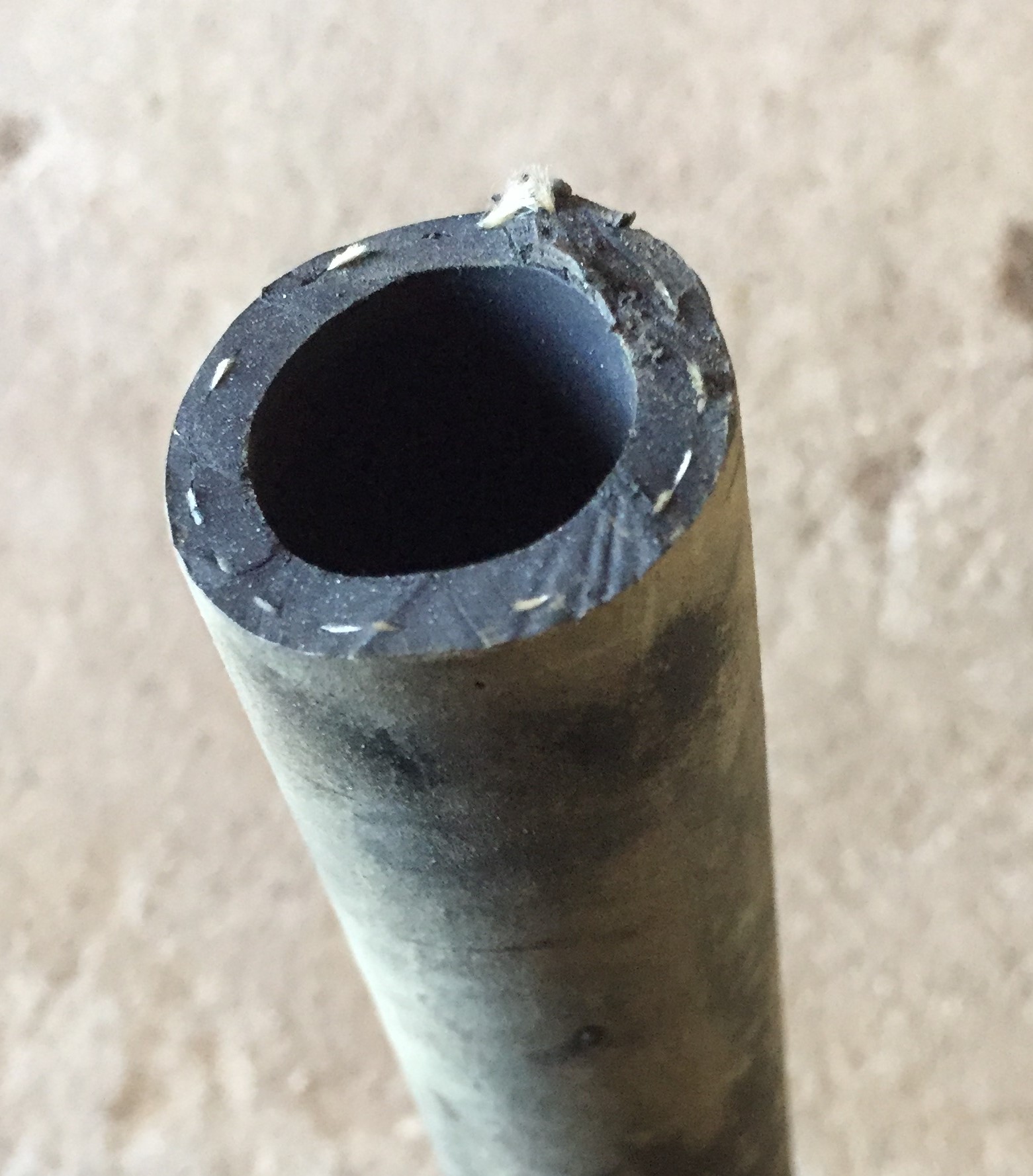

I cut 2 pieces of reinforced rubber tubing I had laying around (1" OD x 2.5" long) as inserts to eliminate some of the play from the oversized hole.
I drilled a hole in the flattened part of the retaining bar on the pin to accept a hitch pin.
I slipped the rubber tube over the lower end of the retainer bar, put a 1-3/8" x 9/16" washer under the rubber tube and then inserted the hitch pin to hold it all in place.
Now I can see the washer when I'm in the seat - if I can't see the washers on both pins, it's time to drive back to the barn.
