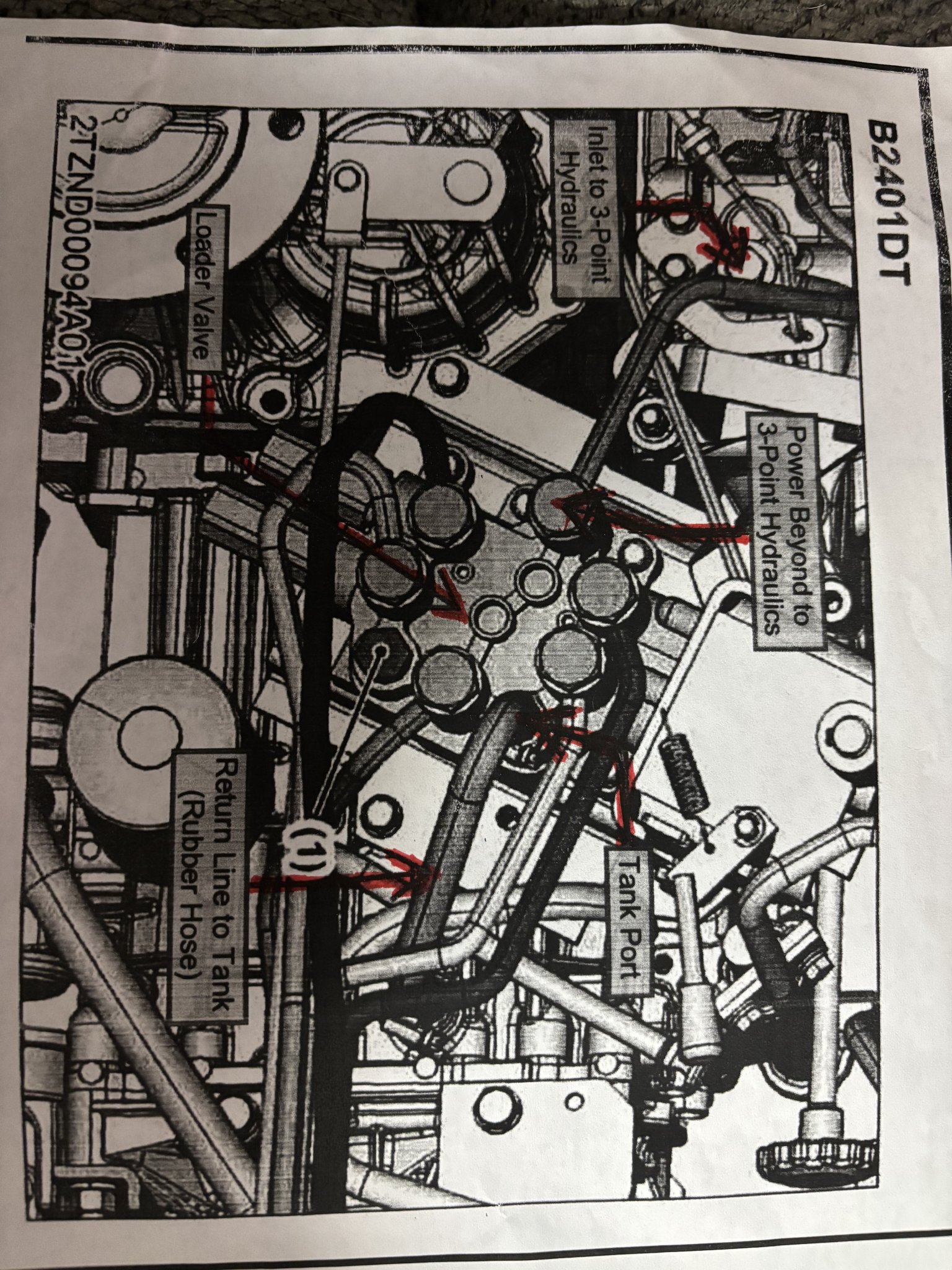

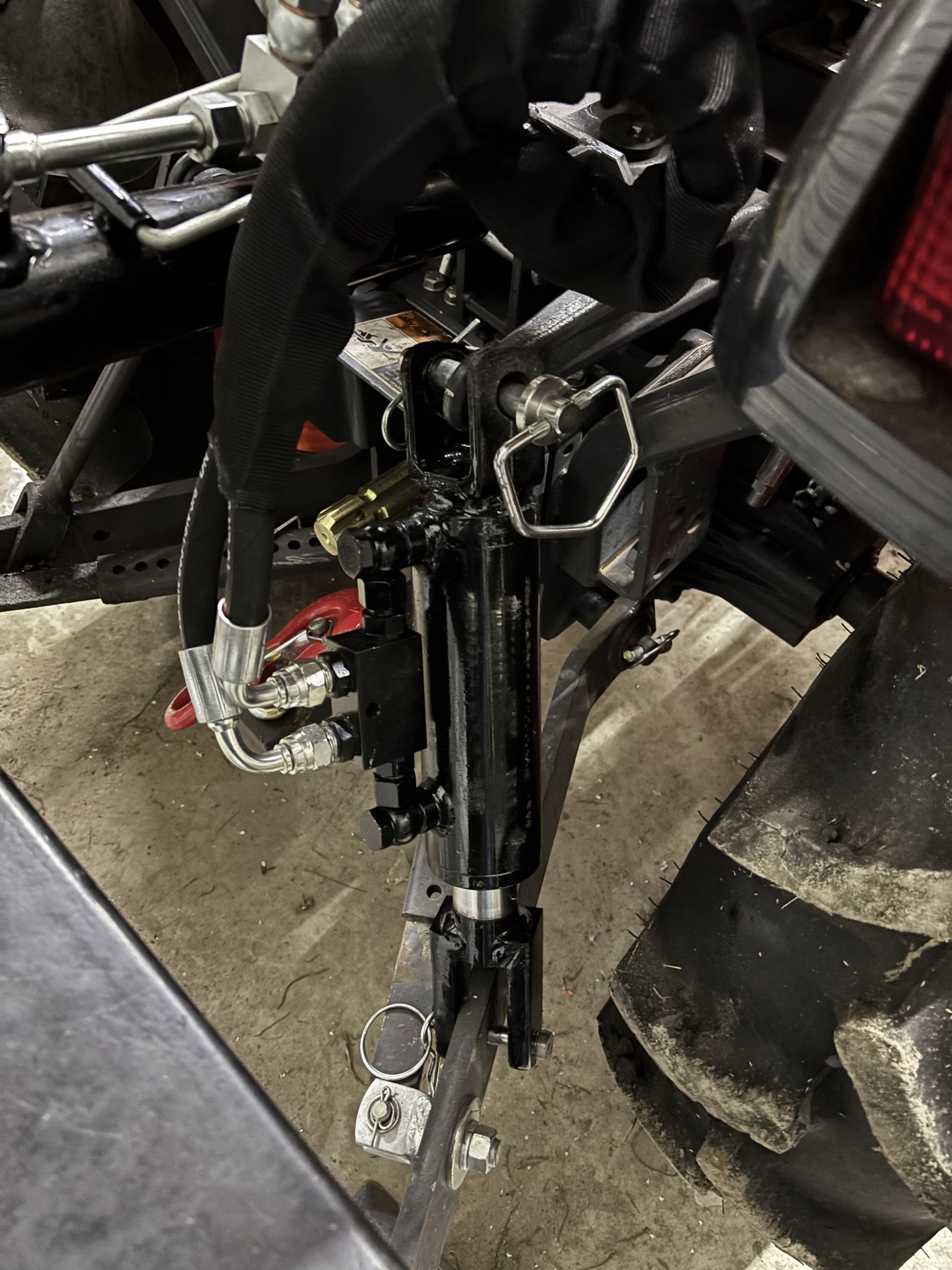

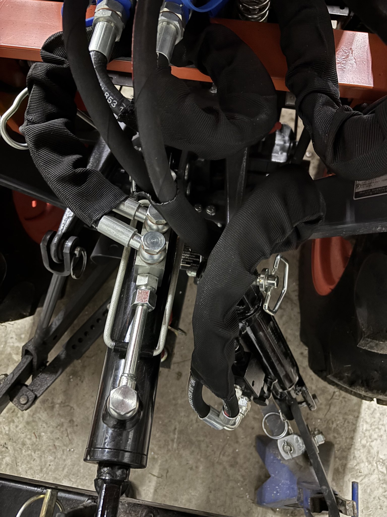

I was able to get the side link installed on the tractor today. I can’t get the testing done since I have to wait again on some more parts to be able to run the fluid return line and connect it to the fluid return underneath the seat on the right side. I have not decided yet how I will proceed with the connection of the fluid low pressure line to the tank! I need a little bit more assistance with the
choice of how it’s best to do it? I have been looking at the information that I received from a member, shows the loader value under the seat, it indicates the location of the different pipes and their purpose. I have been looking at it and comparing it to what I see on the tractor! With that, there is a bolt head in the lower right corner of the loader value. It’s marked with a line and the (1) but there’s no indication what it’s for! After looking at it and it’s location on the valve, I believe it’s a inlet for the low pressure fluid inlet? If someone can identify it for me please provide your feedback as it is very helpful and will keep me from making a costly mistake.
I will repost the picture of the picture and the side link installed.
Bolt head that I believe is a fluid inlet on valve
