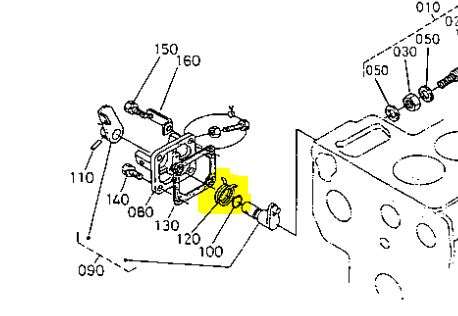

There is a spring internally that makes the lever snap back into the run position.

Thanks for the response with the parts diagram. Would that spring also make it extremely hard to pull out the shut down mechanism ? I suppose it would, if it is broken ?
Thanks, again
No not really, sounds like you have a bad cable and possibly a broken spring, or an issue with the lever and the cover binding, like corrosion.
Take the cable off the lever and see how easy it moves and see if it returns to run after to let off of it.

Excellent idea. I will try it when I am able to work on my machine again.You seem to be very knowledge of the machine.
On the inner end of the shutoff mechanism, there looks like a bell crank. It apparently activates something when rotated. Do you know what it might be ? ie valve, switch, etc. ? Being internal of the engine you cannot see unless you remove the whole mechanism.

The lever moves the Rack on the injection pump up against the spring loaded idle stop, and that cuts off the fuel. ;)
