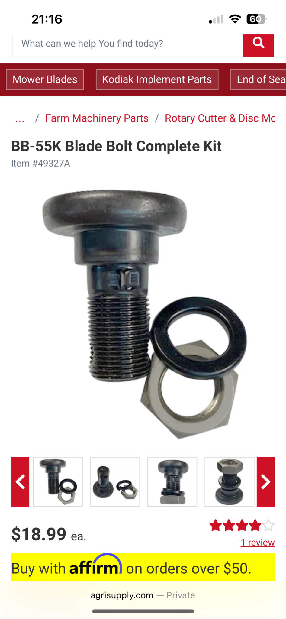

Typical mounting for shredder blades is with a shoulder bolt like this.
The shoulder of the bolt is a bit thicker than the blade so the blade will rotate freely on the bolt when the bolt is fully torqued.
