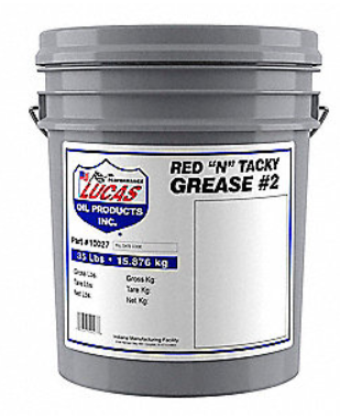

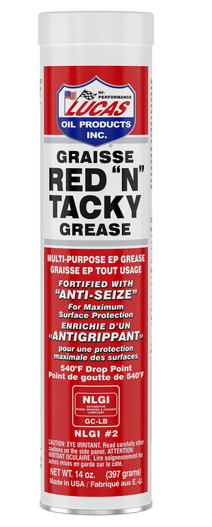

So this mornings coffee shop talk turned to grease especially in light of the cold temp's we experienced this winter.
General consensus of the Old Farmers Club was Lucas or similar Red and Tacky grease is very commonly used top shelf product. Good stuff. Premium product was well accepted. Very widely used in our area. Just about everyone of us have cases of this stuff in our shops.

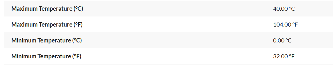

But what should a person do in the winter months. Rated down to 32F. On our farm we do nothing we use it even though temp's drop well below its spec min. limit.

so are these arguments foolish?
if Lucas gives spec. down to 32f should we be concerned when temps go lower?
should we ignore manufacturers spec's and use red and tacky even though their range stops at 32f.?
or this all a one big nothing burger and paying attention to ratings should just be ignored?
I decided its time for a nap and am calling this a nothing burger but those that like to only use Kubota fluids / etc.... might see this in a different light??

well that sucks..... I couldn't believe that red and tacky was only good till freeze point. This info. came from the data sheets of the large national oil distributor in our area and seems to be WRONG!!!
I found on the Lucas site where they say -30°F (-34°C) to 540°F (282°C) is the operating range.
So there you go.... our morning discussion was based on social media / internet information. Another reason why I think this AI craze is dangerous.
Perfect example of some stuff can be trusted while other not so much off the internet.

Both the wrong and right information were both from the internet. ;) AI like anything else is only a starting point.
Fwiw, Grok says the following which implies context matters. I guess we have to find out what that means next, wrt tractors. :D
However, the recommended operating temperature range varies slightly across sources, including retailer descriptions and some product variants:
  • Many listings describe a broad effective range of 0°F to 450°F (-18°C to 232°C), especially for the aerosol/spray version.
  • Other retailers and specs cite ranges like -15°F to 375°F (-26°C to 191°C) or up to 540°F for high-temperature resistance.
  • Some mention performance down to around -30°F (-34°C) in certain contexts.
The grease is designed for good performance in both cold (stays pumpable and doesn't harden excessively) and hot conditions, with excellent heat resistance, water washout resistance, and mechanical stability. It won't melt easily and holds up under heavy loads.
