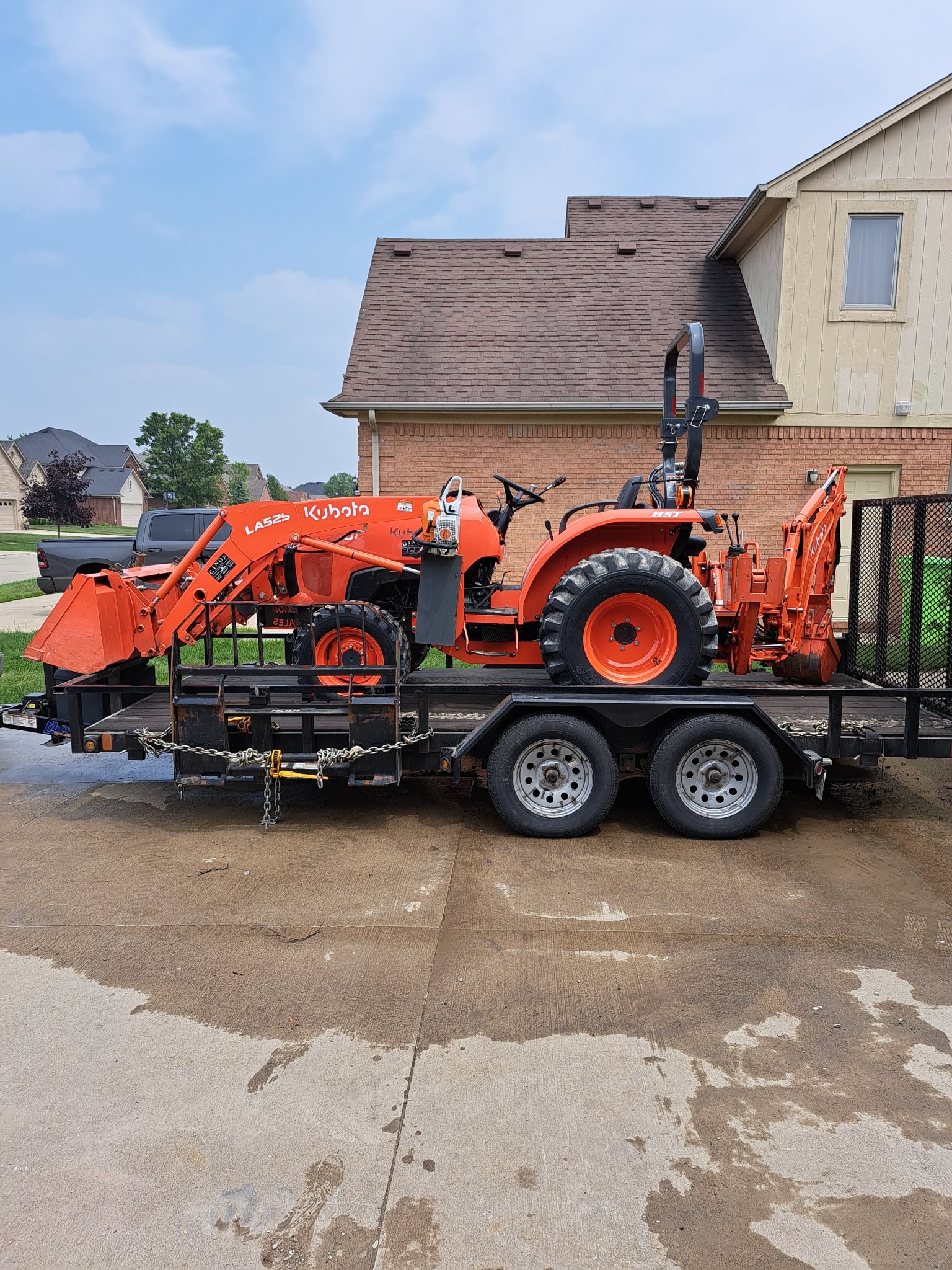

I'll chime in and say my L2501 overachieves at all the tasks you list including log & tree work
...BUT I have a separate rig & plow for snow removal.
