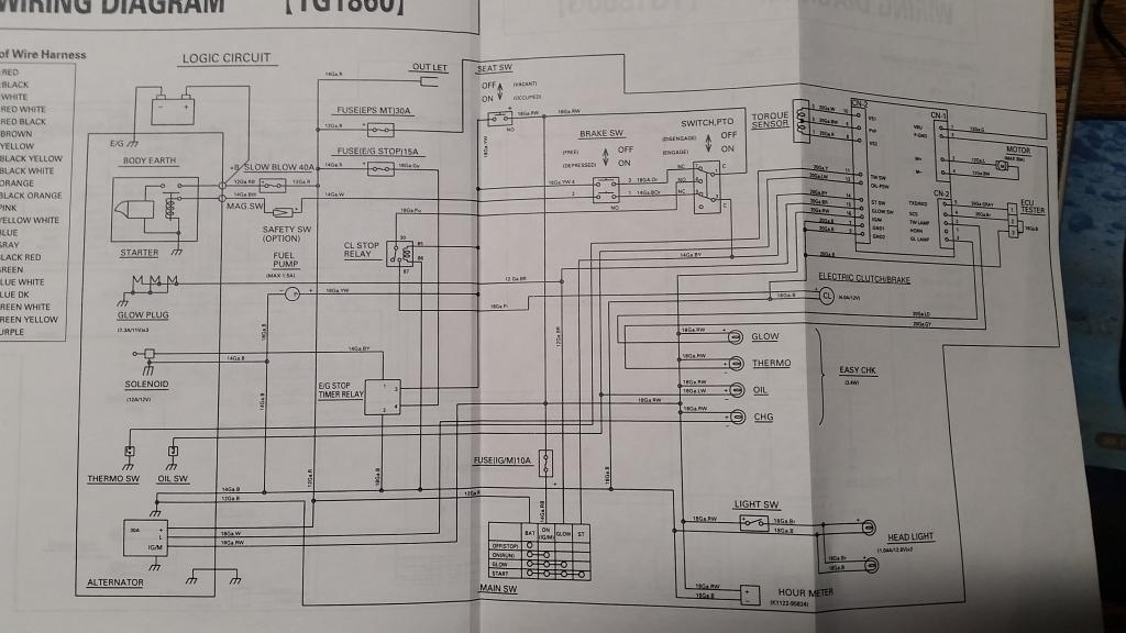

I need a service workshop manual for my Tg1860 diesel. I can not find one online for free and I do not really want to pay what the dealers want for one. I am wondering if anyone has purchased one from EManuel Online - the PDF version. Is it reliable for the download and is it as good as the Shop Manuel. Thanks

This is my first diesel that I have owned and want to learn more about it. Right now I do have a couple of electrical problems that a manual would help. Battery light never comes on but is charging. I have a loose white wire hanging which I do not where it goes. I know it is connected to the battery light. Also I have a starter button on my machine which I do not think belongs. I think someone has disconnected key switch start postion and probably bypassed solenoid. This is possibly problem with battery light also.

Thanks D2Cat. I see you also have Tg1860. Does your battery light come on as soon as you turn the key to the on postion and when you start your diesel do you use your key or do you have a push button start like I do?

The key is used to start the engine. No push button on it. The parking brake has to be set for the ignition to work. The battery and oil light comes on, I'm pretty sure. glow plug light comes on for a couple of seconds also. I'll have to pay closer attention, and let you know.
