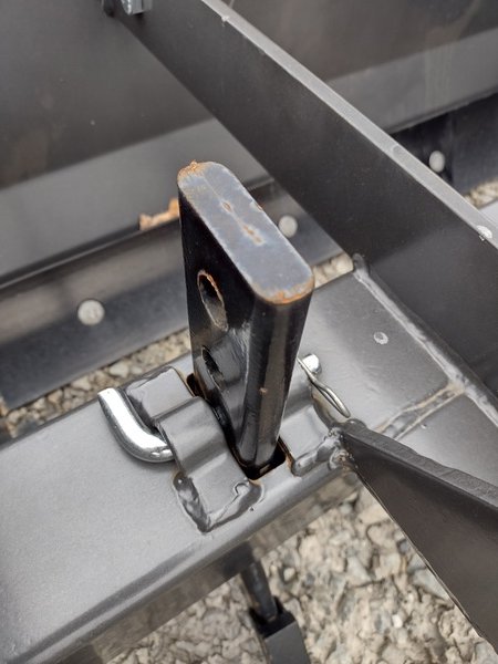

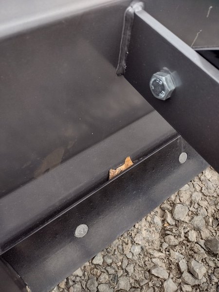

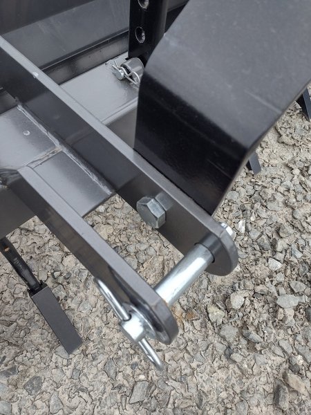

I DID IT! I selected and purchased a box blade ... the Braber BE-BBR4G.
Thank you to all of the people who chimed in to share their thoughts and experiences.
This has been a bit of a grueling week of information gathering. I'm glad it's over and that it appears to have led me to exactly what I wanted.
Details
  • $740
  • 4 shanks
  • 3/8" side plate thickness
  • 368 pounds
  • pin-style shank retention
  • clevis style for 3pt hitch connection
  • curved blade
  • gusseted
--eric
