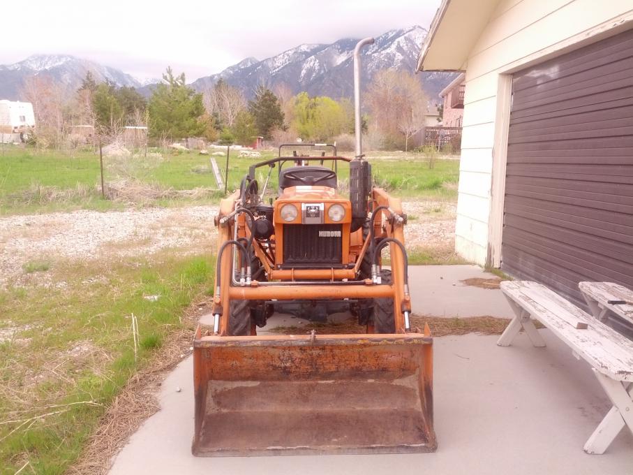

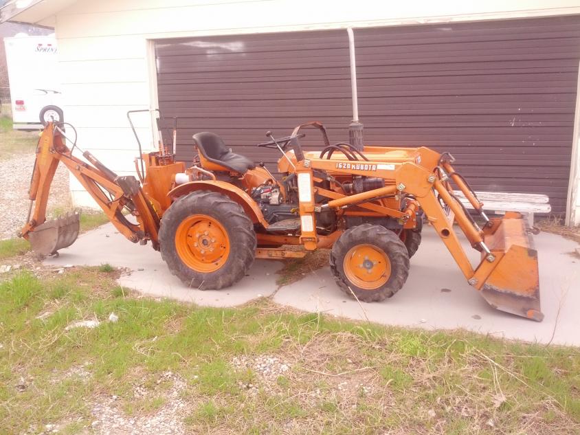

Hey all, I'm new to Orange Tractor Talks, heck new to tractors period. I Purchased my first tractor last week with the intention of finishing my yard, installing sprinkler lines ETC. I'm already getting the feeling that this tractor thing is addicting! FYI it started with a Craftsman 20 horse, and has grown into a B7100.
Anyway I paid 5500 for this guy used, I traveled a couple hundred miles to get it, there is absolutely nothing in the Salt Lake City area so I think all things considered it was a decent deal especially with the back hoe and the loader. Chime in and let me know what you think about the price and the tractor.
So there are a few issues that I need to work through on this tractor.
1st- the hydraulics on front and back seem a bit weak. When the bucket is lowered all the way, and I open the bucket more, I cant lift the front off the ground. Can someone tell me if this tractor should have the strength to do that? I'm going to start with the hydraulic screen/filter and clean or replace it
2nd- the bucket on the back seems a bit weak. I have had troubles digging underneath bushes and removing them. When I try and push it to dig something out that requires some strength, the controls make a high pitched squeal. I'm assuming this is a bypass. Are there O-rings that can be changed to prevent this?
3rd- I know this is no skid steer, but it seems when I try and get a bucket of harder packed dirt with the loader it moves on the frame an awful lot. Is that normal, and something to expect with a tractor, or is that cause for concern
4th- It does leak a bit coming from some of the hydraulic rams. In a weeks time I'd say it leaks a spot the size of a dollar bill. Some people have told me if it doesn't leak it isn't a tractor. What are your thoughts on this? Your advice and expertise are appreciated. I could post more pictures and possible links to videos if needed. Thanks in advance!

Not too bad I'd say! I have a B7100D as well. You have a loader that's different than factory so can't really say much about them. You may need to observe & inspect all the attachment points for missing bolts, cracks, bent parts, and such. The B217 (loader) that I have is known for its very beefy frame that runs underneath the tractor which it's attached to. From what you described, it seems like the seals are worn and the filter may need to be cleaned. Take a look at the link below regarding hydraulic filters in the articles.

From what I see you have the creeper gear option which was used with a trencher( the massive gear shift control ) also I would say all hydrualic power is from the tractor itself, not external pumps, so at 3 to 4 gallons per minute it not the most powerful pump, and with all that you have attached it would be slow, the only filter you would have is the one in the bottom of the rear end, the bolt should be painted light orange or red, make sure the fluid is hytrans and not gear oil, also when your using it wide open throttle for maxium pump pressure, and the sound you hear is the pressure setting in which you reached max lift capacity.

As stated earlier, your FEL is not the stock unit so I can't speak on it specifically, but you weren't real clear on where the movement is- if it is within the FEL itself, it's probably worn pins/holes. If it is the whole FEL moving on the tractor, stop using it immediately & look for loose, missing, sheared, or stripped bolts- that can lead to nightmare scenarios with stripped holes in the tractor, broken bosses, etc..

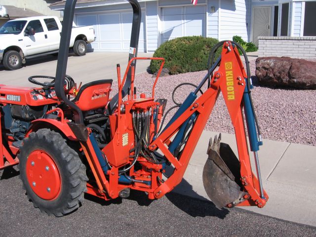

The backhoe is a B670, here is a link on a couple of guys doing complete rebuilds on the same unit.
http://www.orangetractortalks.com/forums/showthread.php?t=5482&highlight=b670

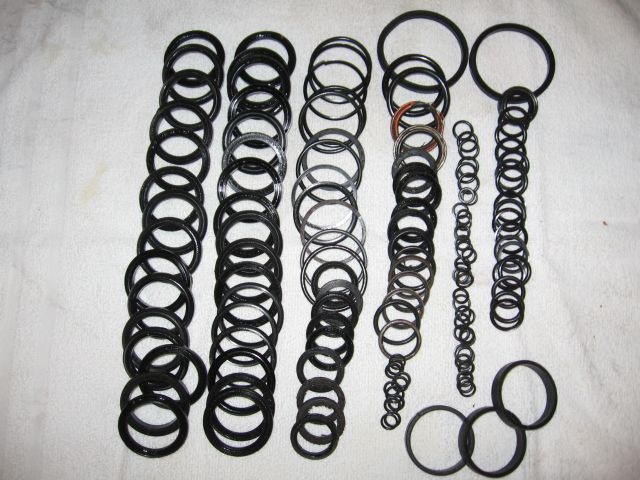

You asked about o-rings- the 1st pic is all the o-rings & seals in the B670 (only) rebuild.

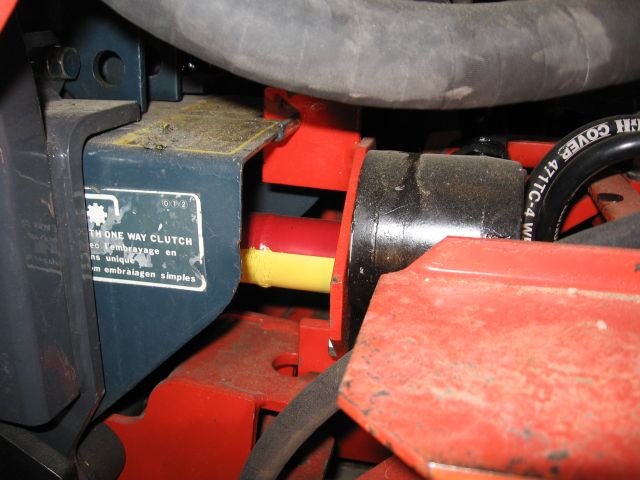

Pisby- The PTO speed may be all the root of all problems with the backhoe.
The previous owner of mine had hand written notes from the original owner, containing his instructions from the dealer upon delivery. They state "Run the PTO in the highest speed when operating the backhoe." Mine is a 1979 and to my knowledge the backhoe has never been run in anything but the highest PTO speed. As I said earlier, at least 1/3 or more throttle. I don't know where the PO of your tractor got his info, but judging by the performance of mine,I doubt you get anywhere near enough pressure or volume running in the low PTO speed to operate correctly.
Your PTO pump doesn't look like the original style (kinda hard to see), but the chain setup is definitely not original. (not saying it won't work, but....)
On page 4, post #39 of the backhoe rebuild thread I posted earlier is a set of pics of an original pump. (which I now own)
Below is a pic of my pump & mounting setup- the pump is black, the mounting bracket is orange, & it has two vertical "ears" which key in corresponding slots in the trailer hitch (orange) & the PTO guard (gray) The red & yellow part is the PTO to pump coupler. Maybe the reason you were told to use the low speed is that the pump mounting setup is too weak or sloppy to take higher Rs.
