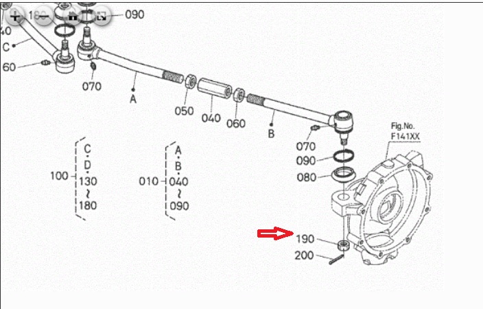

Please look at the photo I attached. If the problem is identified by the red arrow then:
I suspect your difficulty is that the tie rod tapered piece is rotating in the knuckle.
Get a piece of wood 2 x 4 and find a way to press down using some significant leverage on the top of the tie rod while tightening the nut.
To align cotter pin holes with the castle nut slots, you always tighten more never loosen.
If I have not understood your issue, then a more complete description will help you get a solution.
