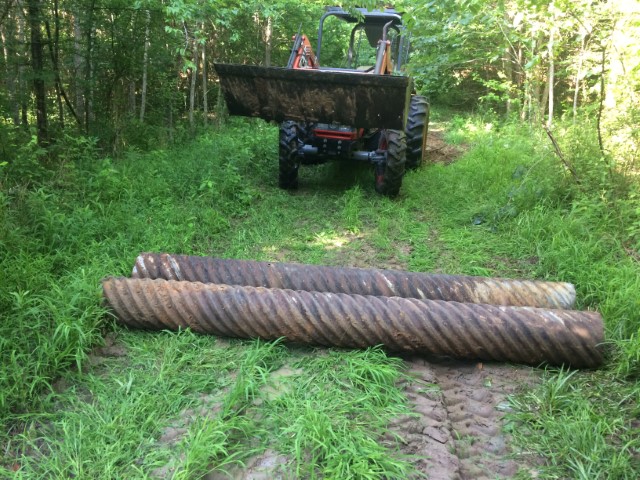

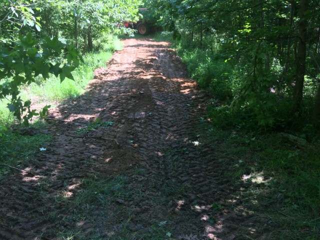

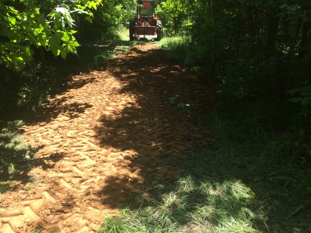

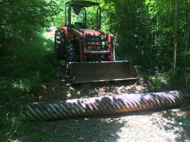

I had a very similar situation and solved it with old culverts laid on top of the ground which were then covered with dirt.
This was done last June and now has a rainy season behind it so the fix was successful.

Mine is actually two culverts in one location and one in two other places for a total of 4 culverts. All of the runoff was on the surface with no actual "stream bed" so I picked the lowest and wettest locations to place the culverts.
I turned a muddy mess into a high and dry situation. I have another similar wet spot that I will tackle this Summer in the same manner.

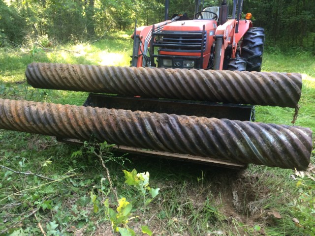

My culverts shown above was a 30' that I cut into three 10's with a cutoff blade on my skilsaw. The 4th culvert was a section of 8" PVC. After a downpour the heavy runoff still goes over the road, but that was never the problem. The culverts eliminated the wet swampy spots which were the ongoing issues.

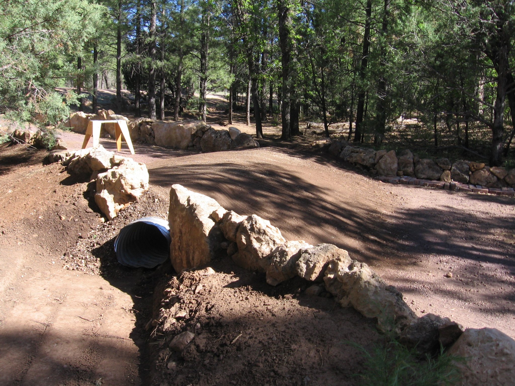

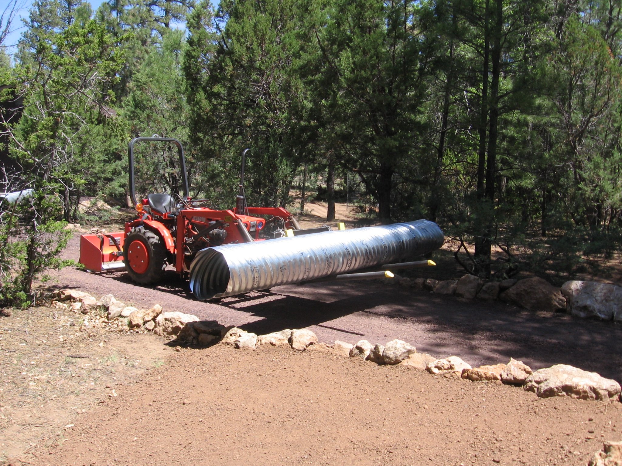

For me, it was a few reasons.
One squashed pipe was cheaper than two round ones of similar flow.
The squashed pipe was not as tall, requiring less material to raise the driveway to cover it.
The squashed pipe flows more water at 1/2 full or less than a round one of the same size. (above half full, the flow rates are virtually the same)
The pipe vendor modeled it on the computer to show me.
7,577
2,636
Oops, forgot the pics:
