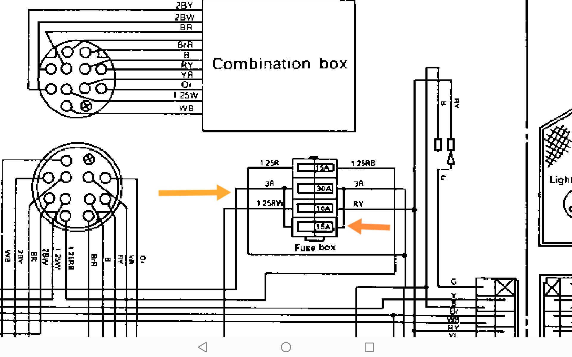

And I found a scan of newer schematics with the internal voltage regulator in the generator. Even better.
But now I am confused, the schematics shows 4 fuses, matching my tractor. But as far as I can see the fuse number 2 (30A) and fuse number 4 (15A) are in parallel. Do I see that correctly? Is that Kubotas idea of a 45A fuse? This makes no sense 🤪

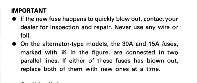

Found a remark in the operators manual. Indeed, Kubota connected two fuses in parallel. This makes no sense whatsoever. Is there nobody here that can explain what they were thinking (or not)?

Gonna be interesting to hear why they're in parallel !
I had asked in another forum and the consent was:
1. you don't do those kindof things
2. It was probably done as an afterthought
The original dynamo had only 150W and a 20A fuse. The newer alternator had 480W (!) and hence delivered 40A. Not sure if 40A fuses were around at the time, maybe 30A was the highest. So the fuses kept burning and 50000 tractors assembled already and a quick fix was required. Another 15A in parallel and it'll be fine. Pure speculation, of course, we will never know unless a Kubota design engineer reads here and provides the answer.
