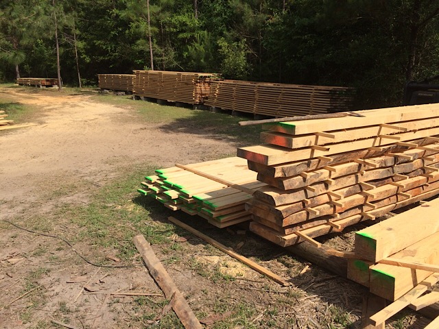

Here are the first logs before sawing began:
I sawed a bit over 7 thousand board feet of mostly 2X6 & 2X8 framing lumber from them last week in 3 days.

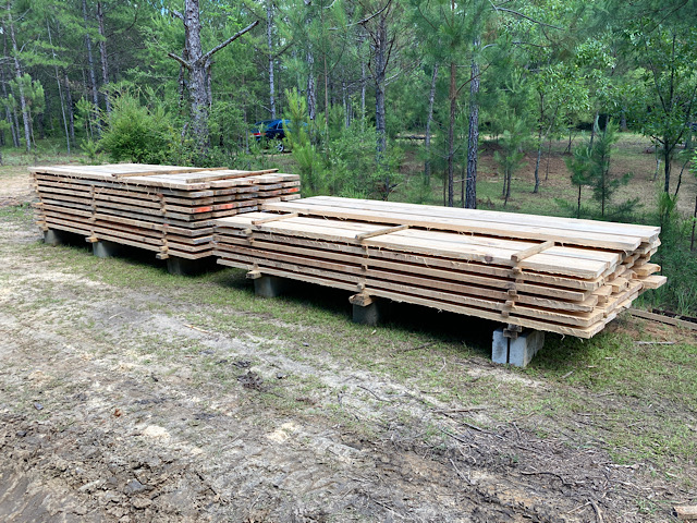

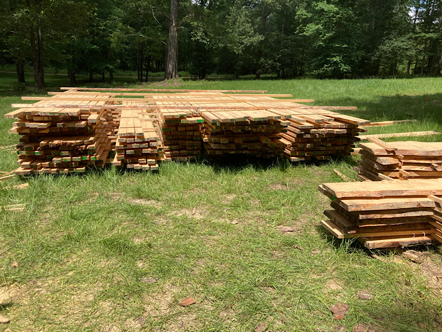

I finished sawing this framing lumber job Friday which will all be used in the customer's new 4K+ square foot home. The lumber prices have greatly increased the demand for portable sawing but I have not and will not increase my sawing rate.

Sheesh! That's a nice stack of lumber!!

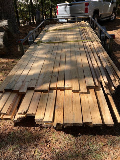

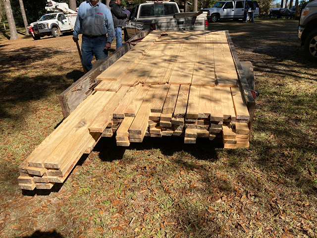

Thanks, here is what I sawed Monday and Tuesday:
Eighty three 2X10's for another customer's new home.

Nice! How long should fresh sawed lumber dry before it can be used? and I notice it’s all stacked outside and not covered so that must be ok also.
Ron
Magicman
Oct 8, 2019
6,057
9,535
Brookhaven, MS
knotholesawmill.com
I recommend covering it with metal roofing but black "visqueen" is OK as long as it doesn't droop down and cover the sides which would impede the air flow which dries the lumber. A couple of months will dry Southern Yellow Pine quite nicely.
