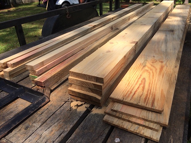

A bit of sawing for a Grandson's Senior Class Party this afternoon.
Started out with a couple of Pine logs.
This lumber will become axe throwing targets.

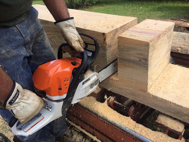

We sawed the top and both sides off of the second log and then notched down for the sawmill blade,
And then sawed it out.
And then notch down for the second sawmill cut.

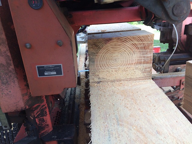

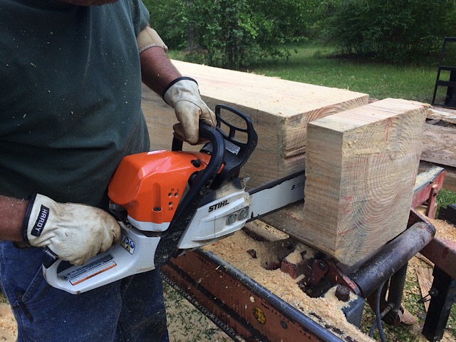

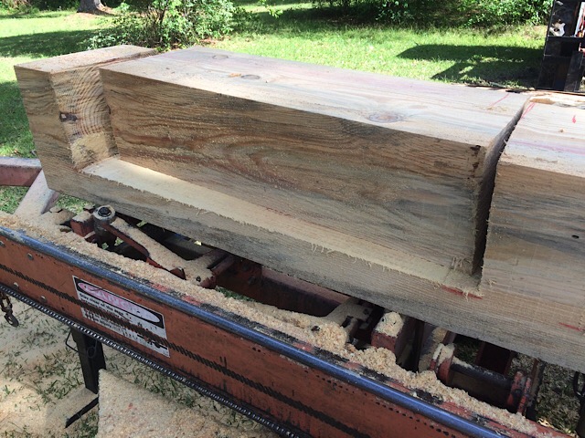

Ready to make the second cut.
The second cut is made so we can now remove that block.

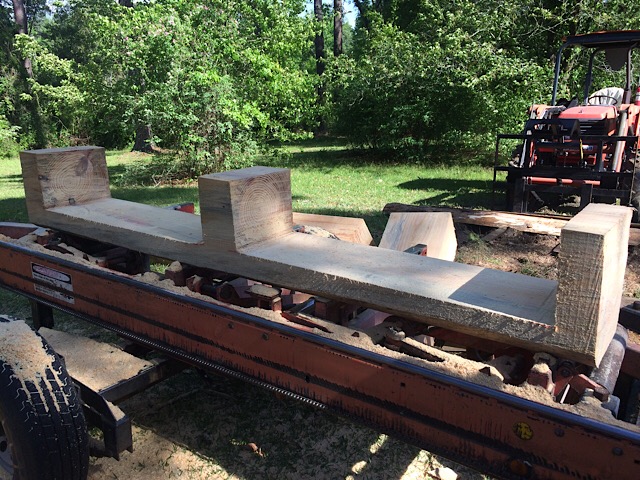

After both blocks are removed we can reattach the sides.
And use the blocks that we removed for the "legs".
The drinks will be iced down in this "log cooler".

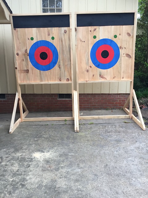

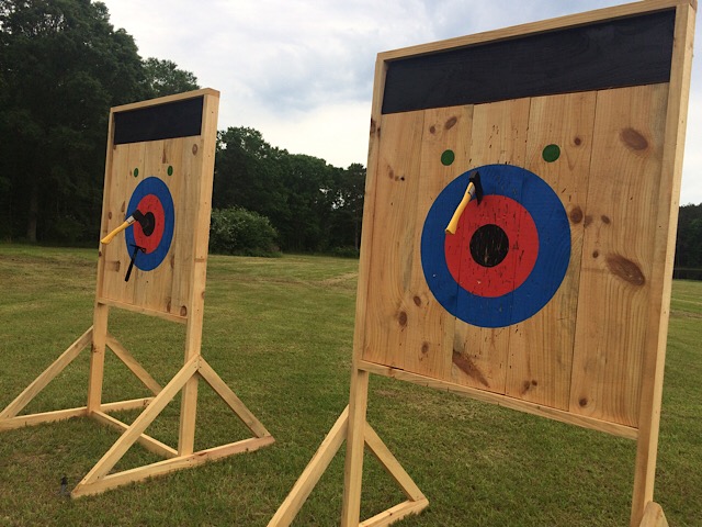

The axe throwing targets have been built and are now ready to be transported, erected, and braced.

Ya know if I was to throw an ax at those targets it would most likely go through the window behind them :)

Three scoring hits. (There is also a small hatchet in the furtherest target.)

OK there old son how did you put the log cooler together?

A total of twenty four 6" screws for the sides and four 8" screws to attach the bases. Side note as planned, after the "cooler" got wet and the wood swelled a bit, it did not leak. ;)
