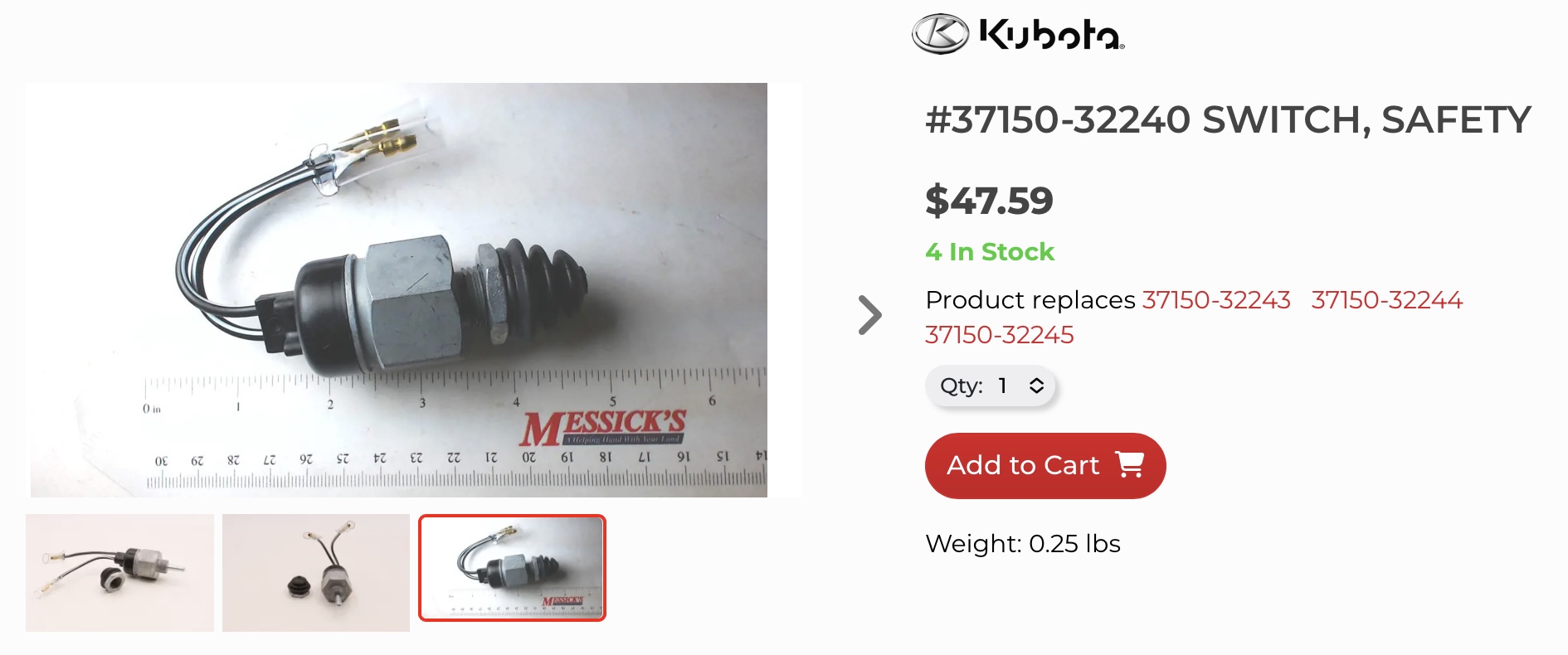

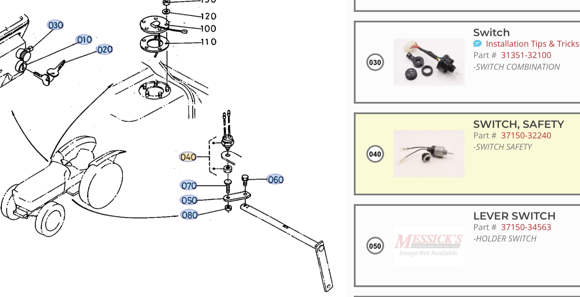

See his diagram for location, somewhere on the left side underneath the tractor. Have someone move the clutch pedal down and look for something that is moving back and then something moving upwards.
Then you are looking for something that looks like this (probably mounted vertically with plunger down, wires up)
