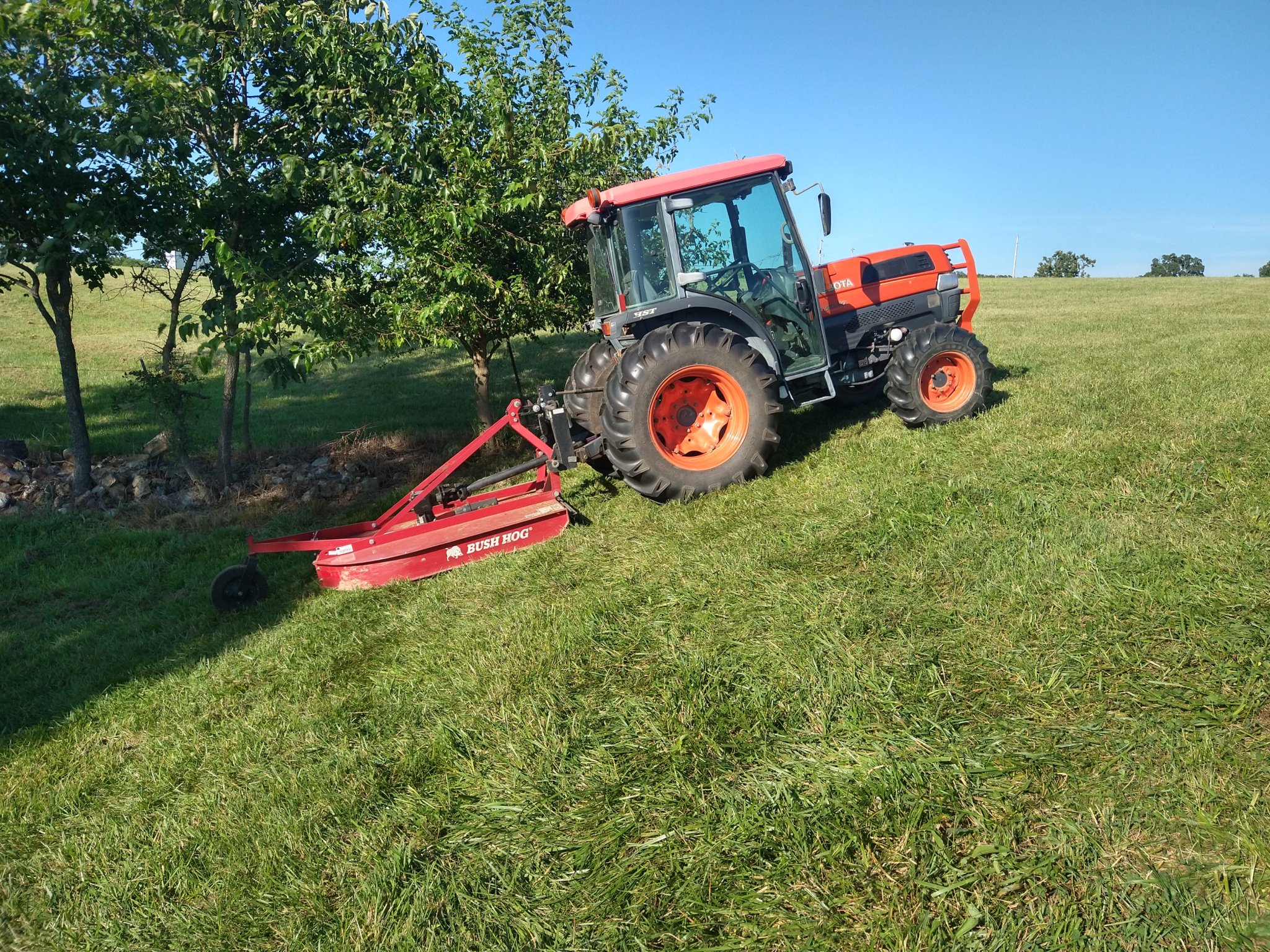

I don't know how to measure the steepness of this hill, but I have no problem going up or down, forward or reverse, or even sideways ... All in 2 wheel drive.
I do the same with my SCUT.

Maybe I'm just a "chicken sh1t", but going sideways on that hill looks terrifying to me......
I get a little "puckered" just running over a piece of firewood though....hahahhah:ROFLMAO:

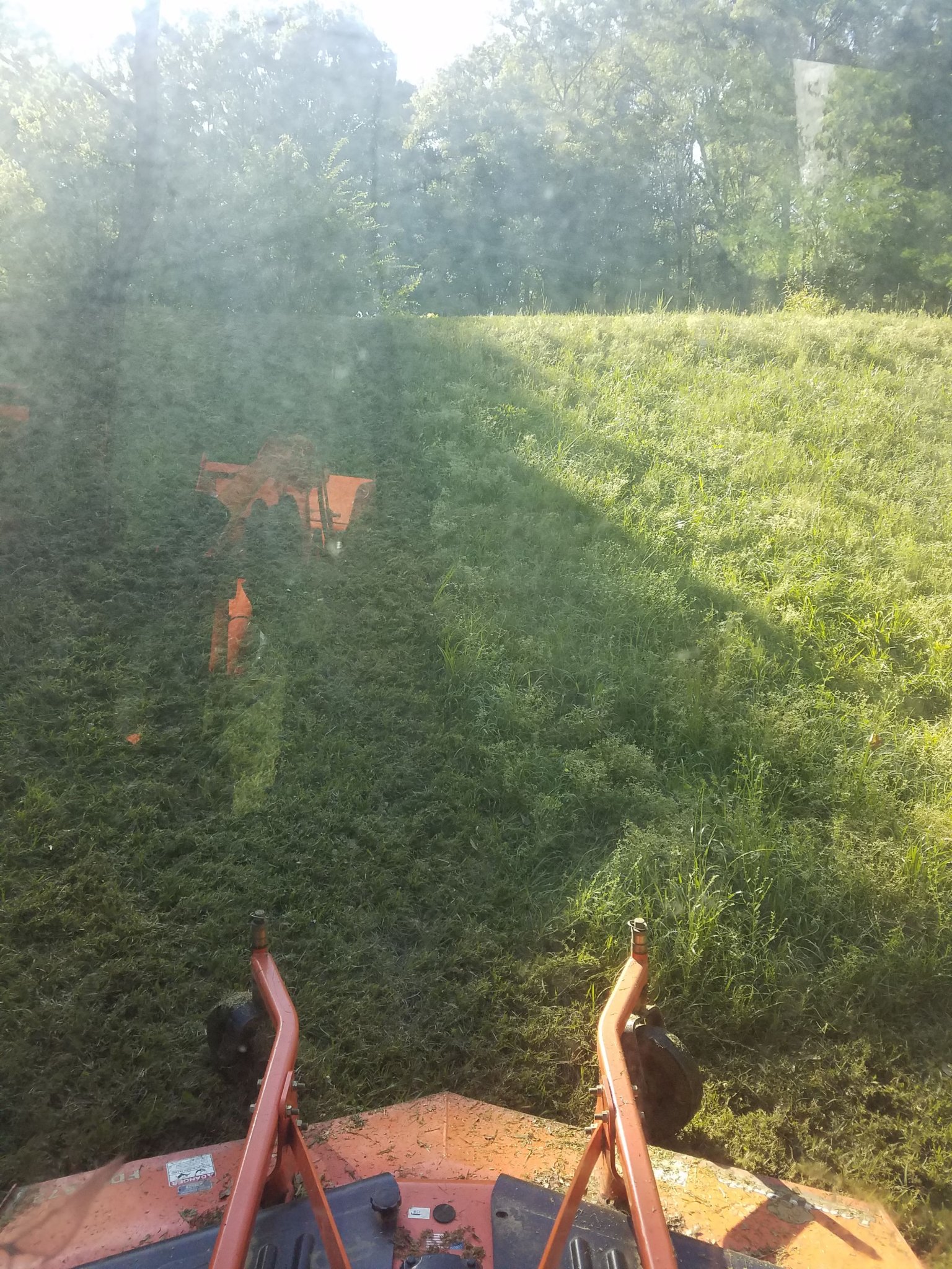

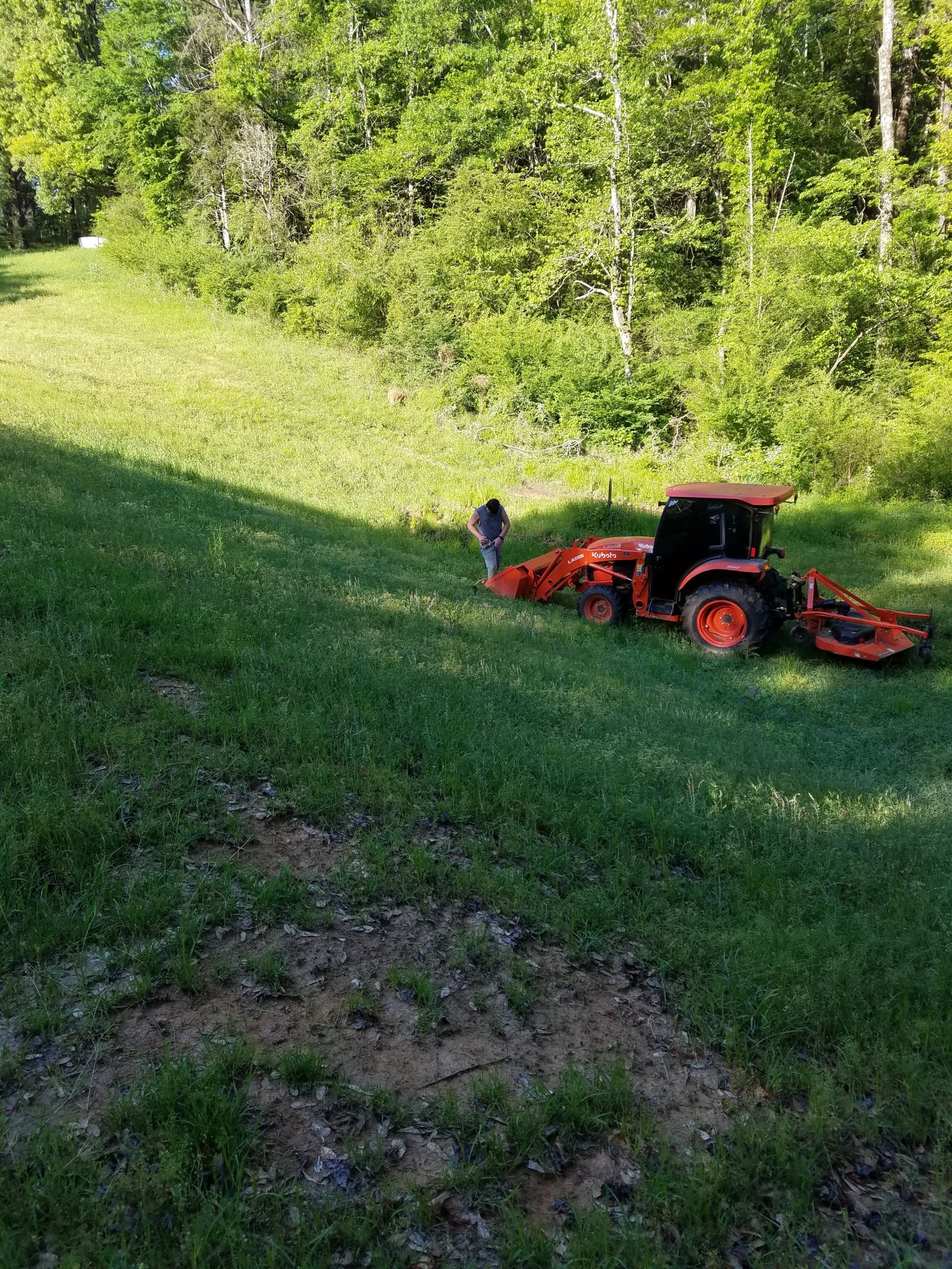

Definitely up and down for me. Our pond dam is steeper than I really care to fool with but its gotta get cut. 4wd engaged, trans in low, loader down low....never sideways

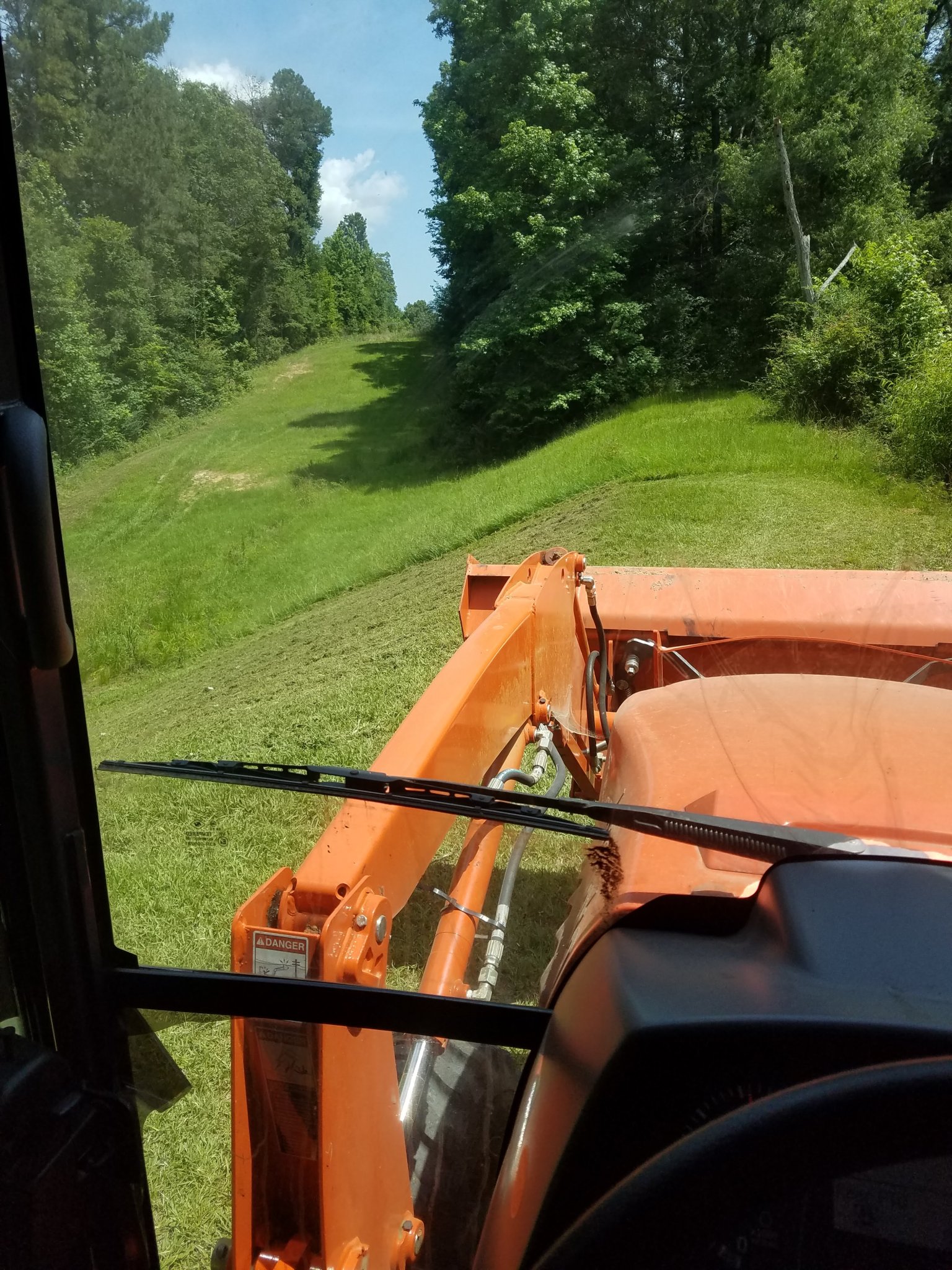

It took a long time for me to get comfortable navigating around this area on our property. This tractor as well as my 3301 had no issues climbing the dam.
I did learn a couple years ago to stay out of there early morning when the dew is still down. Slid her sideways about the last three feet or so of the damn. Realized how bad it could've actually been had I been up at the top.
I usually make circular passes and end up climbing down. In low while cutting, the tractor just barely walks itself down the dam. Nice and slow so i can comprehend everything thats going on.
My pond does run off at the bottom of all this when the gully washers come.

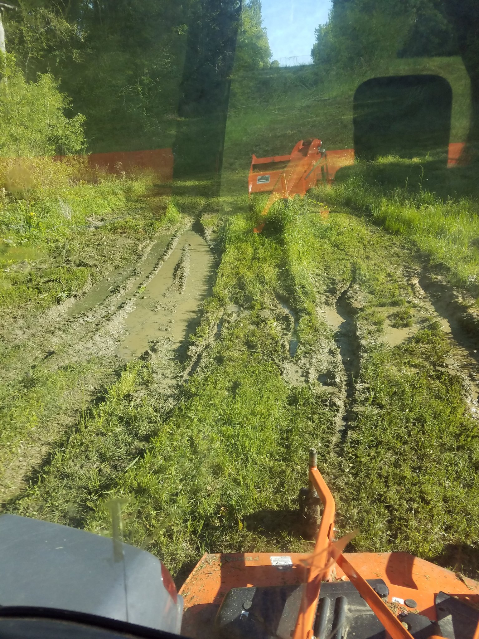

So sometimes as I get towards the middle of the dam, I'll have to reverse up it, then cut coming back down.
