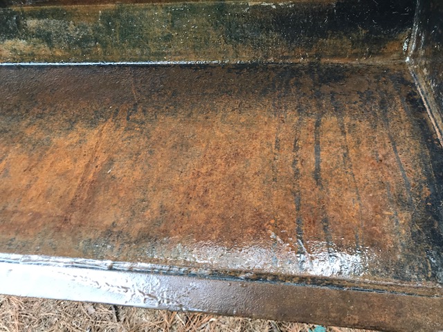

I keep my tractor 4 counties over and dont get out there much. I brought her in to do some maintenance since its pretty primitive out a the "farm". I do keep it under a lean-to, but...some sideways rain musta blew in and I left the bucket level with a chain in it no less. Needless to say, its rusted and flaked up pretty good and started corroding on the inside 8 inches or so on the bottom and top of the inside of the bucket bend.. Today, I hit it with wire brush, sand paper, and used a scraper and got all of the loose flakes up. What approach should I take before painting it? Does it need to be primed? I have a can of POR 15 I bought to use on my truck frame and might use it. I guess its ok at this point to spray it down with water to get all the rust dust out of it and then hit it with a leaf blower or compressed air to dry it out to get it good and clean to increase chances of paint sticking good. Interested in hearing from anyone that has done this. This pic is the after. It looked way worse before I started in on it.
